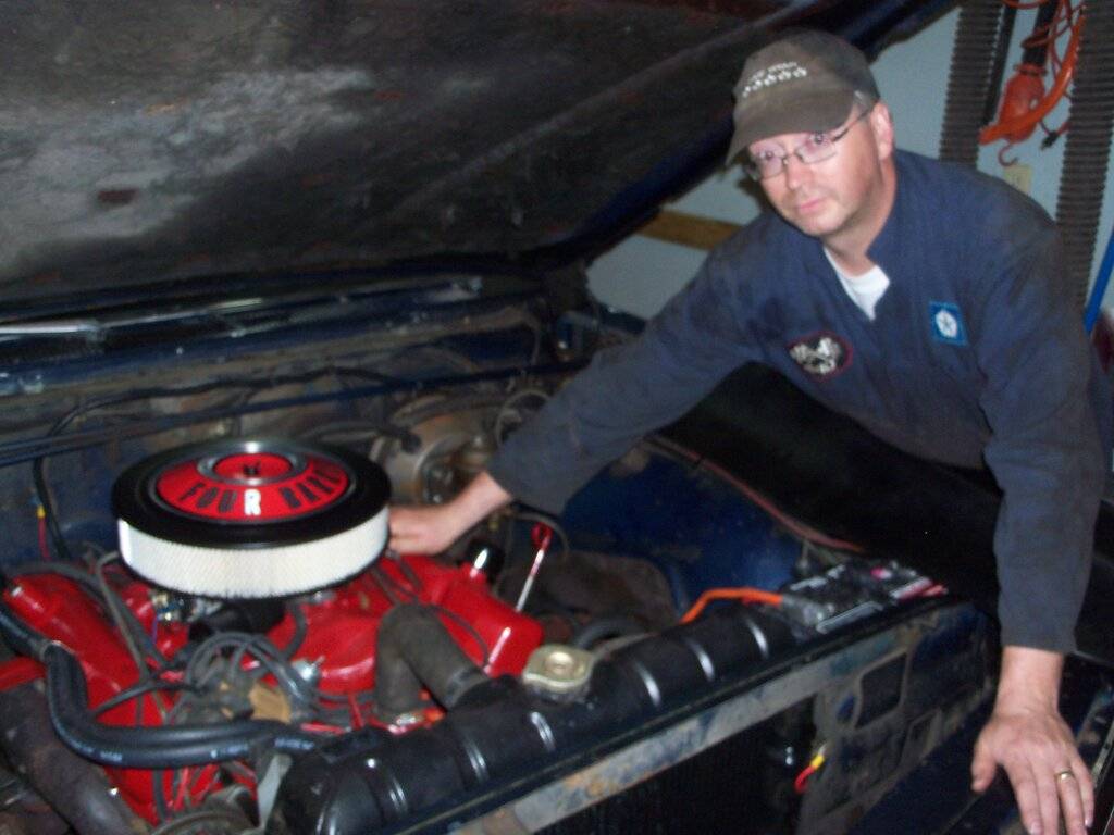

VERY NICE engine compartment BTW! The 452 is rather like a latter day (mid-late 70s)906 isn't it? (I have those too.) IFF I NEED to QUICKLY burnish some heads and bolt them on, I'll use the 452s. I like the way my older 383 behaves though, even with the 516 heads, which is why I shopped for the 915s.

Yes tbe 452 have same size valves as 906.
