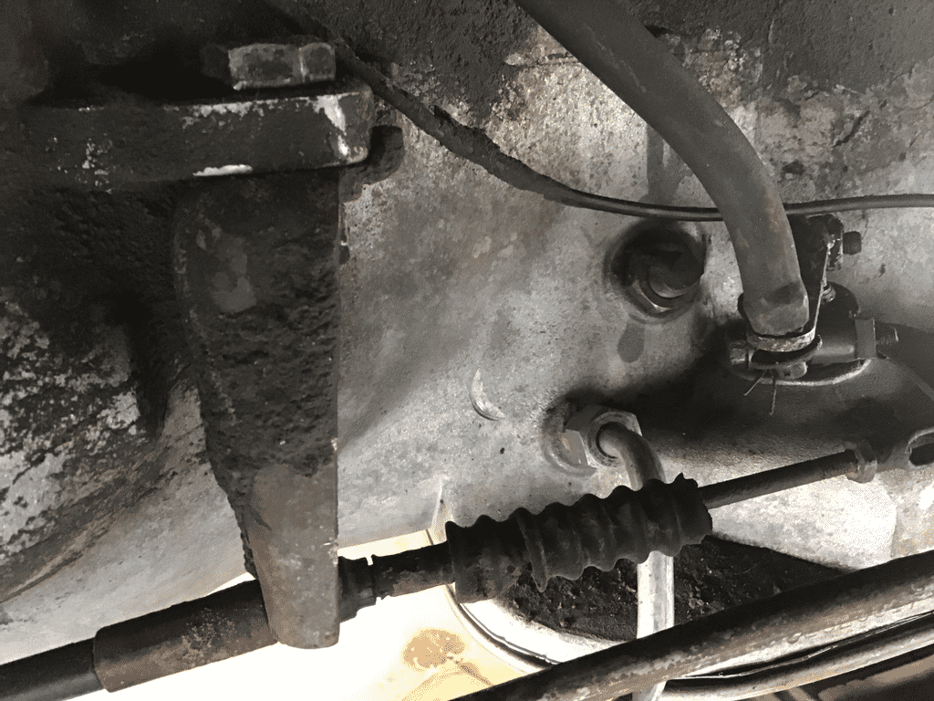

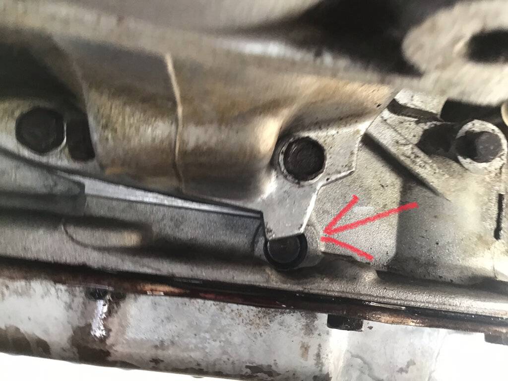

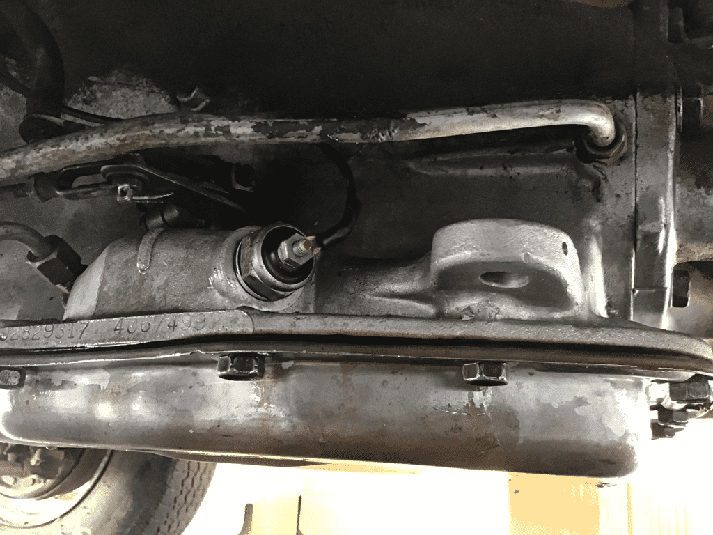

Here are photos of the leak points. This is in a van so easy to photo this. I Cleaned it up real good so I can see where the leak is. You can’t tell what is leaking when it’s all greasy and dirty. I used Castrol super clean at the car wash. This one has a bad shift seal.
First photo shows the shift linkage, there is a seal in the case. Then you can see the 2nd gear band adjuster nut and shaft and the front cooling line.
Just because your neutral safety switch is old does not mean it is leaking. They have a nice seal ring that seldom fails. Just keep the dirt out when replacing it.
The red arrow is pointing to the low band shaft, it has an o ring on it. If it leaks clean it good and cover the end with “the right stuff”

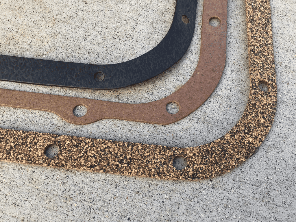

3 pan gaskets, I like the cork rubber combo the best. The brown one is fine also . The black rubber one is a mot very good IMO. I don’t use them, seems too hard to compress and seal anything. This applies to valve cover gaskets also.
Thx for the nice comparative display of gasket types. I went through all of those either on my old Disgustang years ago, or Mathilda the first year I drove her. Again, I commend you for this arrangement on our behalves.

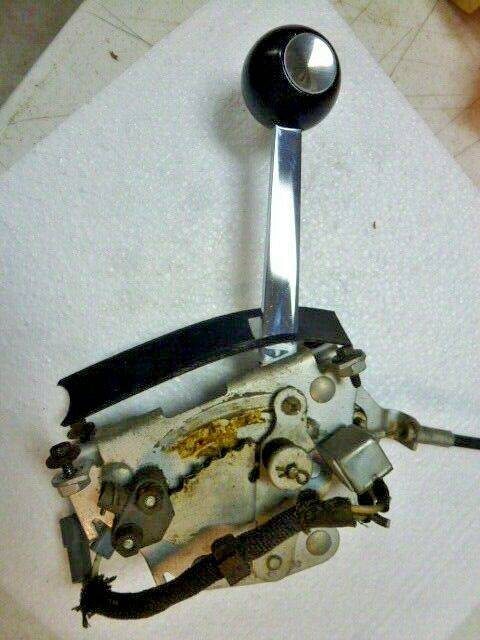

Do you think the cable linked 1965 (and earlier, but especially the 1965 ones) can readily be adapted to use a B & M floor shifter or such? It occurs to me that such a scheme for the right C body may work toward creating a pickup truck based on the car body similar to the Ranchero or even the ultra RARE Imperial "flower-getter" once posted to this very Forum. NOT a show room project mind you, but as a practical work vehicle, such appeals to me.
What LAUDABLE HUMILITY you've demonstrated here Big John !!! You rate a Golden Pentastar for the Day for this one Sir.
I've had a couple B&M shifters in cars and I'm not real sure if the amount of travel at the shifter is the same as what is needed at the valve body. The cable floor shifter in my Barracuda works similar to the B&M shifter, so I would look for one of those if it were me. The console is small enough to fit just about anything.
