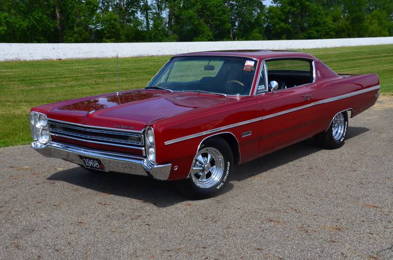

I had mine stripped and polished at a local shop and it looks just like chrome and was a lot cheaper I can send you some pictures if you want them
Thanks for the pic. Looks great! The added weight isn't a big concern but how the pieces fit after with the added metal might be a problem.
I had no distortion of the shape of the pieces after chroming and the fit was identical to the original fit.
