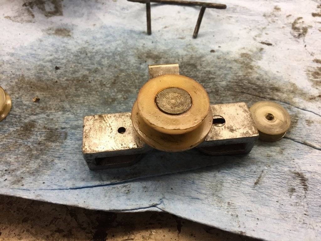

Having taken my windows apart in an effort to make them smooth operation again I wonder if anyone has tried alternative rollers to restore and possibly improve the operation of the windows
I have been following a few threads recently in hopes to learn more about the replacement parts needed
I consider myself fortunate that no rollers are broken like in recent threads
I would like to replace as a PM so I don’t have to go back into the beast a few years later from now
My 66 Polara 1/4 windows are very different from the thread posted by Matt62 for his 65 Monaco ...
I’ll post more pics soon
This is something I need to deal with on my 1/4 especially. I lost motor operation on one last fall. If I was going to tear into it I wanted to make sure I could improve upon any aspect of the motion.
I have always needed to assist the movement on the 1/4 windows. I thought I would make molds of my current rollers and replace them with something that is not 50 years old and brittle.

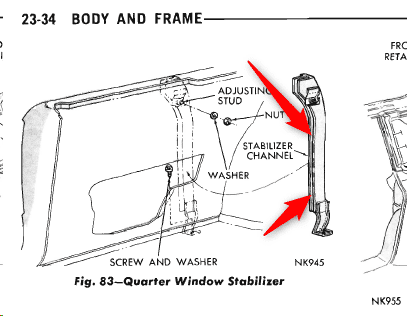

Is flocking material supposed to be in the rear 1/4 window track stabilizer?

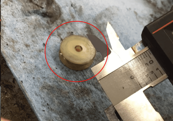

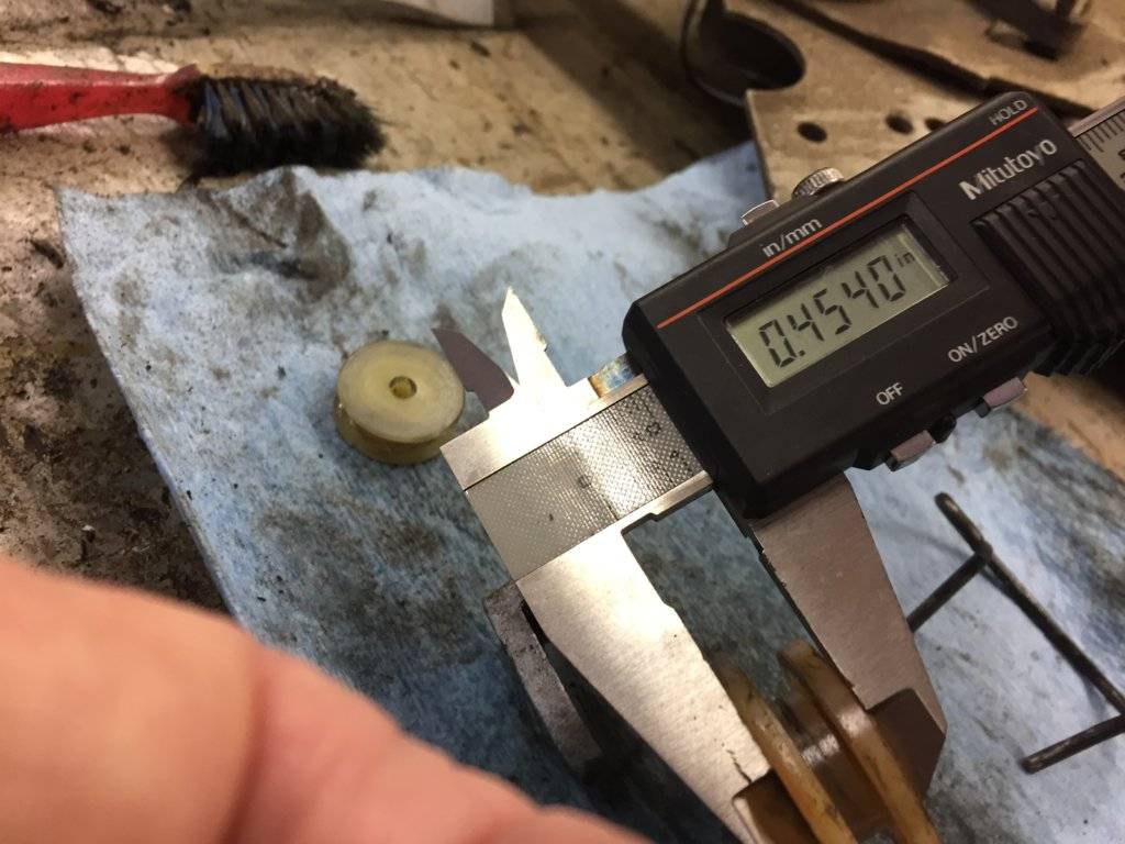

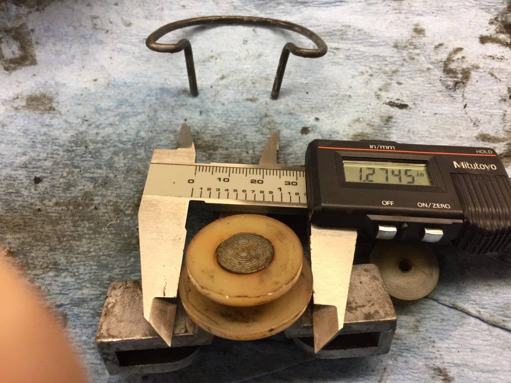

Here’s the dimensions
I’m looking for the roller, not the bracket that houses them
If someone is already repopping them for other body styles and sizes, I'd be thinking that the roller itself is the same throughout and just the bracketry and such is where the difference is. If so, it might be worthwhile seeing who sells the repro guy the rollers...
