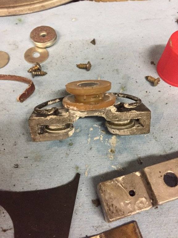

Most of mine are good other than one broken one and a few that are egg shaped in the center hole.

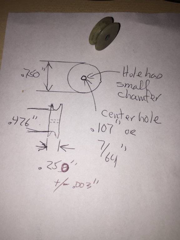

Here’s the dimensions
View attachment 272827 I’m looking for the roller, not the bracket that houses them

According to a few sources these rollers were not meant to be a serviceable item but when there’s a need we will overcome the challenges
Another thing I have discovered is that I have freed up the rollers and then have them spinning freely but under load of the channel guide they don roll so I have tweaked the channels enough so that there is no slop but will spin as I move the roller assembly from bottom to top
It’s still hit and miss though which makes me wonder if these are important other than taking up the clearance
could the egg shaped ones be drilled and bushings installed?
Yes I am doing that as a contingency plan.
I had some brass tubing from my old model airplane building days
just have to be careful not to drill out off center otherwise it will spin like a clown tire.
If you have accurate dimensions, search out some solid round bar stock in some kind of nylon or other durable plastic and turn them out on a lathe.
I'll bet it will be way cheaper than brass and less apt to wear out the tracks they run in.

I've contacted & sent a rudimentary drawing to PA Plastics and waiting for a quote.
Well the quote from PA Plastics is not in the ball park being quoted at $30 each for 10 or $15 each for 20. Both end up at a price tag of $300+13% Taxes
3-4 week delivery.
They planned to sub the job out to a small machine shop so I too went to small local machine shop & have left the drawings with a 1 week turn around.
The plan is to test with T6000 series aluminum & go from there.
