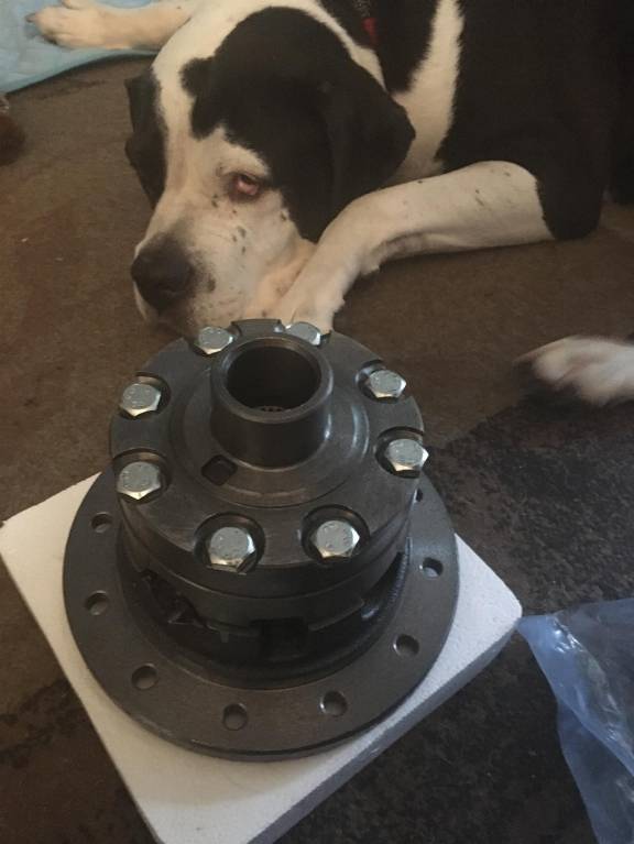

First impressions are good. The machine work looks good to me and I have a critical eye for that. Very slight burr, probably only .002" or so on the chamfer on the mounting face for the ring gear. I'm probably one of a few folks that would notice that... and it will take less than a minute to take care of...
The dog likes to photobomb my pics.

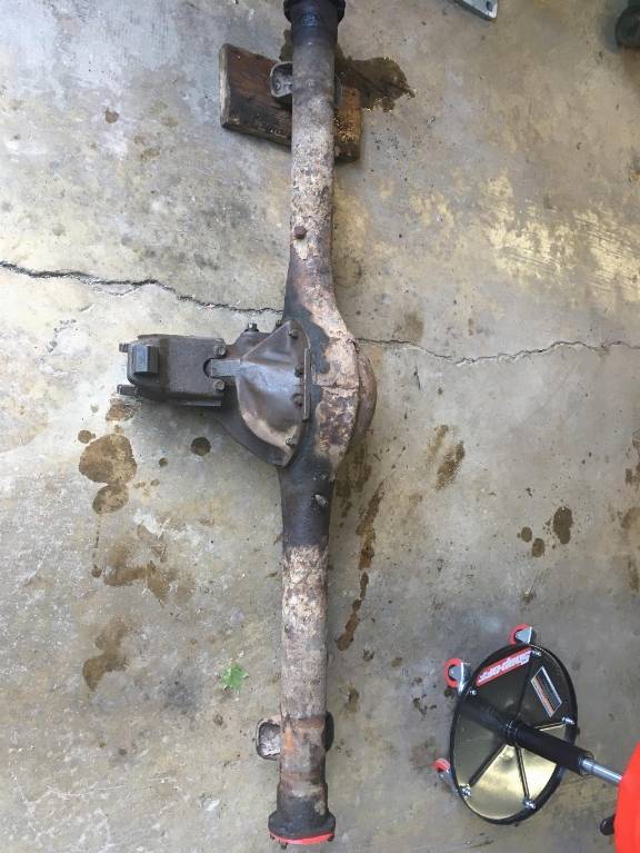

The rest of the rear axle bearing job has snowballed... I decided I didn't like the brake hardware and one shoe was cracked, so I've been pulling everything apart, sandblasting the backing plates etc.. I think the easiest way for me to do this is pull the whole rear end rather than trying to muscle the center section in and out on the lift. I can just drop it and pull it out from the rear... Of course, that means cleaning the housing up and doing some paintwork...

i bought one of these units it checked out fine ,, no burrs to speak of ,, gears all looked good ,,, only issue was the preload on the clutch plates which was 90-100 lbs/ft rotating i upped that to 160 lbs/ft which is in the range i like ,, usually try to get them at 150-200 lbs/ft rotating ,, last thing i checked was the runout on the mounting face which was 0.0015 ,, new 3.91 gear was installed and assembly was finished.

This started as an axle bearing replacement and then got complicated when I decided to install the sure grip. I decided to pull the entire rear and clean it up and add some paint. The rear had been swapped some year ago for one sourced from a rusty car. On the underside of my rust free 300L, this stuck out like a sore thumb, so I went to work.
Started by hitting it with a needle scaler to get the big chunks off, followed it up with a coating of Ospho to treat the rust, then went over it with a flap sander in my angle grinder.

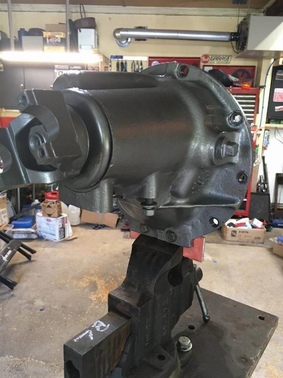

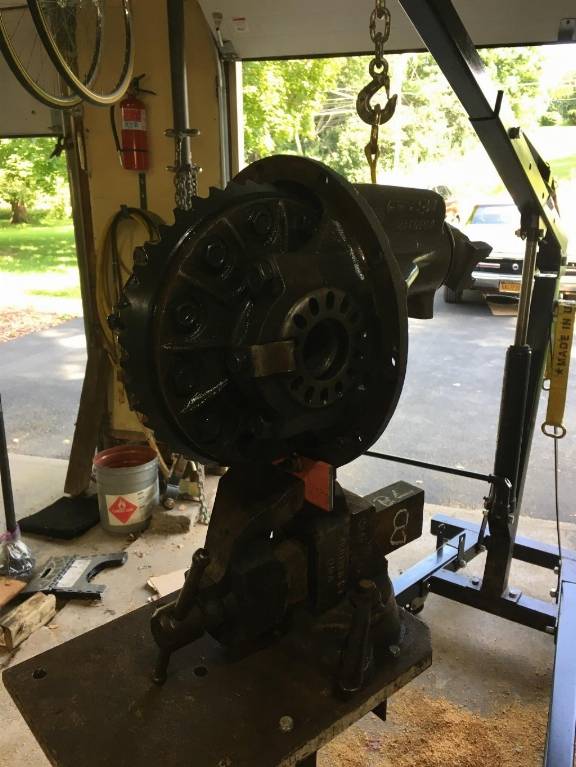

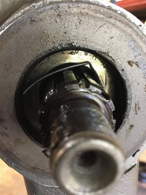

The center section needed some love too... The pinion seal was leaking (for obvious reasons) and I thought the bearing preload was on the loose side. A tip from a mechanic buddy suggested that my bearing noise could be pinion bearings and that lead me to change them too while it was apart.
New tabs from Dynamic Renovation - Home were welded on along with a new brake line set from Inline Tube. Backing plates were sand blasted and painted.
