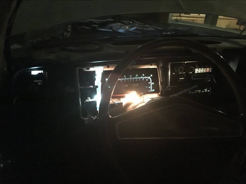

Lights fixed! Thanks everybody.

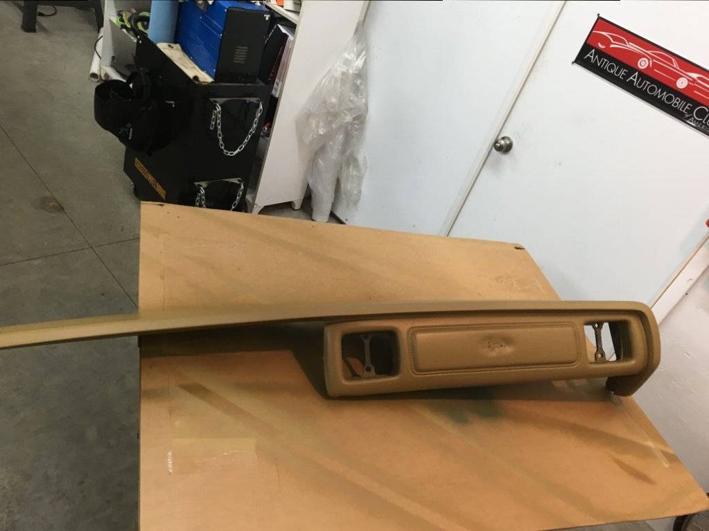

Dash is painted. My needle paint should show up tomorrow and I will be reassembling the dash.
What color paint did you use on your dash pad? I have a 77 newport with the same color and not sure which color to get.
Thanks. Looks great btw.
