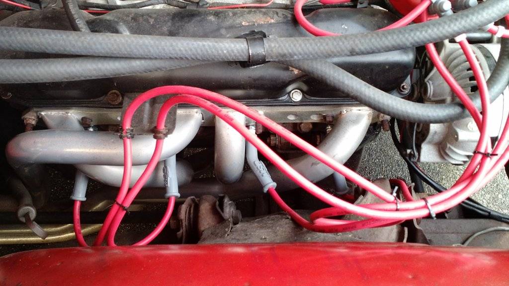

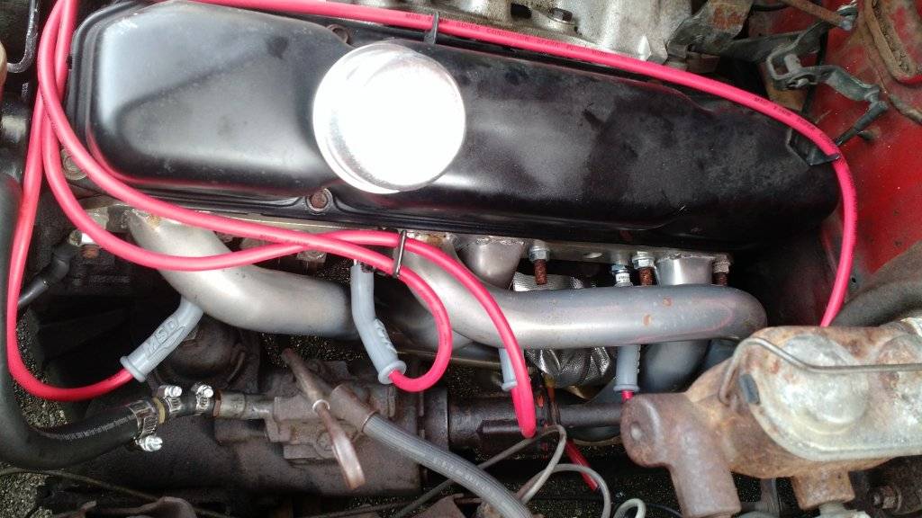

I would need to see some photos but different angled boots may help the issue.
Some headers have problems there some don't. Heat with torch, lay a big socket on the tube, and hammer. You'll get a decent dimple shaped as you need.
Simple work for all the benefits headers bring.
Howdy, take a look at MSD #32739, these leads are awesome. I had the exact same problem with boot sleeves burning away and that lovely "arcing". My Fury came with MSD ignition and ceramic coated headers. These boots are positional, I bent them all away from the header tubes and no issues since July last year. One downside, these leads are at least a foot longer than you need...

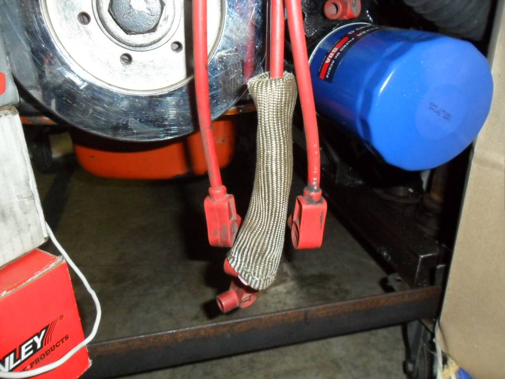

I've been running headers since the mid-70s and have run many brands. They all seem to have one to a few close tubes. I have been using the heat proof sleeves on the close tubes for a number of years with good results. There are a number of manufactures that you can buy from Summit or another performance supplier. Buy quality sleeves, they seem expensive, but they work.
I use the heat sleeves Outsider shows in post #9 with straight boots on every plug. Never burned a wire with Hedman Headers.
Spot on your pipes look very similar to ones on my 400, I'll have to get some MSD leads, i have just got the heat proof sox now, hopefully i can run a bit longer before the arcing returns.
