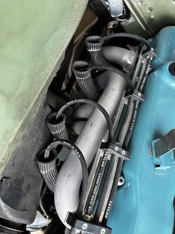

The heat proof sleeves that Outsider mentioned work great. I put TTI headers on about 3 yrs ago and the wires route over and around the headers which is a disaster waiting to happen. I haven’t burned through any wires in 3 yrs with the sleeves installed.

Same problem. Here’s how I solved it on my car.
