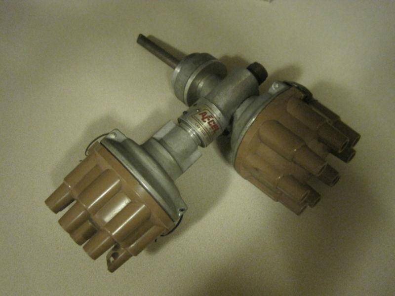

I had always imagined dual points would get more dwell time by only having each set of points be responsible for firing 4 cylinders each so double the dwell. It would work even better I thought if there were 2 coils too on for each set of points. But I hear that is not the case. I have never seen a dual point distributor so I guess I will have to look into this.
Dual points were there, in the first place, to extend the dwell time for a hotter spark. More time for the coil to "make volts" before the plug fires. Can't do the same thing just by changing the point gap outside of the gap specs, so one point set opened things and the second set closed things.
They open and close a few degrees apart. One set opens, the other maintains the circuit for a few more degrees of dwell time then it opens to collapse the field. The first set immediately closes to start the dwell time on the next cylinder. Basically it would be like a very sharp pointed cam lobe the points would be unable to follow.

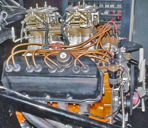

All the original hemi engines in the fifties had dual point setups. I thought I read somewhere it was to have the plug fire for a longer period time to make sure all the fuel mixture was burned for better efficiency and power.
Just like some race engines had dual distributors and dual plugs.
