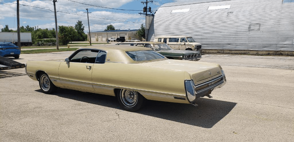

Replaced both blown mufflers and the “hot rod” tips that came with the car. I think the turndowns look much better.
I was surprised when my mechanic said the cost of the mufflers actually went down. Good to know not everyone is using Covid as an excuse.
If I may suggest. Give your tips a slight cut to give an oval exit.

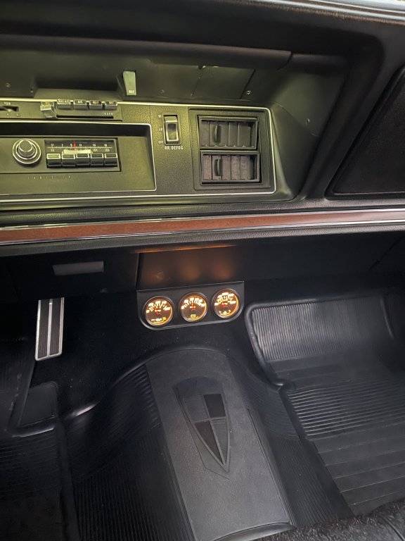

Just in time for summer. DRK SD 73 has an all new AC system that blows a cool 44 degrees.
