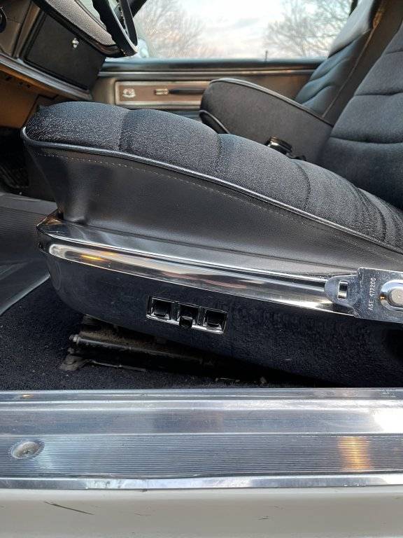

I broke the up & back seat switch last summer. Luckily, I broke it while the seat was adjusted for me. Bought a nice replacement from Murray Park.

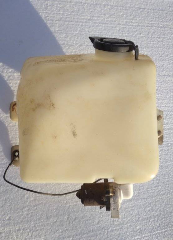

Finally found a replacement windshield bottle, complete with working pump, thank you JP!

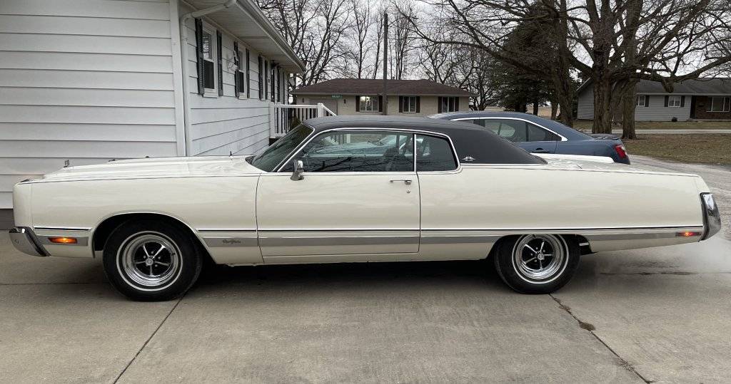

I saw @SGVert’s Magnum 500 wheels at the 2022 CATL Drive and knew I had to get a set.

Those wheels work surprisingly well with many cars, and yours is no exception -- well done!

Car looks great with the Magnums! The pinstripe really accents the lower moldings as well. Makes it look even longer than it is!

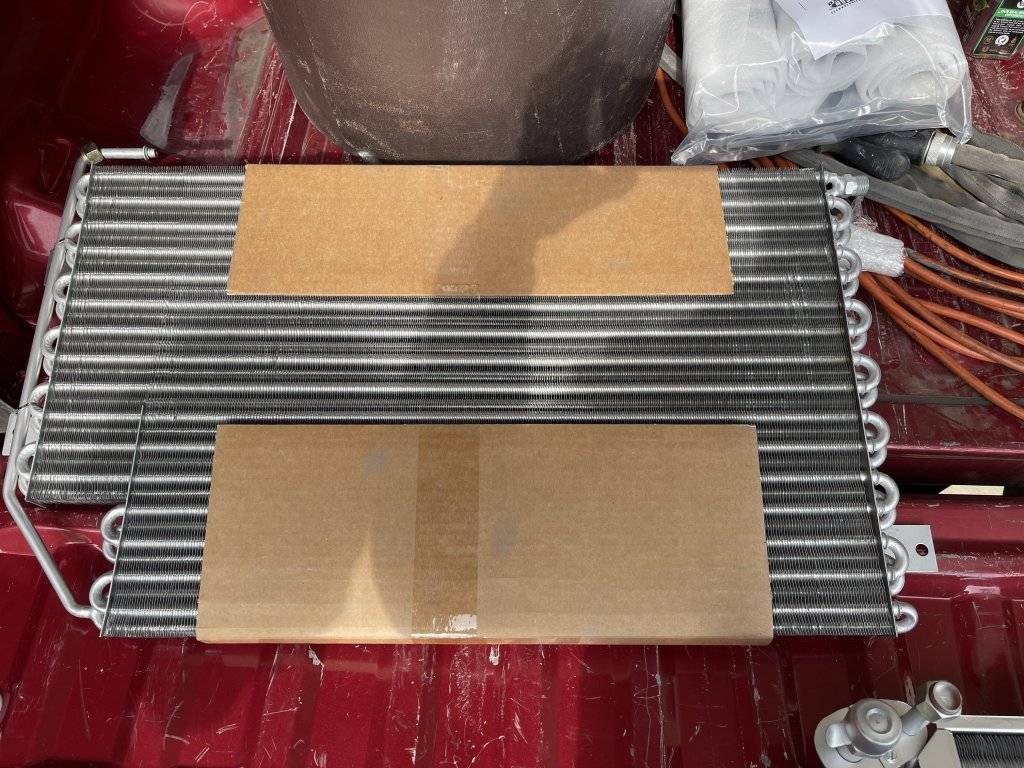

I am going to continue using this thread to talk about the updates to DRK SD 73. Today I dropped the car off at the @david hill spa.
The list of projects include -

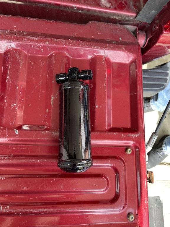

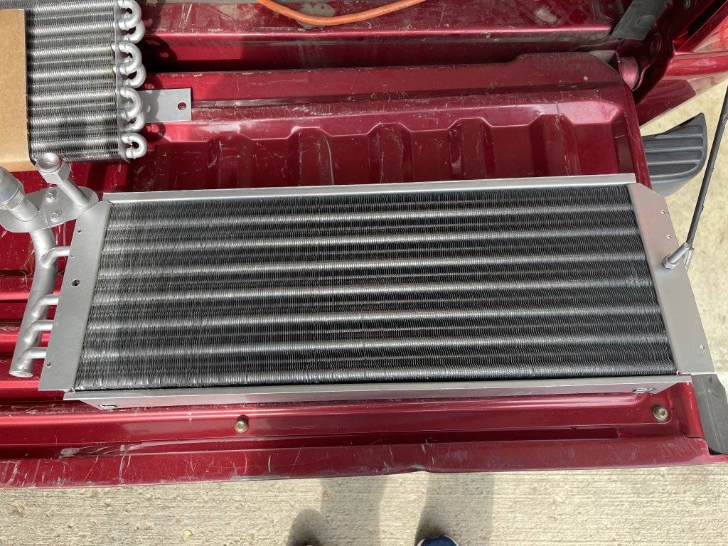

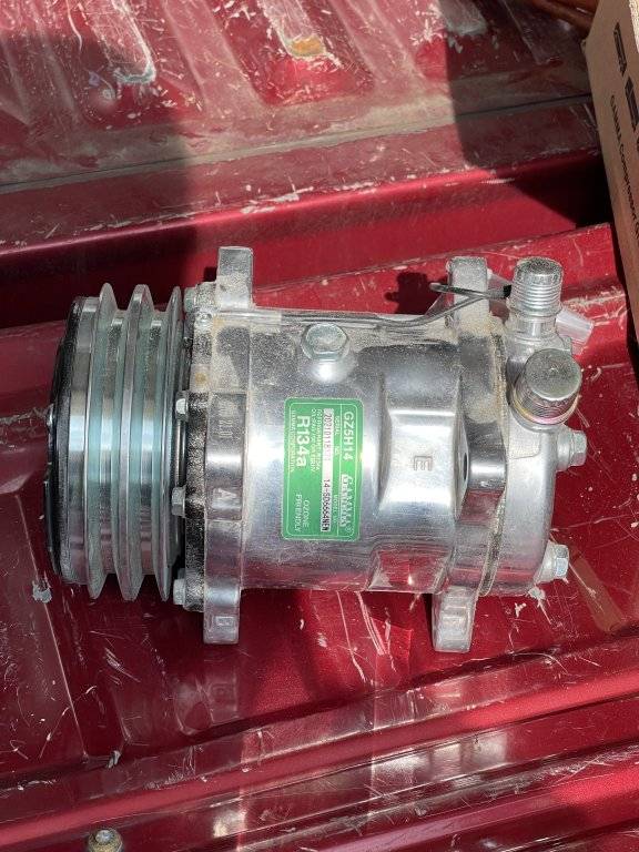

1 Rebuilding heater box/gaskets/new heater core
2 Air conditioning/drier
/compressor/evaporator/hoses/
fittings
3 Align doors/glass/install bottom seals

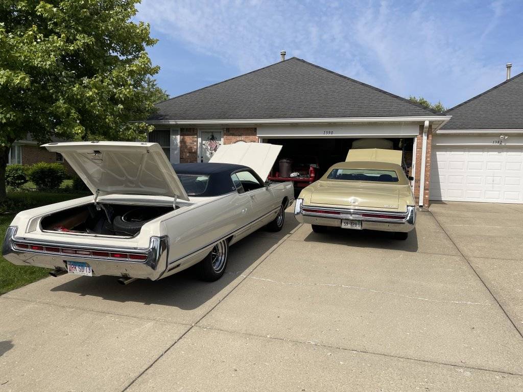

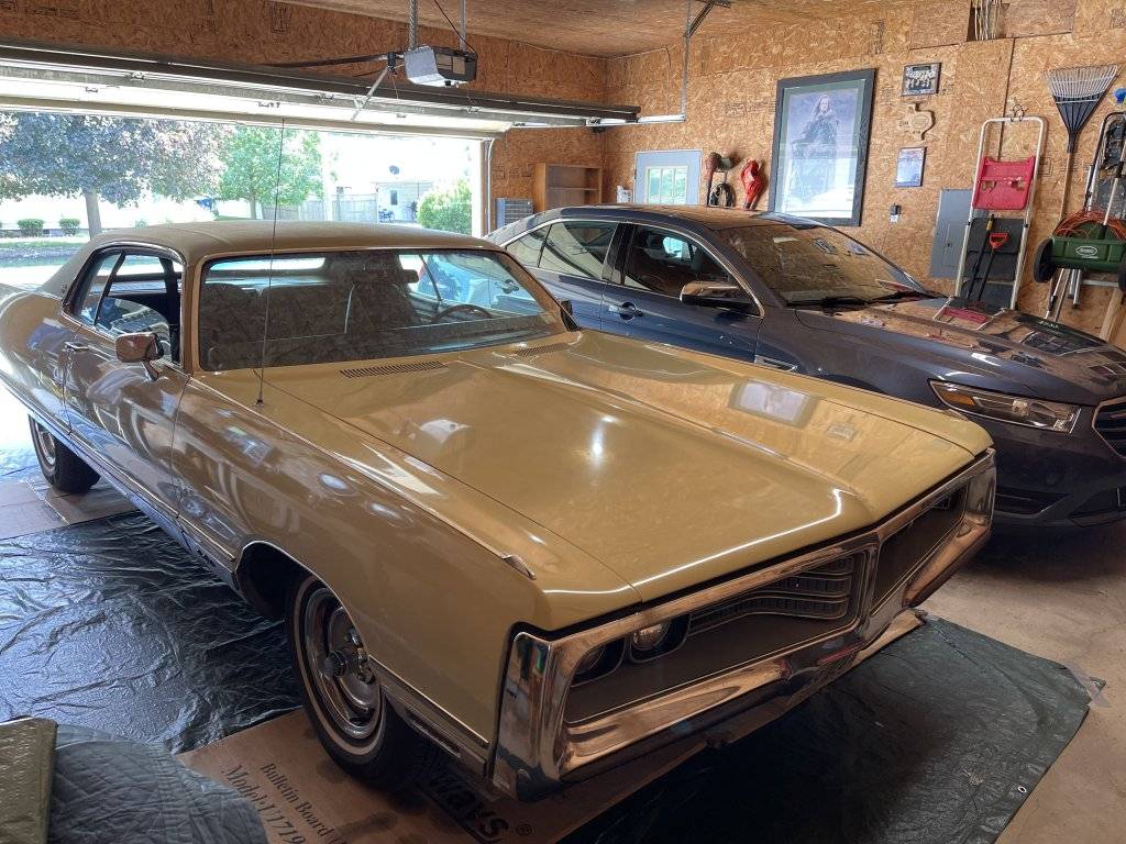

And as an added bonus to the day’s events thanks to an extremely generous offer by ayilar “buttercup” will be spending a little time at my place
Very cool on both counts. How is the drive between the two New Yorkers?
I'll start by saying I think there has been comparable work done on the front suspension of both cars. However one significant difference is buttercups work went all the way back to the bushings, DRK SD did not (rookie mistake). The noticeable difference in the ride was almost immediate.
You can feel a bump on the road in buttercup but after that it's smooth again. DRK SD tends to shutter a bit after the initial bump (bad bushings = metal on metal?). Also buttercup has a new @david hill custom sway bar, DRK SD's is shot.
I could tell my after market intake and carb gave me a little edge in acceleration but buttercup's acceleration is smooth and steady (credit @david hill again for that).
I think there was a slight difference in the seat height/padding of the front seat - buttercups seat was firmer and it's armrest seems to sit slightly lower and flatter, which I prefer.
Also buttercup has Hankook tires, DRK SD has Nexen. I would very interested to hear from anyone who has run both of those tires and which one you prefer.
Just my opinion but 69-72 were the best looking New Yorkers, it's all about that front end (says the guy who owns a 73).
If I discover anything else I will post here.
Great comparison. Not often you get to jump into another C-body of close age for a side by side.
That was exactly the idea here: offer @73 New Yorker a chance for a direct comparison with a car he'd be familiar driving. Our cars are old and few of them remain, so having a chance to drive two of them back-to-back (as happened today) is very rare.
I have seen how @73 New Yorker treats his NYB, he and I caravanned together for several hundred miles at last year's CATL, and so it was easy to trust him with Buttercup.

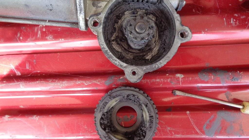

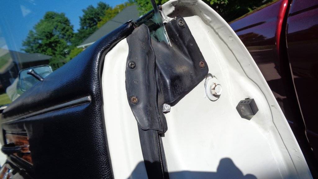

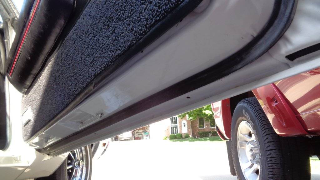

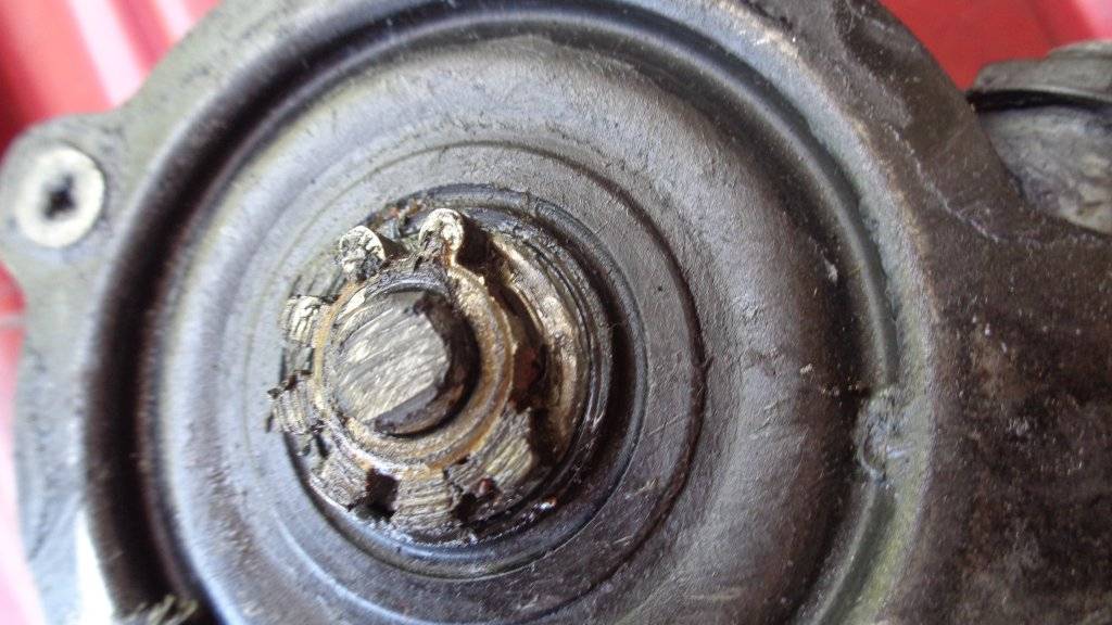

Here is the first update on the 1973 Chrysler New Yorker. Power window oper. on both drivers and passenger door was first on the list. As seen below the pucks inside he paas. window mtr. had turned to mush. The drivers door was more interesting as it revealed one broken tooth on the window mtr. Will be Wed. or Thurs. before I get a replacement gear from Dorman. After reassembly the pass. window oper. is silky smooth.

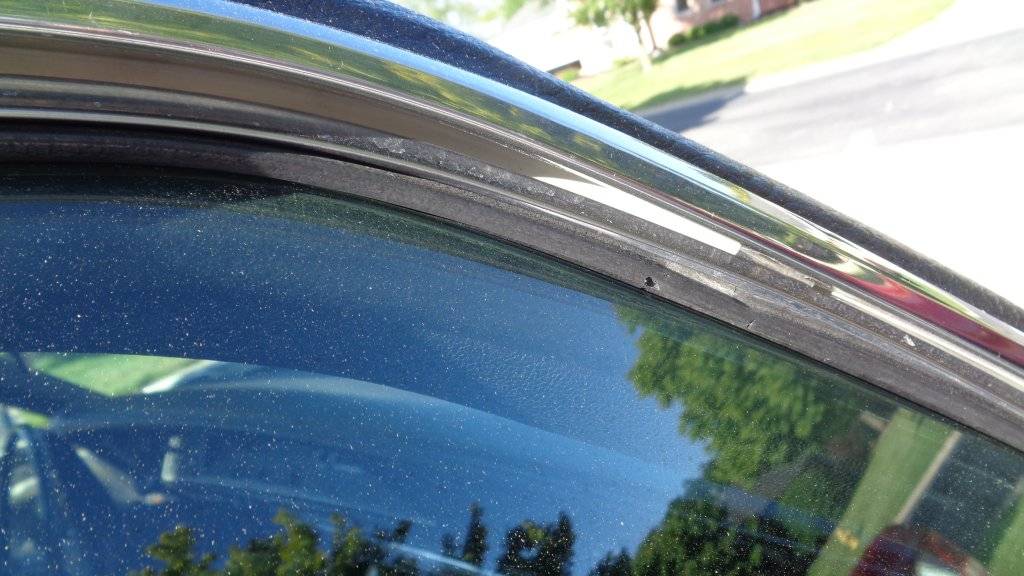

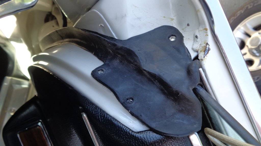

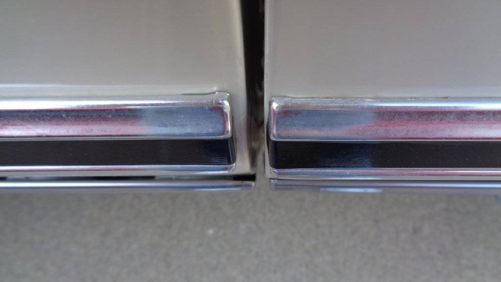

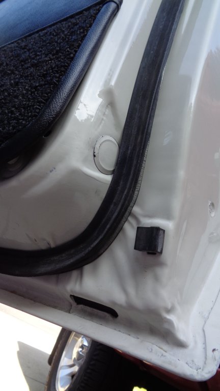

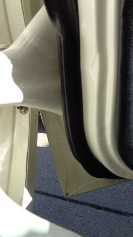

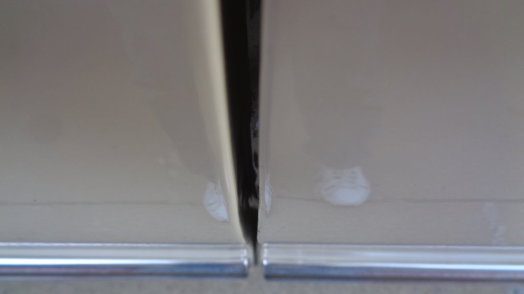

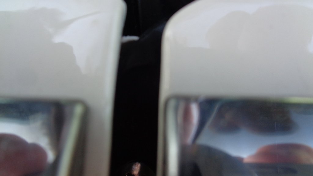

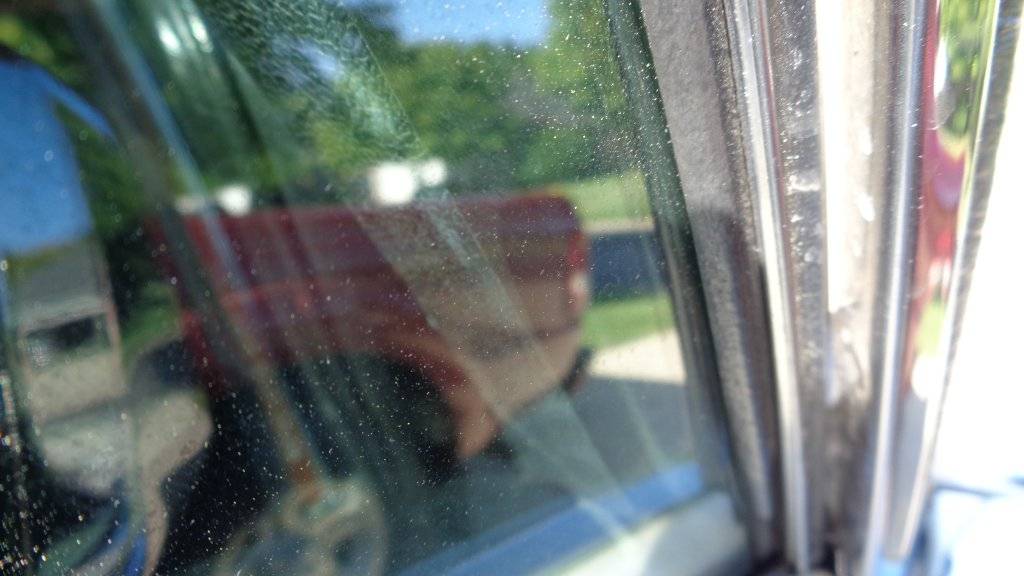

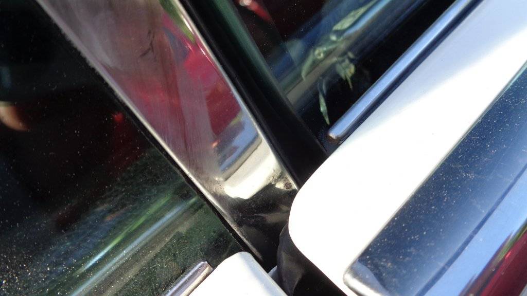

Now moving on to both door window adjustments Upon furtherer inspection some door adjustments were necessary to get the proper base line for window adjustments. See photos. Once done realignment of the door glass was done the photos show near perfect alignment.
Last to be installed were the door seals. Randy had acquired a very good used pair. With fresh plastic clips the install was flawless. See photos
