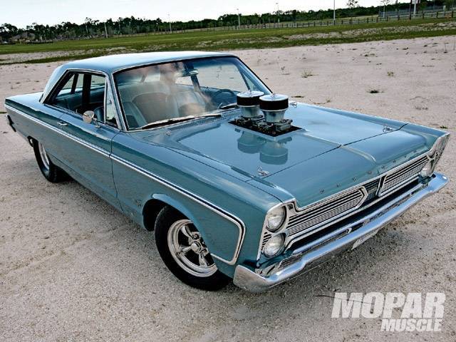

HELP Need Opinions on my Fury Build
For the car's sake I would suggst if you build the engine with the setup you already are committed too run it without a hood. Then when you hate it you will still have a nice hood when you take all that stuff off.
I hear you on that for sure, not cutting her up til I'm somewhat happy with what I got. However worse case I guess I could always bolt a scoop on, but I don't really want to do that. Haha
I'm a bit confused. Are you looking for advice or validation? If you already bought the combo, then there's not much to be gained by asking for opinions. Put it together, get it in the car and drive it.
Other than the hole in the hood for a tunnel ram, the big issue I see is with the cam. That much duration is going to give away a lot of torque on the bottom end.
I also believe you'll be unhappy with the combination in the long run, but it will probably be pretty fun to have it rumble and make noise on the street. There's nothing wrong with a little posing every now and then.
You might consider some limited changes with an eye toward the next version. A single four barrel and intake combo won't give up anything in the real world for you and would keep you from having to repair a hole in the hood later. 3.55 gears might be a compromise choice as well. Once you have driven it for a while you can revisit the cam. If you want hot street with the rest of the package you can look into something like 225 degrees of duration. That would give more balance but still have the attitude you're looking for.
All advice is welcome Baja and thanks for your reply! Some of what I was asking for is some suggestions on what isn't allowing that set up to work properly, and what I could potentially get to make it work with this radical dueled set up (something with in reason to save up for a little down the road) like a different head that will help with compression and flow, different Pistons for compression, different cam set up, etc. aside from just scraping the whole idea. In my inexperience I don't know what to expect from this combo I have, so any guesses on what to expect would be helpful. The things I changed based on community influence is going from two 450 cfm mechanical secondary Holley's to two 600 cfm Vacuum Sec. ones, going from 2800 stall to 3500, changing out the rear from 2.76 to 4.10, and was Hoping for the next step so to speak to making this set up workish enough to be a fun putter til that next big part. As of now all be been driving is a dying Slant 6 in a 69' Dart 4dr Sedan so I don't think it'll take too much to give me that, in comparison, massively different seat of the pants feel haha. Thanks again to everyone who has been throwing in their Two bits!
