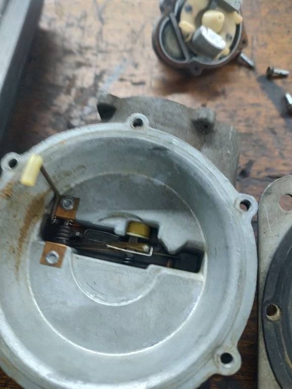

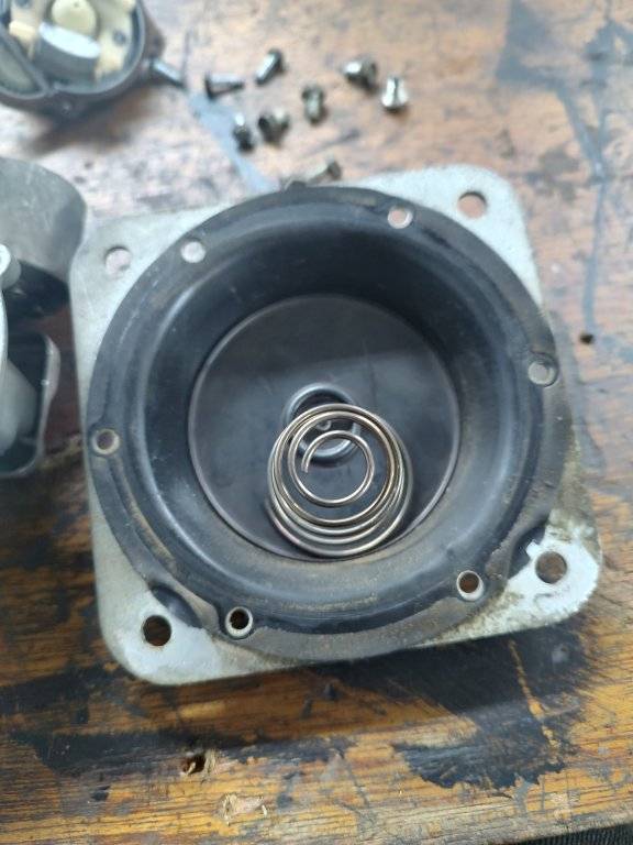

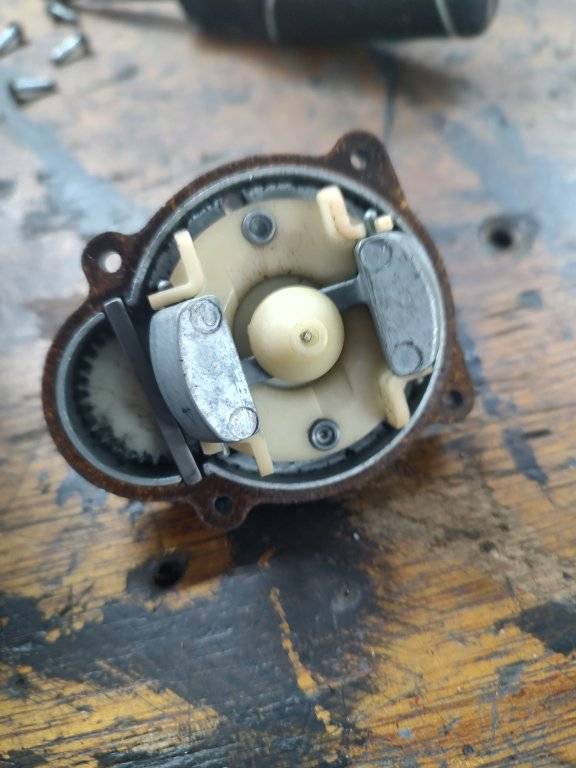

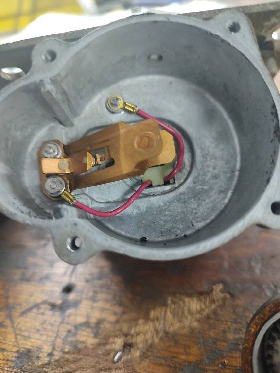

Ok. Got new direct cable on and took cruise off car. Anyone been in them before?
Unit looks very clean and everything turns correctly. Didn't find anything locking up. Gonna check. Vacuum side next.
