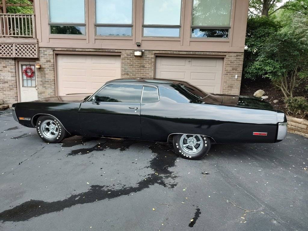

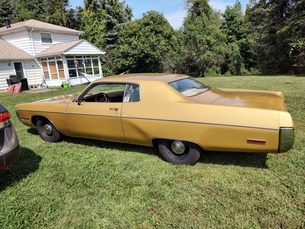

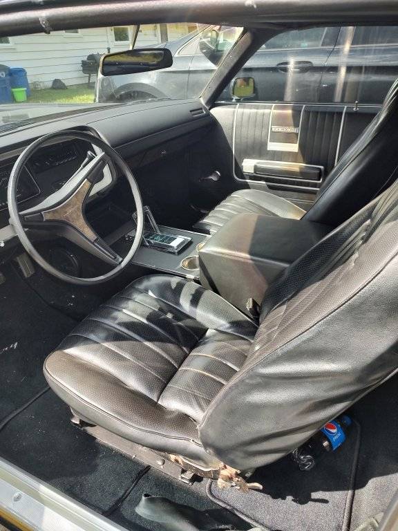

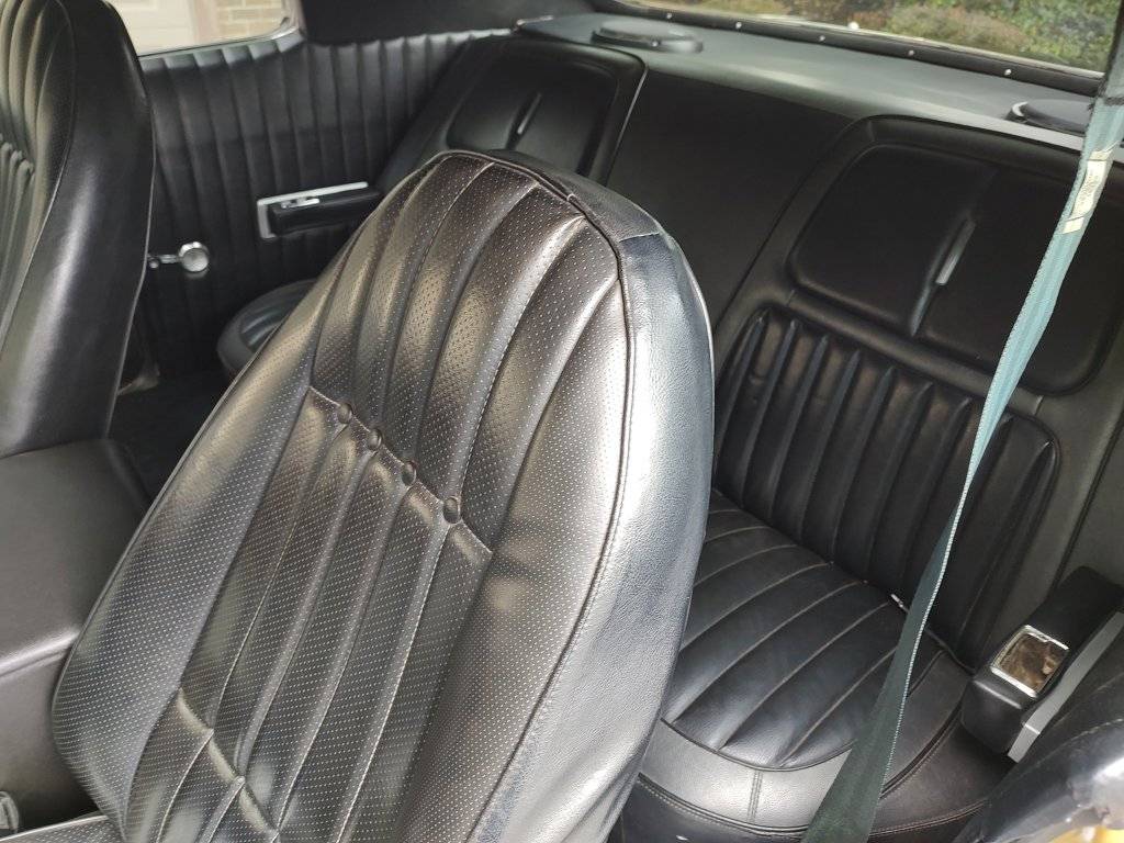

Hello all , i have a 1972 Plymouth Fury 360/727 original color is like a mustard color with similar/beige interior. I removed the entire interior ,converted the column shifter to the floor , converted bench to buckets ,replaced back seats and door panels from 73 Fury, new carpet ,new headliner ,new bluetooth classic radio, new wheels , a custom center console and a nos dash.I couldn't wait a year and a half for a paint job so i got her vinyl wrapped, SHE TURNED OUT BEAUTIFUL Now i'm looking for some more horsepower . I impulse bought a 2016 Hemi after getting info it should bolt right up to the 727 . Made some calls and looks like just under 2k for wiring to get it to turn over . Now considering maybe a 440 short block or a stroker that would bolt right in. I like to keep the current 727 but not a deal breaker . I would appreciate any input on changing the motor ,thanks
