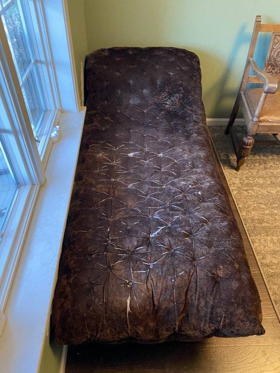

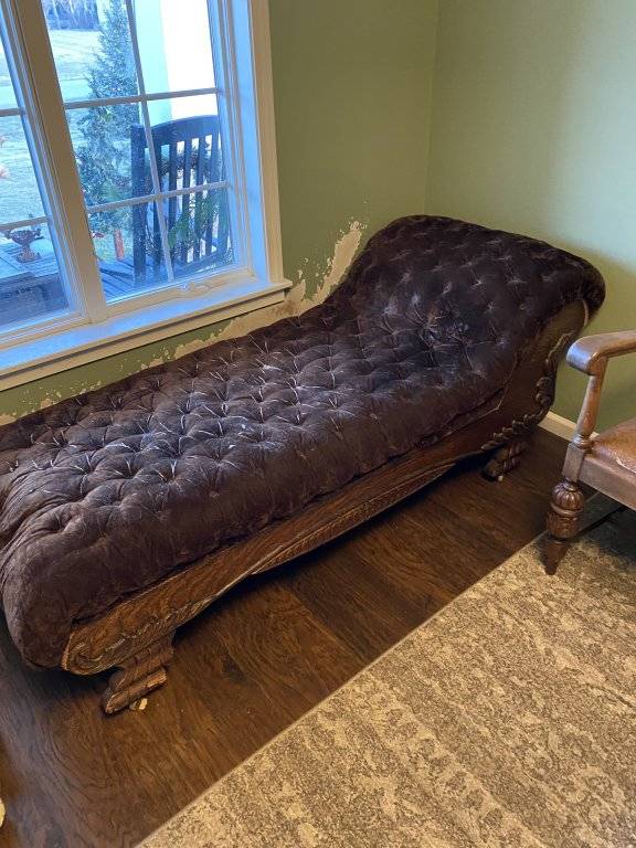

Here is one of my first ambitious projects. It was a fainting couch with about 160 covered buttons. I did this about 15? Years ag. This is Where I learned the skill of button tufting. I cutout each of the 1”cloth circles by hand and then used a small hand tool to snap the inserts together. It took a while. Since I have done that I learned a couple of things. Fabric quality counts. If it is going to see some use you should use a higher density foam, and dog hair is attracted to velour. Also if you put it in front of a window your dogs will take it over when you are not home. It didn’t help that both were around 100lbs each. And you will see in the picture I have some wall repair as one would constantly stretch his feet against the wall. Probably some wall licking going on as well.
So this will be on my list to re-do after my barstools. Plan to do in a durable leather look fabric with my office chairs. I will also make a dog proof cover, until this last dog expires.

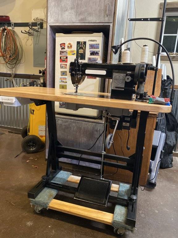

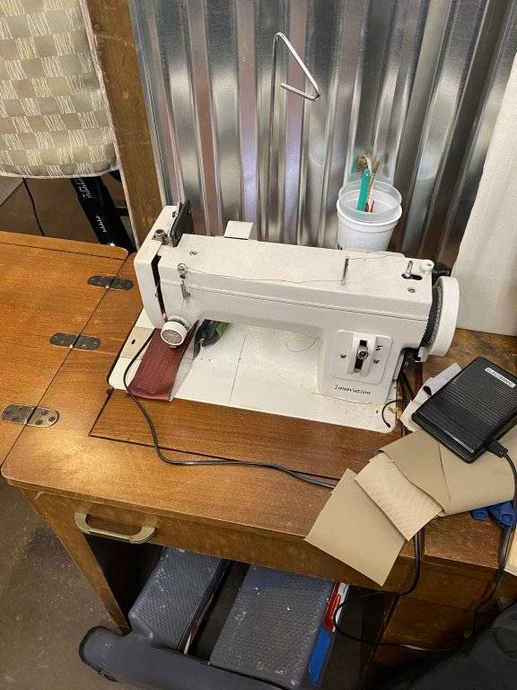

Then when I first brought my car back to start restoring around 2009, I thought that I would do my seats myself so bought an upholstery machine off E-bay for under $300. Turned out to be a great investment. I procrastinated for about 5 years before I jumped into my seat project. The arm was a little small and the pressure foot was maxed out many times for the thickness, but it is a straight sewing son of a gun. And didn’t miss a stitch.

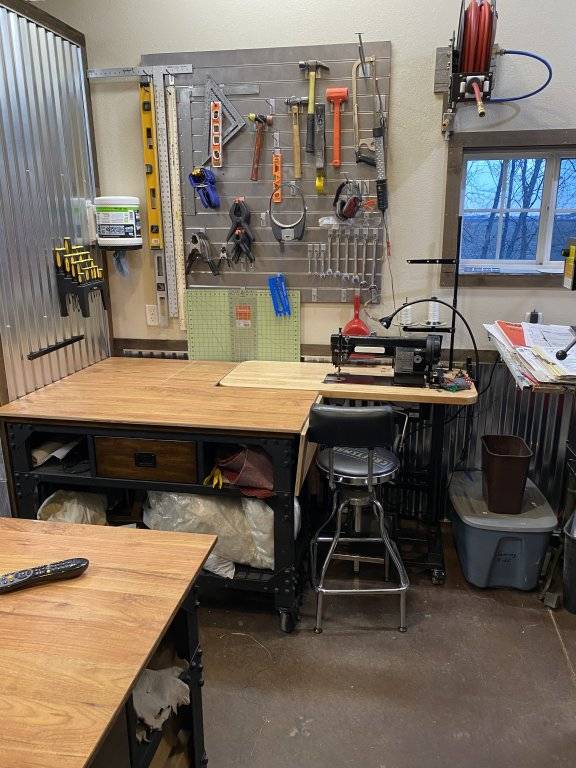

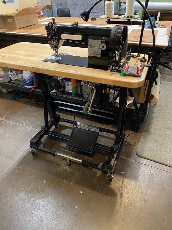

After the project I was talking to my wife about doing more projects but wanted a little more capacity she started asking me what I wanted and then surprised me for Christmas. When it was delivered she wanted to put it under the tree, but it came in 3 big heavy boxes, so she had to get me to bring them in the house. I actually had it set up by Christmas Day and put a bow on it. The mac daddy
Sailrite Fabricator. So now I have to do some projects to get some payback from the investment.

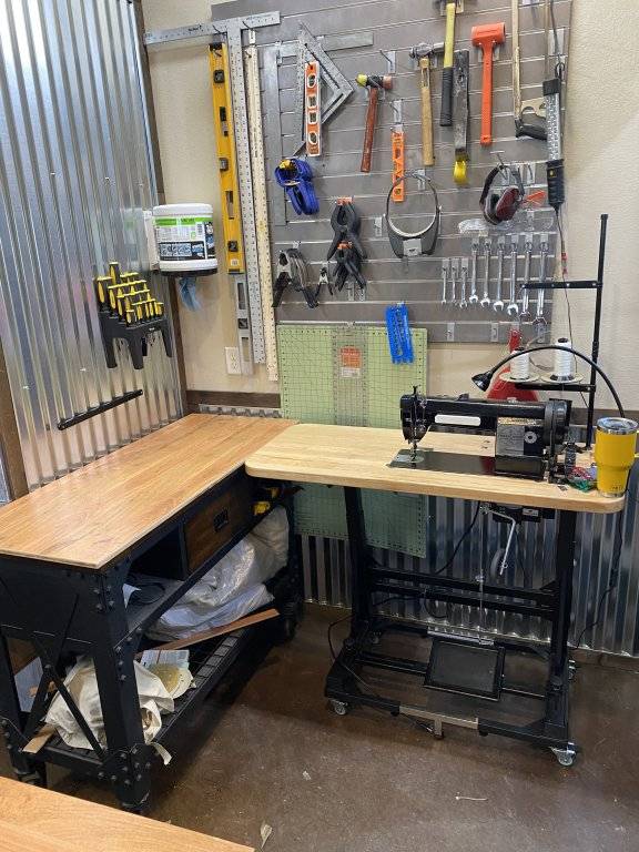

Up on temporary rollers to match the layout table height.
The white one may go up for sale. As it is just taking up space. If it had zigzag I would keep it.

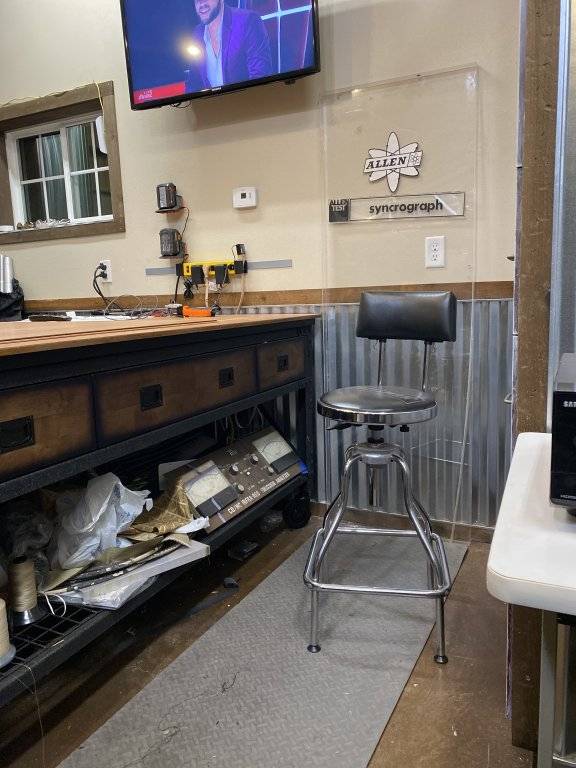

I like the corrugated tin. I used some of that to skin a cedar-framed raised-garden box.
Never considered using it to make the garage a cool place, though.

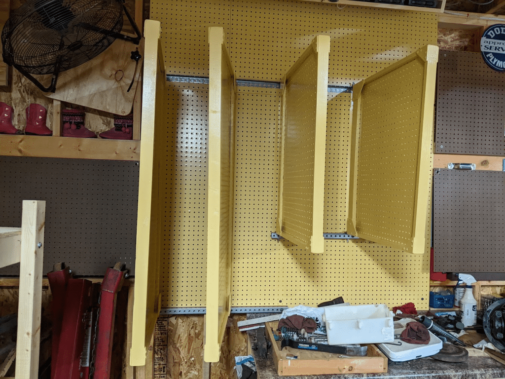

If you need denser storage, here's something I did in my garage.
It's bigger and more HD than it needed to be, but it'll hold a ton of stuff.
Especially stuff that I don't know where to store because I don't know how to classify it. Those things now hang in plain sight, and the brain eventually remembers where they are.
I went from a wall of pegboard to nearly as much wall of pegboard + 5x the amount on the hinged panels.

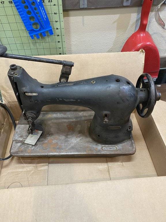

I then found an old Singer 16-188 Walking foot machine. It's a bull with a leather belt on it. I've done ground cloths. awnings, skirting for my pop up motorcyle camper. This will be my heavy thread machine.

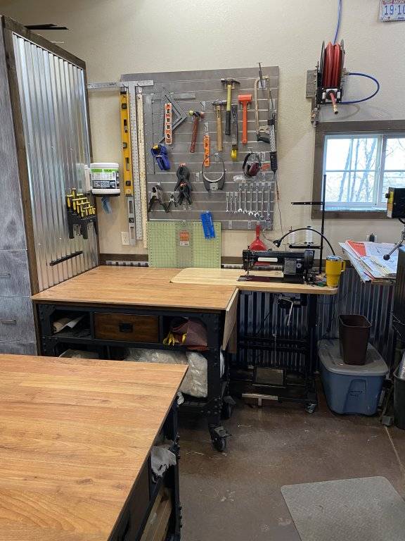

I wanted a water resistant easy clean up wainscoting. Plus the tin kind of gives it a “classic” look. I trimmed it out with Cedar. Believe it or not, I waited until Lowes had their dog eared cedar fence slats on sale. Very good price per board foot. I ripped them to size and made up a vinigar aging solution (vinegar, water and steel wool) and painted them with that to give it a more aged finish. Same with my windows.
yes, cedar dog-eared fence boards are an economical source for non-fencing wood use.

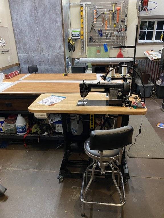

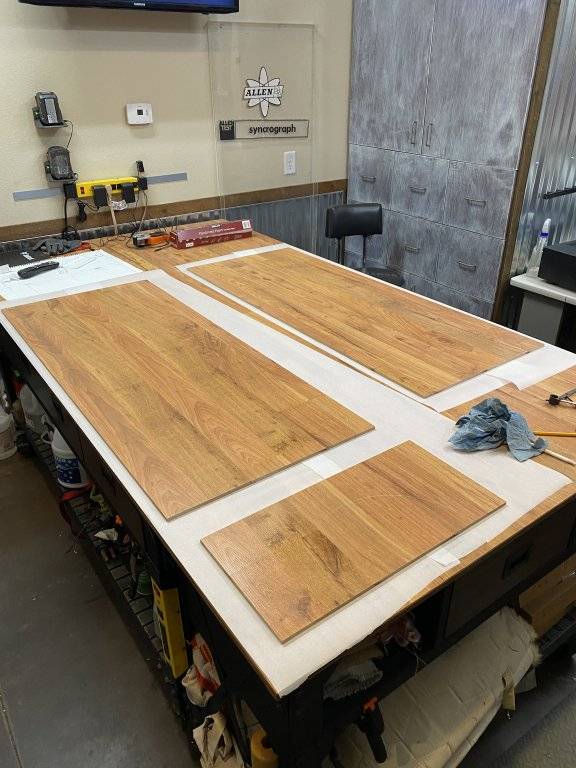

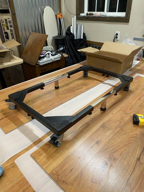

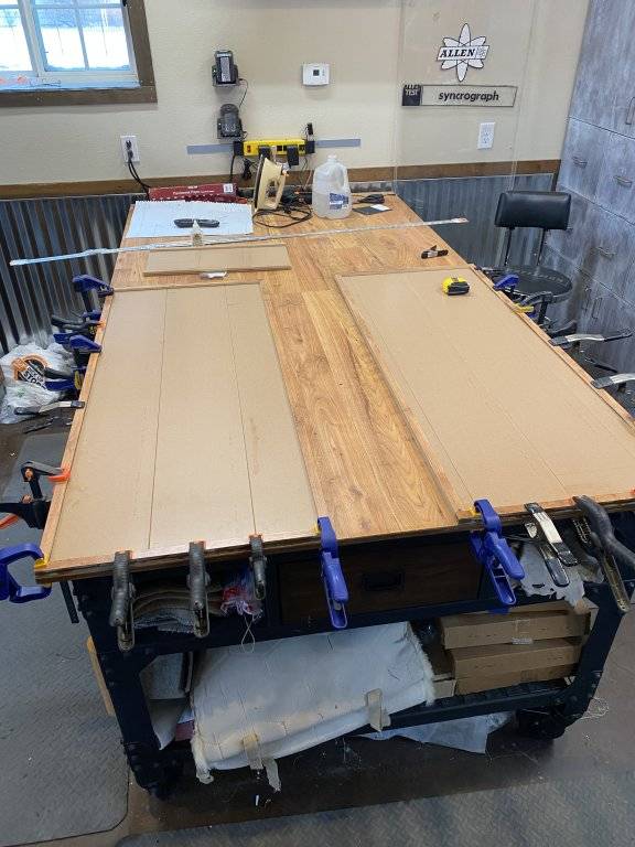

A little more progress tonight on my setup. Glued up my laminate flooring tops. So will put another 1/2” wide piece of laminate for edging. This will trap it on the workbench and keep it from sliding. Then I will need to put hinges on the fold up pieces and figure out how to support them when up. I may be able to use my drawers on my big table as supports. The slides are heavy duty. It might be worth a shot. Also my base with wheels came for my sewing table. It is perfect and wasn’t much different in price than buying 4 wheels.
CHINCHILLA Heavy Duty All Stainless Steel Mobile Fridge Stand Base, Washing Machine Stand with Wheels, Adjustable Furniture Dolly for Washer, Refrigerator and Dryer(Large) https://a.co/d/5zVJIkg

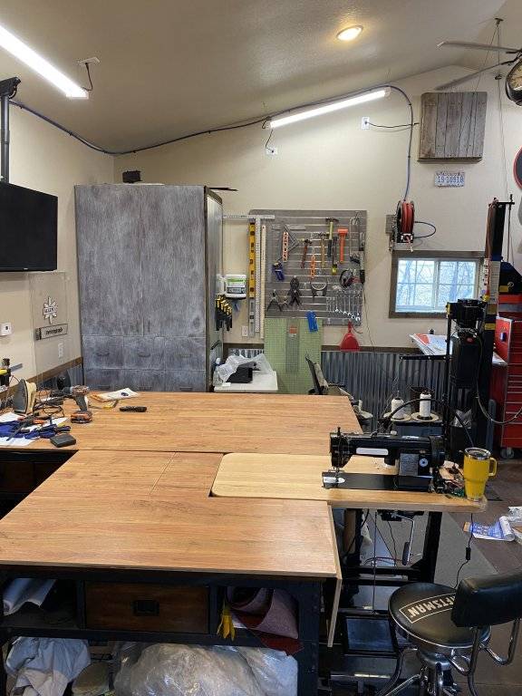

Gluing up the edges on my table topper and extensions. Will give it a little more strength and trap it on the workbench.

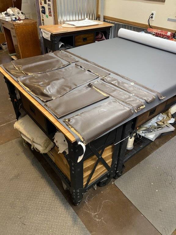

Also received my fabric for my stools. Traced out the patterns. I need to adjust one a little, then I may layer the fabric and cut out 3 at a time. Then I only need to trace it once more.

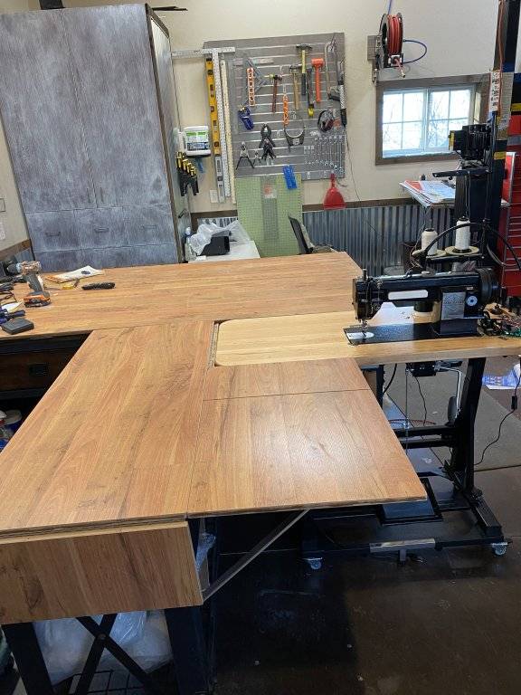

Back to work in the shop. I have everything together, but now need to figure out how to arrange it when I don’t need the big sewing space.
Here are a couple of choices when working on larger pieces.
Long in feed
Support indeed for bulky items
Wider items.
