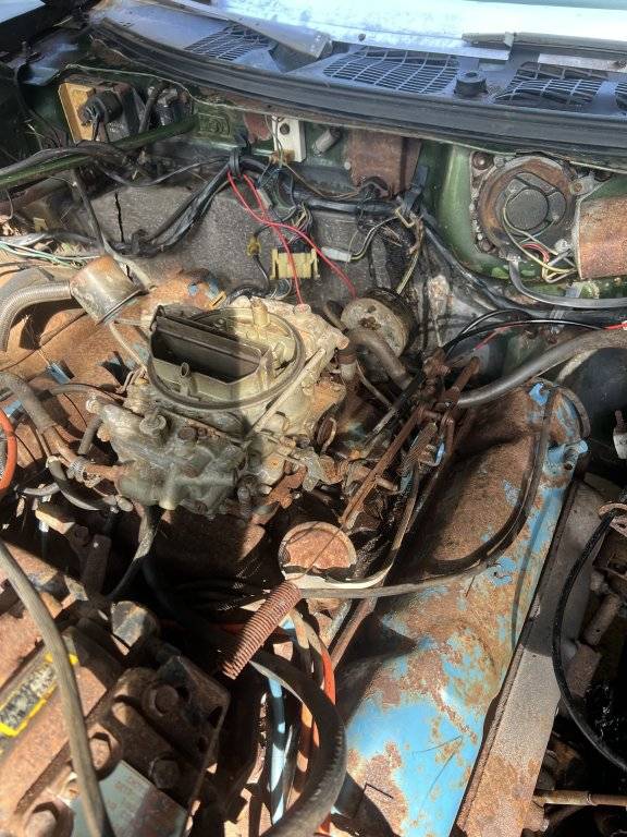

My 73 T&C has this carb on it, it has the original appearing linkage for the cruise.
Did this car come with this carb originally?
The car originally had the Carter ThermoQuad on it. The Holley R7855 is an OEM-replacement Holley for the Chrysler B/RB engine, which is why it came with the correct Chrysler throttle and kickdown linkage hook-ups on it. With the stud for the throttle/cruise control transferring from the original carb.
In my orientation, a better carb than the Carter. Holley model 4175 vac secondary spreadbore. Constructed and rebuilds like a normal Holley 4bbl 4160, just that it's a spreadbore carb instead.
Enjoy!

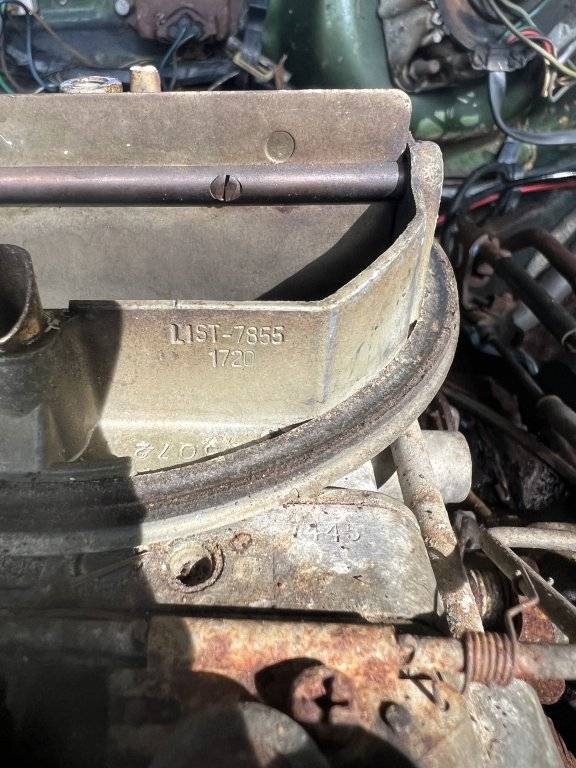

The number below the list number is the date code. First three digits are the day of the year, in this case the 172nd day of the year. The last digit is the year, in this case 0 is the year of manufacture, probably 1980. On that basis, the carb is likely not original to the car. Most standard performance big block Mopars had list 4160 Holley in the early '70's with some variations for CA mandated emissions. The 7855 650cfm was usually a carb used as a replacement on some Mopar engines that came equiped with a thermoquad spread bore carb. The plastic plenum on the thermoquad went to hell after a few years and many were replaced.
