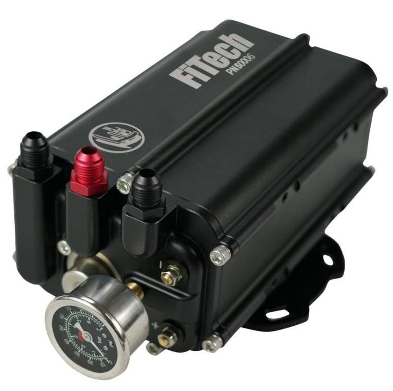

Everything @67_300_Convertible said above. Including my kid inheriting my 68 300 convertible some day. I have a fitech efi and MSD distributor, but really appreciate the reliability I have with the car these past 6 years. EFI is not for everyone, and I hope the carb guys respond to you as well, but I a super happy with my choice to go with an EFI system.
