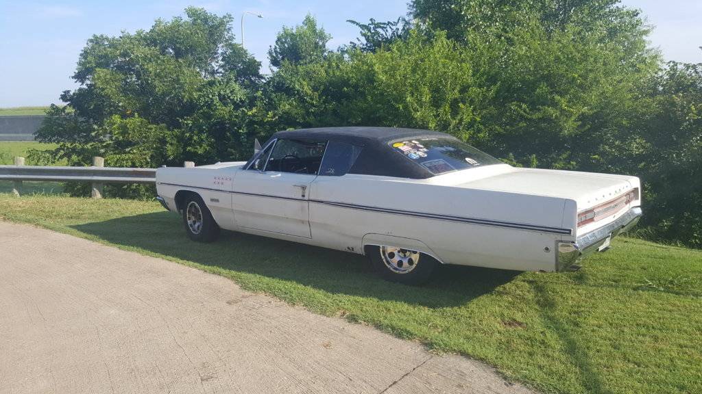

somewhere in this forum is my post where I did the roof with truck bed liner and por15 patch and putty. I based my posts off of a previous work by another forum member, and they actually chose to cover their (good) roof with pookey and not vinyl.
but ya- sand it down, por patch and putty up everything, then coat it with bedliner, and drive the wheels off it.

so thats what i started with. id trade you.
i sanded all the rust out that i could get to without unriveting the metal pieces previously added.
used the por PUTTY to build my straight edges around the window channel, etc, and to fill void, etc.
used the por GOOP in the tube to fill after that, the seams, etc
then i taped off in vinyl roof pattern ,and bedlinered the whole thing

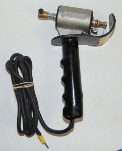

That's a nifty lil thing. Looks like something I could leave at my bench for a fast tack. Does it realy work?
