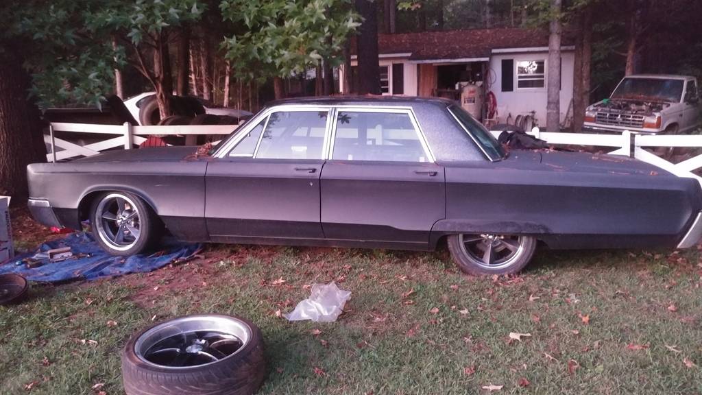

Hood Scoop for 67 Newport Sedan
lol, I figured I would get a lot of people telling me not to cut up the hood. That's why im considering all routes first and trying to figure out what would fit the contours of my hood. I may look for another hood somewhere to mess with first, but I have learned Newport parts aren't easy to come by. I love the scoop slantsix posted. Would that fit the contour of my hood or would I need a body man to do that one for me?

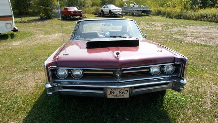

My issue with scoops on a slab (I'm just going to stick with slabs though this applies in one way or another to any c-body) is that they generally have a sharp crease up the center of the hood. Scoops wind up looking like bad septum piercings:

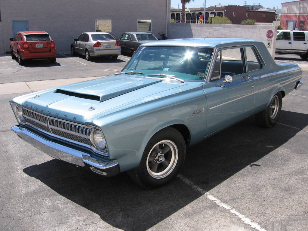

That's the WO/RO scoop for B bodies, it works on my Polara, that's all I can verify. Most scoops will look out of place. I went so far as to make a cardboard template to see if it was even close.

If you must,,Then go with Slantsix suggestion. this is a 65 Plymouth A 990 style. Cost is about $200+ shipping. Several Mopar vendors sell them. the 66-67 RO cars are similar.
