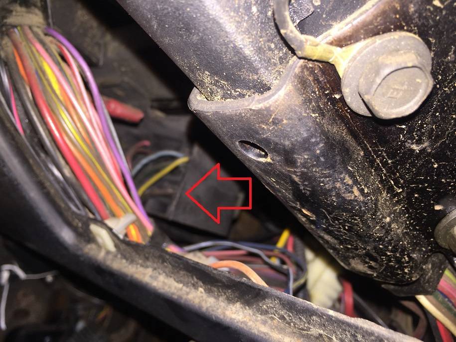

I was trying to test the relay with a voltmeter but it's located in an unaccessible part just behind the dash on the mount marked with the red arrow (check the attached pic)
Any idea how to access the horn relay?
just so happens the steering column ground is that black wire on the bolt in your picture. pretty sure that relay box just slides onto a metal bracket. should pull off, drop down for access. book shows wire color codes as black with red as ground feed from switch, dark green with red as hot out to horn, hot wire from fuse isn't labeled for color! really man, a good basic test light is what you need for this diag. volt meters can muck things up. hate to complicate this but do you have a tilt column? use it often? i've seen the wiring break in the column as a result of flexing with the column movement. SG
