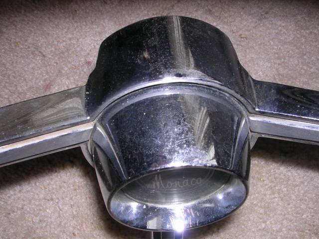

Well, my memory is fading - there's 2 on the shelf, both in pretty nice used condition, but nowhere near new.

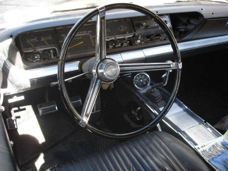

I don't want to steer you wrong. I know for sure that the center cap will fit another 2 spoke horn ring. I have heard that the 3 spoke ones use a different cap....... But that was a sport style wheel without a horn ring. It had horn bars on the spokes. That was on a 67 3 spoke trying to fit that cap to a 2 spoke wheel. I would say 2 spoke horn ring to 3 spoke horn ring it should be the same. Just not on a sport style wheel.
This is the sport style wheel Iam referring to.
Say I purchase this wheel, obviously my current two spoke horn ring won't work, but I can use my center cap on this three spoke horn ring? Then only the wiser guys would catch that it's not correct since it's not a full ring like the Polara? Hmmmm...

Well, out in the light, they're usable but far from perfect. The best one shines nice and is straight, but has a bit of pitting.
