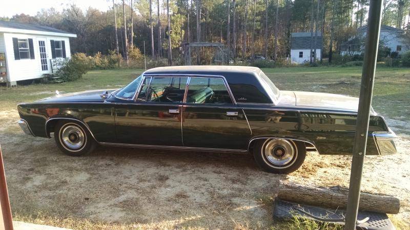

Welcome to the site from the Motor City! Pics are a must.
ive tried two batteries, one of them out of my bb 74 roadrunner. i havent checked the timing but i will. i bought this car from an estate and it is beautiful. it looks as good on the bottom as the top. everything works including the air. i dont really know how to post pics, can someone give me an idea?
