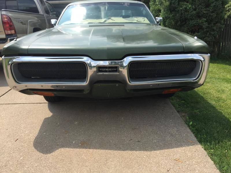

I have a nice documented low mile Fury with 360. I plan on building a 440 but want to make the right decisions:
I want a strong 440 with 450 - 475 hp as goal
It should be able to lay rubber (I just purchased 3.23, 9 1/4 rearend with sure grip)
I worry about a motor that is over bored and at risk of cracking (how much over is ok with sleeves)?
I would like it to be a strong sounding motor but not overly loud so my wife complains and hence will not travel in the car
I heard before 1972 is important? Forged Crank, etc.
What are best heads / design 904, 906, etc.
I have never built a motor before and appreciate all suggestions
Do I need a new transmission 727 now, but is 440 different?
What is good stall in torque converter 2200 rpm?
