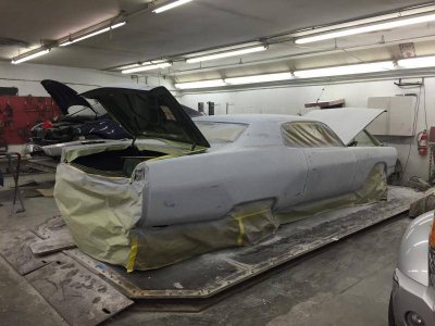

IMG_0541.jpgIMG_0545.jpgThanks for the information - I really want to make a strong car to "drive the hell out of" hence my post on 9 1/4 rear end v 8 3/4, 3.23 v 3.55 gears and the best 440s to use. Yes, I know I will have many times the value of the car spent before done. I am sixteen again in this car (unless I look down or in the mirrors).

I just received the new police interceptor rims and dropped them off to be painted to match. (here is car last week) The car was a few shades darker than the Sherwood Green it came with from the factory - will use the dog dish caps with the holes
