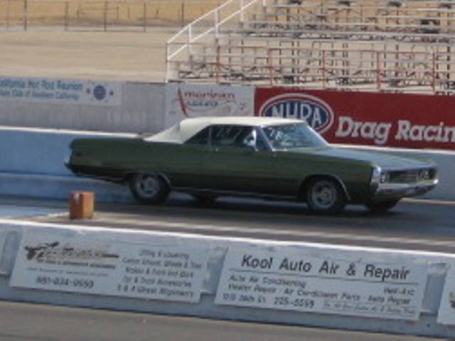

My '70 Newport has a 440 with 2.73 gears. It will spin the tires in stock condition.
This was quite embarrassing as it led to a 19 second quarter mile.
So, 450 HP is not necessary to spin the tires. But, if your car were mine, I'd keep the 360. I'd rather have the gas mileage instead of the ability to spin the tires. That's my opinion.

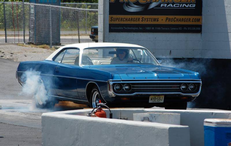

This stock 71 440 will NOT spin the tires from a standstill . 3:23 gears in the rear and she ran a 15.3...with a bad reaction time . I dont have any of these to be good on gas, I dont really care what the mileage is. They get driven so little it has no bearing on my financial outcome at the end of the year. The 360 isnt going to get that much better fuel economy for you to notice
