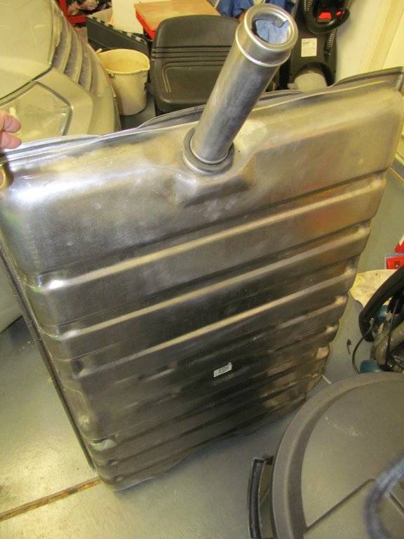

I bought a new tank for my '67 Monaco from Vans last year, they were "on sale", $240 plus shipping. Shipping to Michigan was I think $50. It seems to be identical to my original from eye-balling it next to each other and with a tape measure. I'd imagine your '68 300 would have had the exact same gas tank as my '67 2-door Monaco.
I did clean my original tank with double-strength vinegar (about 3 gallons) and electrolosis (which involved floating long pieces of shiny metal in the vinegar connected to a DC power source and rotating the tank periodically over a period of about a week). The vinegar got warm during this. It was taking about 60 watts based on the power supply readout. It was very clean when I finished, but I also had a few holes from rust pitting that opened up. Very small ones. I was debating if I was going to solder them closed or buy a new tank. I bought a new tank, the price was right. Here in Canada a tank delivered to your door would probably cost double what I ended up paying.
