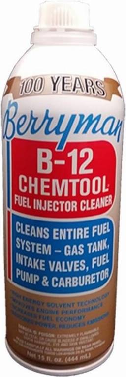

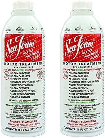

You can always go with either of these as well:
View attachment 600631View attachment 600632
I’m pretty sure that Berryman’s is what I used in reviving my Dodge Caravan that was in storage way too long and didn’t even run when parked. (I had to change the timing belt—and then discovered that the fuel pump was shot.) After hand-cleaning the gas tank, replacing the pump and filter, I used such a product to clean the fuel system. (I may be misremembering the brand.) Van fired right up like nothing bad had ever happened.
