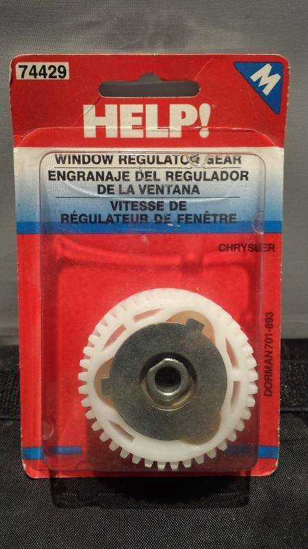

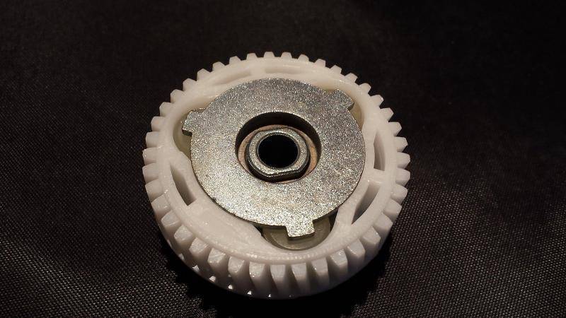

Nice! I just did my passenger side door before I saw this post. I ended up ordering a new Dorman gear assembly (comes with nylon pucks) off ebay. Will post pics soon.

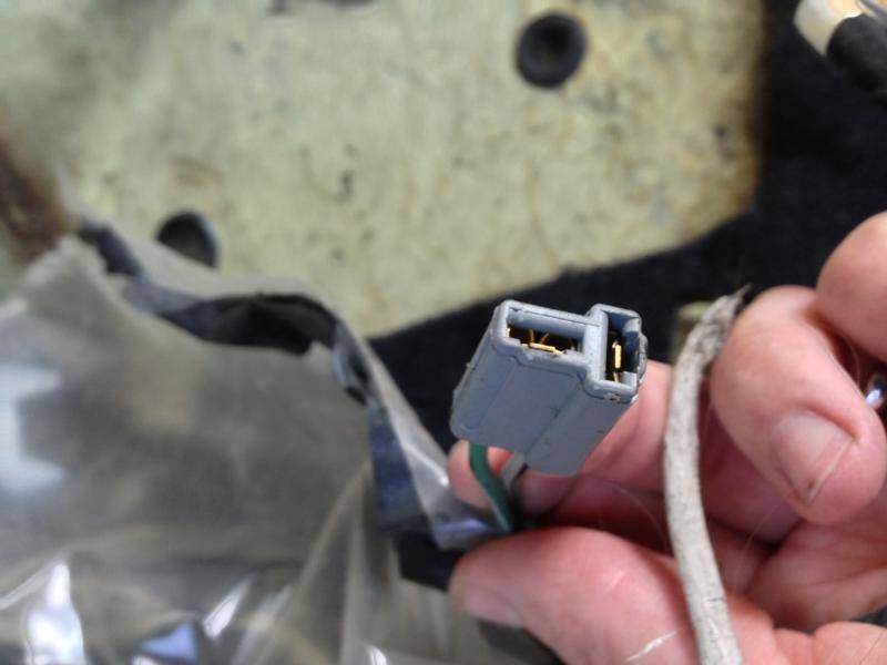

Now working on R quarter window - I got the car w/o motor installed, only a "rebuilt" motor in an A-1 Cardone box *shutter*.
What gauge are the wires going to the motor? I need to find spades and a connector block for the rear quarter window motor now, as the rebuilt motor doesn't have terminals on the wires to connect to the body harness connector (pictured below).

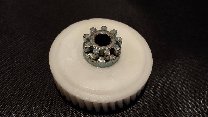

The reason I had to go with a completely new gear set was because the metal spur gear had a missin' tooth. When that spot came around on the regulator gear, the regulator would drop!
As stated these have nylon "pucks" which are pretty solid. I think they function like a shock absorber to the motor when the regulator reaches its limits of travel. What were the original pucks made of?

The damn motor from A-1 Cardone that I got with the car came without a gear and gear cover plate. What's up with that? So, deep into my project, had to stop and look for more parts. Thankfully this one popped up.

The original pucks were plastic and did have some give to them. That's why in the instructions using the nuts, I mention that the gear needs a bit of play to it.
Even buying Ebay parts like you did, those plastic pucks are how many years old? Sorry to say, but there's no telling how brittle they've become and how long they'll last before you need to do the puck replacement.
