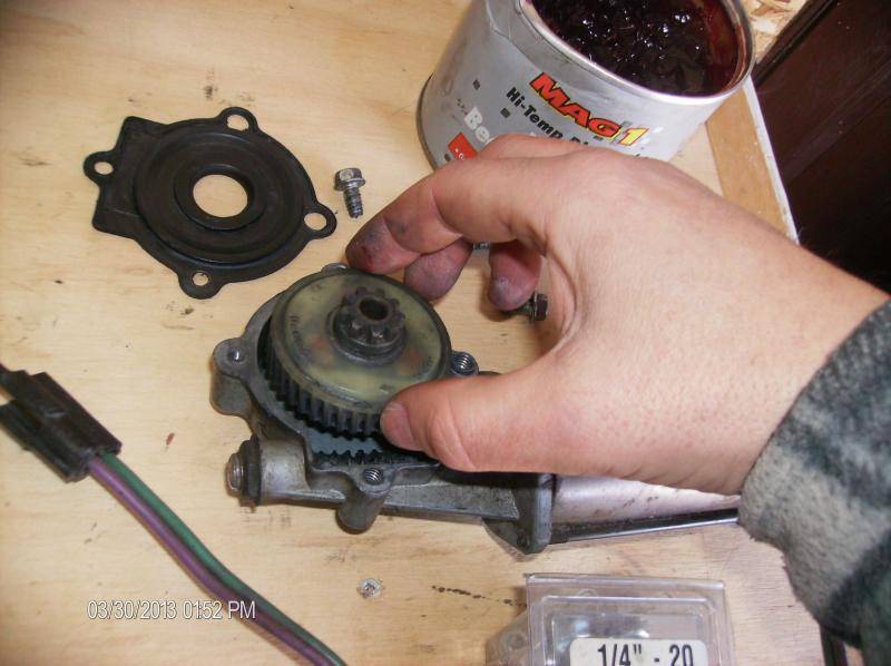

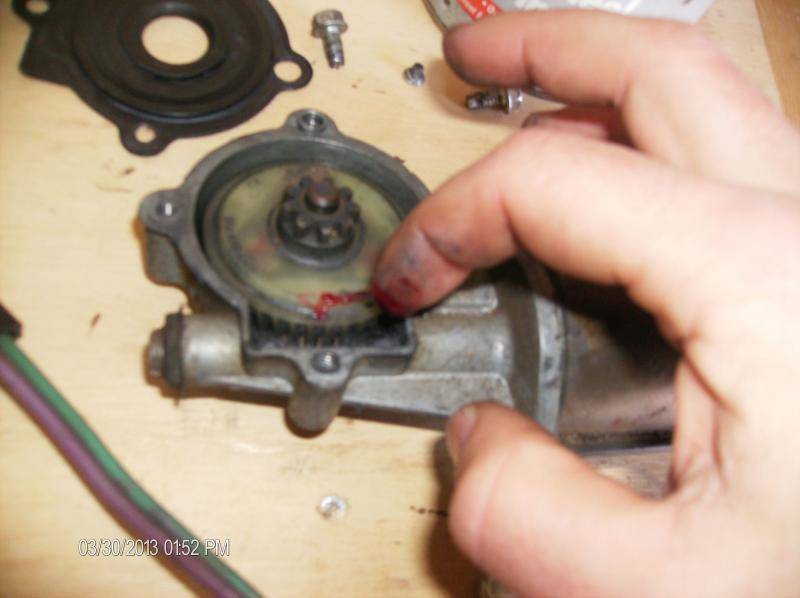

Place rebuilt clutch.
Ensure it's well lubricated between the outer clutch and the threaded gear in the motor housing too.

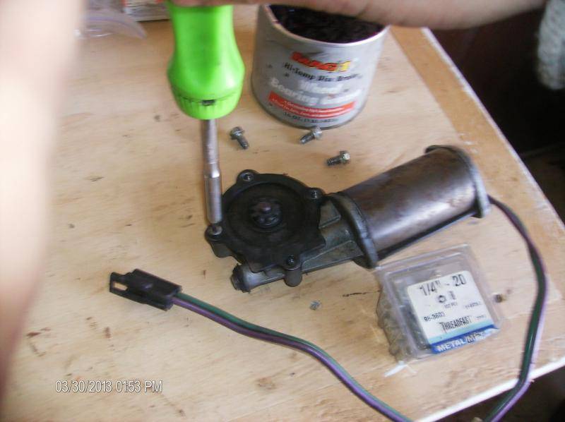

Replace cover with the Phillips screw.
You're done...better than new!
Note: You should be able to grab the gear and hmove it a bit after assembly..as mentioned sixteenth to eighth of an inch play is enough.
I hope it was useful.
It looks like you place a dab of grease on the teeth as well?
