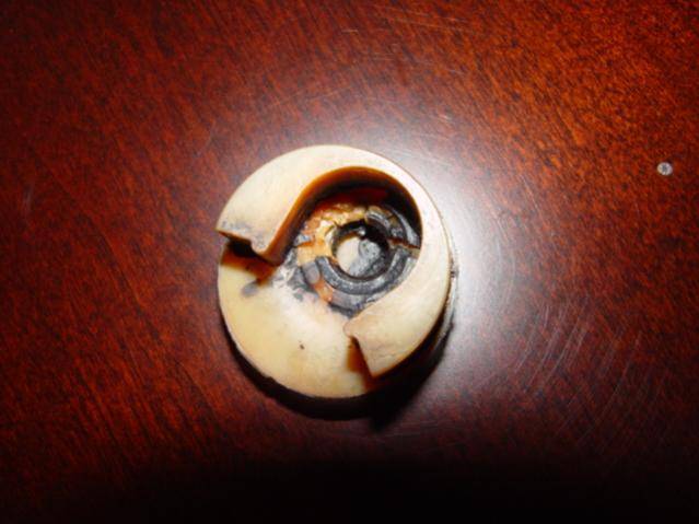

He's selling the 1978 wiper cam kit that mounts to wiper motor and to the first linkage rod.
They look like this......
Excuse me.....I posted pictures of a broken one but you get the idea.

Bob, the replacements that Murray is selling, is it the 78 bushing repopped or is it a repair kit similar to was you cobbled up?

Beautiful car, congratulations! The 78 Newport seats like yours are possibly the most comfortable seats ever put in a car. By the way, you mentioned that the wiper bushing is still good...here's a tip to make it last:
Drill a small hole in the plastic case for a zerk fitting- before putting the zerk fitting on it, spray the inside like crazy with penetrating lube, then insert the fitting and periodically give it squirt of grease. Internal failures of those units was from them being sealed and the grease becoming hard like cement.
It's a repop kit....I'm going to buy a set for my Newport.
Your Newport has the same system as your New Yorker? Hmmm because my T&C is completely different...than my NYB. Make sure its the same before you order... Just saying... to be on the safe side. I dont know why they had to make two different setups... Arrrrgh. Lol
