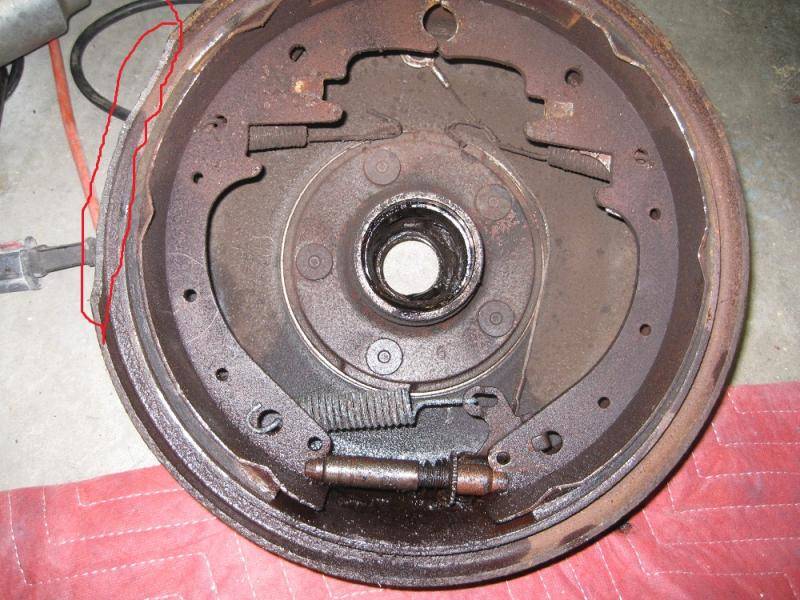

It must be work on your '66 300 drums week. Before I knew what I was doing I took a sliver out of my drum. I figured that with all the problems removing the drums that I would be replacing them, because the shoes would have been set in a groove.
To my surprise the drums are in really good shape and I was going to keep them. I forgot to take a picture before I left the shop. The damage is to the to the back edge extends into the drum about a 1/4" but moves around the edge about 4". Is there any reason why I can't use this drum?

I did have a picture of the damage. I wanted to show also how the shoes would not release from the drum. Brake drums sm damage.jpg
Thanks for the pic...and yes the drum is Fubard. Me personally...I would replace the drums as a pair. But that's just me.

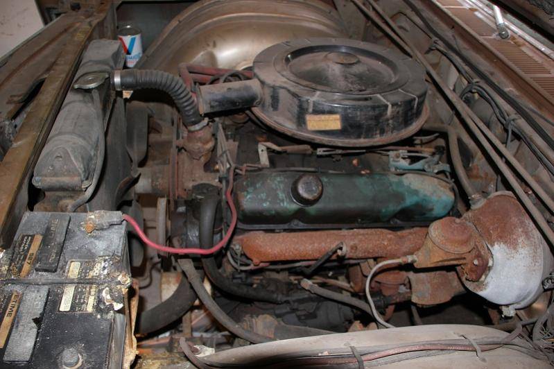

I was looking at buying the Cardone dual master brake cylinder with the power booster. It mentioned with or without field installed Hydro-Vac. How can I identify if I have this or not. Here is a picture.

In all honesty, I have never heard of this "hydro-pac" thingie.
I googled it and came up with nothing but a YouTube video of WW II trucks using Hydro-vac brakes. LOL
My guess, because of the term "field installed" means the non-factory OEM unit.
I'd call RockAuto and then Cardone directly.
From your picture, your booster is the "single" diagphram" booster if that's of any help.
