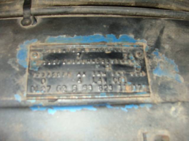

I need help with info about VIN/ ID / model of my 1968 Chrysler 300

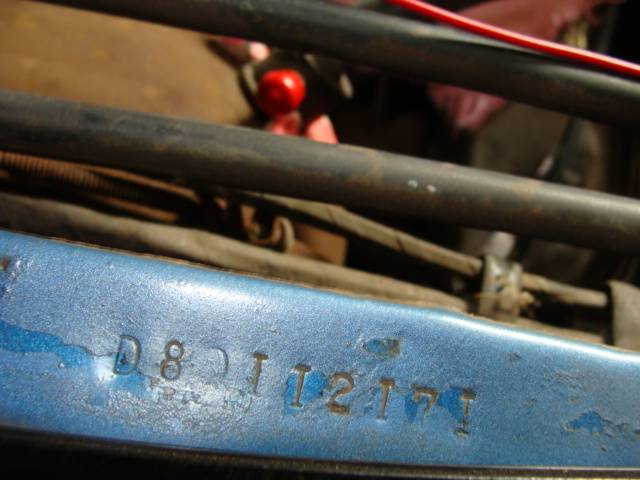

In '68, the only places where you have both VIN and Shipping order number is on the car itself, the window sticker, the build sheet, and maybe some original paperwork when the car was purchased. The VIN tag on the dash doesn't match anything on the car, except some (most) high performance engines had the VIN stamped into the block as mentioned by Fireflite56. The fender tag just has the shipping order number, which is what is stamped on the body. If you're lucky to find a build (broadcast) sheet, it will have both the VIN and shipping order number. Look under the springs of the rear seat back (most common) rear seat bottom, under the carpet, behind the glove box, and occasionally many other places in the interior. I've seen the wrapped around a steering column, inside a door or quarter panel, under the front seat, and even one in the headliner.

What do you mean by „vin tag on the dash doesn’t match anything on the car”?
Do you mean my vin on my car doesn’t match what the car really is?

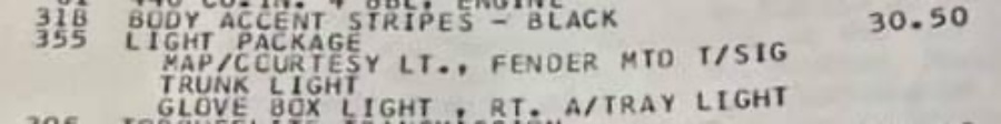

I have a suspicion your car also has the Light Package. Could you confirm if it has the following components?
Does your car have a rear speaker?
What does light package contains?

From the factory on a 68 there is no VIN on the car other than the dash tag.
The body stampings in 68 and older were the Shipping Order number.
Starting in 69 the VIN was stamped on the body in two places.

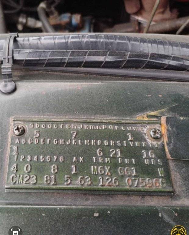

Hey!!
Would you help with another one since you know how? :D :D :D
It would be simply great if you have time of course.
Someone can double check my work, but I believe this is how your tag decodes:
b5 Folding arm rest (buddy seat), order code 485
h7 Fender mounted turn signal indicators
u1 Sold car when built (someone ordered it)
A1 26 in. radiator
P6 Rear seat speaker
R2 Music master AM radio
S1 Air conditioning
X1 Tinted glass (all)
Y6 Black vinyl top
1 4 Sill mouldings
3 0 Body belt mouldings
7 8 Wheel lip mouldings
AX 1 2.76 rear axle ratio
TRM M6X Vinyl bucket seats, black interior
PNT GG1 Forest Green Metallic
UBS W White horizontal stripe
CM23 1968 Chrysler 300 2 door hardtop
81 440 4bbl
5 3-speed automatic transmission
63 Tire code
126 Scheduled build date: January 26, 1968
075968 Sequence number. Note: this is NOT supposed to match VIN
