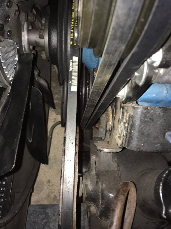

As I took a closer look at my '66 Polara yesterday, I discovered that the engine fan/water pump belt uses an idler pulley. Whaaaaaaaaat?
Where does one one purchase this? I've been online for the last hour and haven't seen what I'm looking for. I see lot's of 67 and up brackets and pulley assemblies, but not this.
Maybe I've missed something, but could someone point me in the right direction please?

If you use this pulley, you can eliminate the idler by using the rearmost groove and looping the belt around the power steering pump pulley.

I have 1962, 1967 and 1970 AC big blocks. They all use this idler pulley. The bracket changes design on the 67 and 70 but the 62 bracket has the same bolt locations and could interchange.

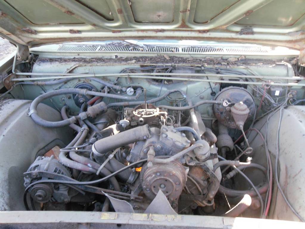

Great, something else to contemplate on my Monaco. Are the replacement idler pulleys junk? I haven't ever looked as my A/C cars never had the A/C working, or the parts were already gone.
Or maybe not, doesn't look like the P/S pump is there.
