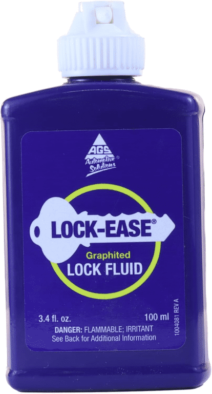

Before you do anything, you want to lube the lock. It sounds like you have some tumblers sticking.
Don't use penetrating oil as that tends to gum things up, depending on what you are using. (never use WD-40 for example).
This is the stuff to use. Squirt some in the lock and start inserting and removing the key. Once it starts getting easier, then start wiggling the key back and forth, never forcing it.
This can will last forever.
Agreed, graphite is well suited for lock tumblers.
