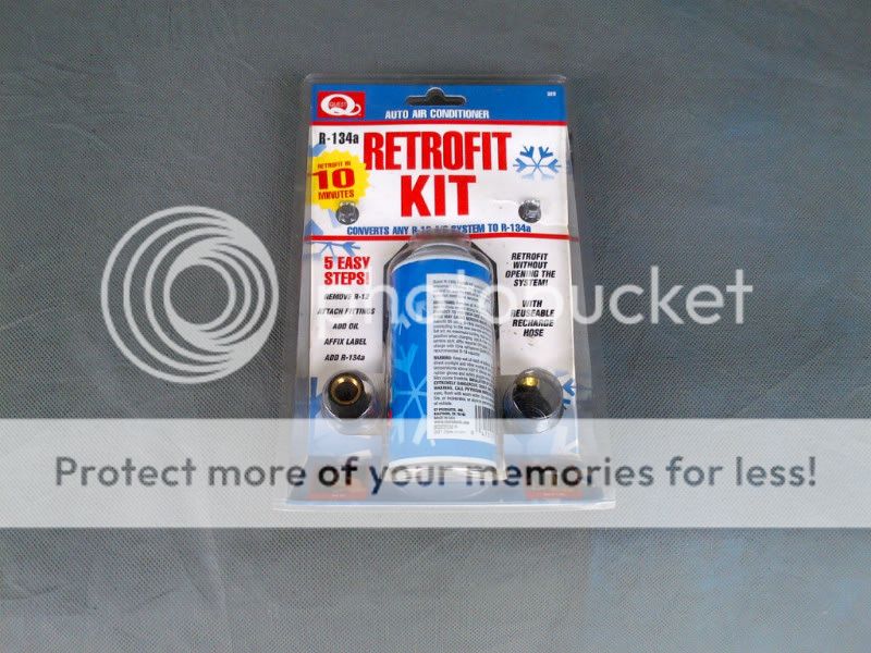

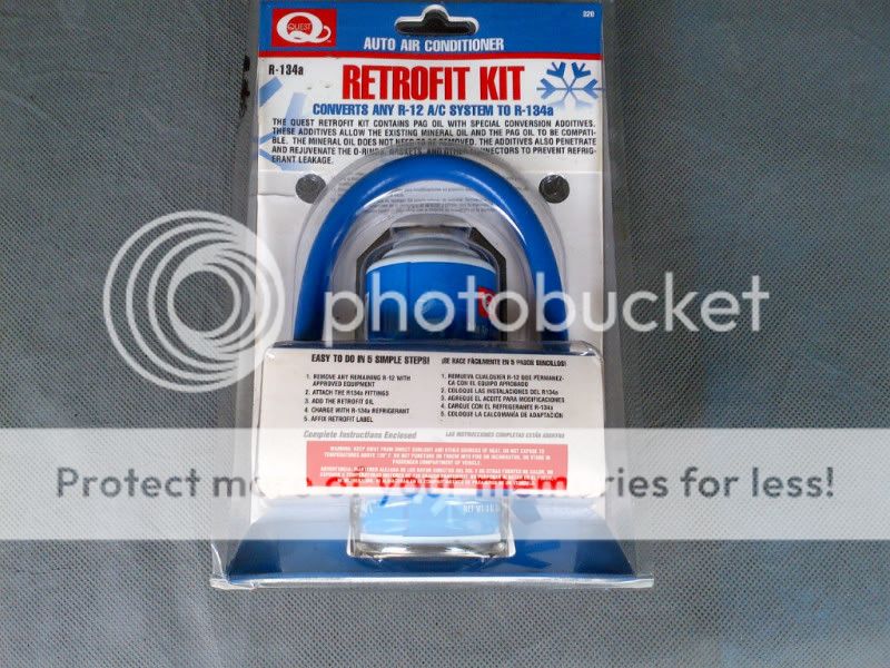

This is the kit I used. It worked very well.
Mike, did that kit have the right adapter for the high pressure side. Where is it available? Quest? I charged the system last fall just to make sure the compressor worked. I've got a new H-Block, receiver drier, and a flush kit. I'm going to get the hoses redone at a local hydraulic shop and charge her up again. Also going to start stock piling R134A freon before the price really gets out of hand.
