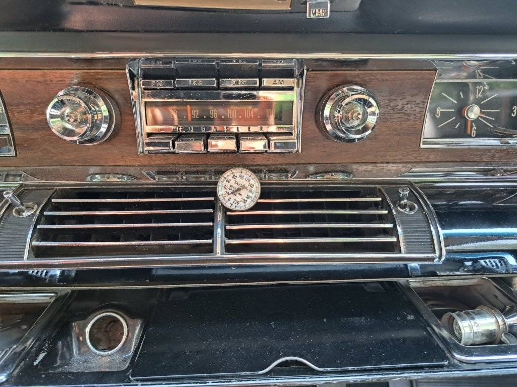

This is a pic of the vent temp teading in my 66 T&C just a couple of weeks ago, using Duracool.
I got the same performance from R134A... but switched to Duracool about 5 years ago or more.
Less than 20 degrees? Really?

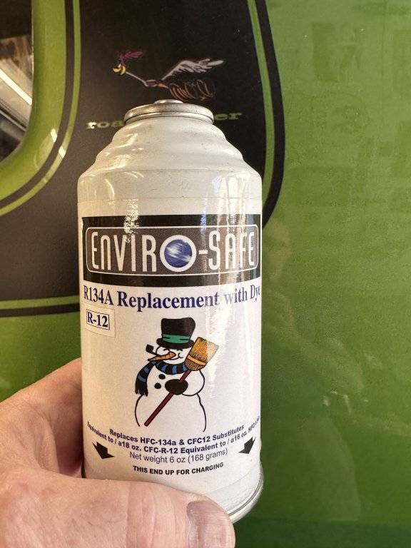

Does anyone know about this stuff. I bought it maybe 15 years ago at Carlisle, I think some cold beverages were down and I got talking to a supposed AC pro/snake oil sales tech. I just went through the chem cabinet and there sits 6 cans.
