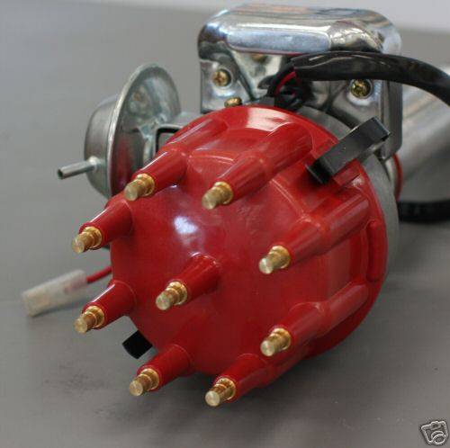

Checkout these new 440/426 distributors w/ integral electronics from skipwhite on ebay. $55.50 w/ shipping. No external box, but will need different spark plug wires. I think you can use Magnum wires (junkyard), which are nice silicone and numbered for each cylinder.
I bought the small block version for my Dart, but haven't installed. I currently use the older Crane Cams XR700 on my Newport and Dart, but requires an external box. Another popular one is the Pertronix Ignitor, since no external box.
