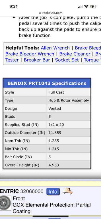

They are both 1.25” thick but the Buick is 11.86” in diameter vs 11.75” for the Imperial. They are both 5-5” bolt pattern and use the same Timken bearings.

I will order one and check it out. It’s like a 68-69 Charger where rotors are not available but they are for a Buick GS that has the same brakes.
I actually saw an Imperial with Buick wheels so they must fit.
That is a good find with a mere .055" difference in diameter.
I'm interested to see how the Buick hub positions the rotor within the Chrysler caliper.
