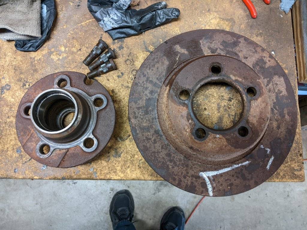

If I’m not mistaken the rotors are swaged onto the hub with the wheel studs. The hub is to be reused like with a-body Kelsey Hayes brakes.
So the Imperial inner wheel seal is .008 larger in diameter than the Buick. Cool.
Might order one to test and measure. I haven't found the Imperial wheel hub size yet.
The Buick rotors are one piece. Now I am looking at drums. I should be working, but have fallen into a rabbit hole of specs.
For 1969-1972 Fury, the disk & hub are two piece.
Every 1973 I have seen is one piece. May not be true for Imperial.
1971 Fury, 2-piece

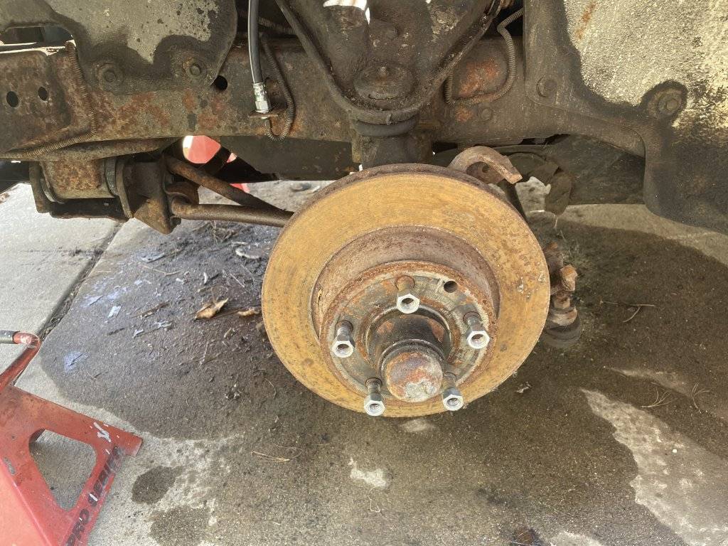

My 73 is a two piece rotor, but I will be happy to use a one piece rotor.

I appreciate your research on this. I knew there had to be a catch to this. It was too good to be true. If my rotors don’t clean up with a cut then I will worry about this.

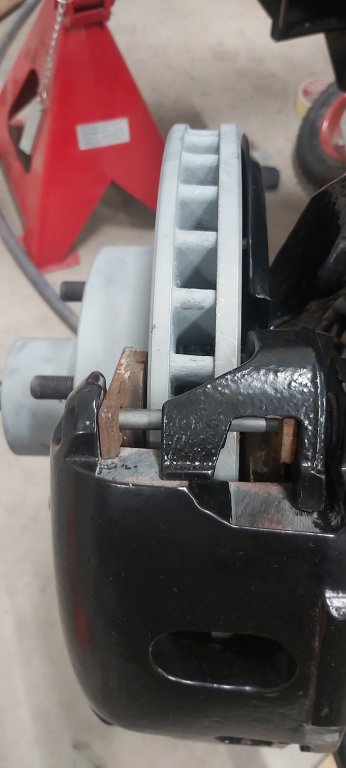

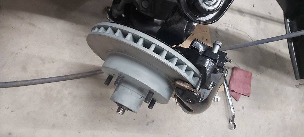

Little update guys, about this Buick rotors question, I think this could work. This is test with Raybestos 5006R rotors. I have -72 spindles and K-H brakes from Murray Park, right side rotor is ok but left is done, inner surface is badly damaged. So, I ordered parts and let the show begin...

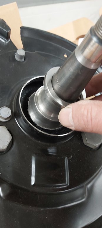

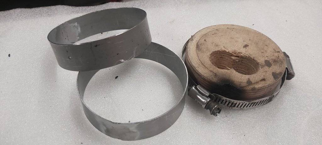

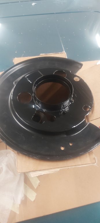

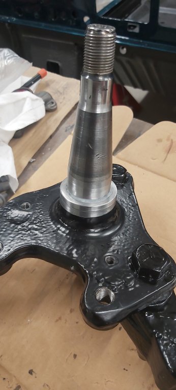

First measuring says only real concern is inner bearing, it's 5 millimetres outer than original. Now we need washer under new bearing, spindle have guide surface for bearing and fortunately there's room for washer and bearing. Seal will contact the washer so I thought I should glued the washer in place. 3M DP410 do the job, after gluing mild heating in 45-50 Celsius in one hour make glue much stronger than letting set in room temperature. Collar in dust shield must grind it down 2mm, other wise it will contact the rotor. I made new collar because it needs to be little bigger in diameter to fit with new rotor. Mopar Seal is little bigger than GM but there's no problem to get it into place. Rotor outer part what goes through the wheel is little smaller but there's paint anyway so no problem. I sandblasted rotors (not contact surface) and sprayed with zinc paint, paint manufacturer says paint will handle 500 Celsius!!... We will see that..
After installation ,I followed FSM instructions, I measured the surface run out and it's just under factory tolerance, 0.06 mm and 0.07mm, jeah, Chinese...

Thanks. What inner bearing number did you use? The 72 spindles are smaller than the 73. I hope to get a couple of cars out of here and try this on my 73 Imperial.
That makes no sense. Why would Chrysler waste time and money on making the 72 and 73 different?
If you check it out the both use Timken SET5 and SET3 bearings.
These are bearings what I used, like The_ Eagles_Nest said I think also that -72/-73 bearings are same, at least Rockauto give same numbers for both years.
