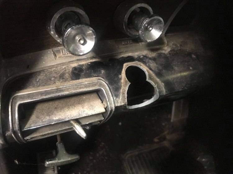

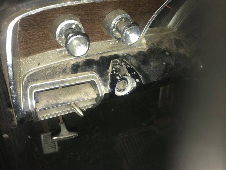

I have a complete cruise setup for 65 chrysler. I am going to install it into my wagon which did not come from factory with cruise. Curious if any one has done this and what problems encountered. Should I use the dash from parts car or drill out dash for cruise switch/knob
Use the best dash you have. If you have to make that hole a die grinder can finish it off just fine.
I'm your 65-66 C body Autopilot guy - PM me for questions and answers.
FWIW, the dash hole can be drilled out and finished with files - make a template from the parts car.
You're going to need a lot more than the switch from that parts car - the gas pedal pivot is unique, and you need to be aware of fitment issues with the servo if you've got upgraded dual res master cylinder. Make sure you grab all the specific brackets for mounting the servo underhood, and make a template for the holes on the inner fender.

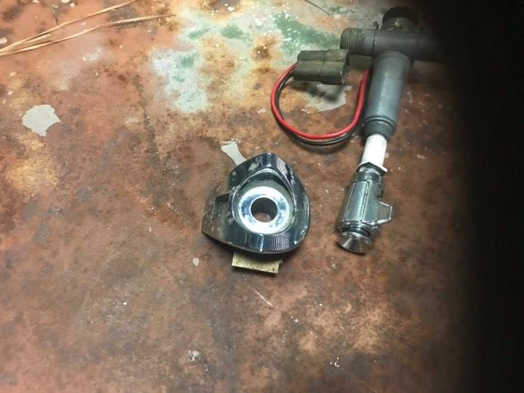

While the bezel you show is correct, the actual dash switch I see in your picture looks like a 64 and older, and is not correct for 65/66 AFAIK - in 20 years of refurbing these systems that's the first I've seen where the two were in use together, so unless something's been macguyvered, the dash switch will likely NOT fit the bezel and work together properly. On the correct 65/66 dash control there's a specific numbered dial that shows through the window in the bezel, which I don't see in your picture. If you don't have that you'll be guessing as to the speed setting even if you're able to get the bezel and switch to work together.
As well, the dash dial for all 65-66 C body Autopilot systems is prone to age-related failure due to a plastic gear set that cracks and falls away from the metal shaft. I rebuild the dash dials (I advertise in the WPC News) and get a few done every year for people. The other caveat is the electromagnet assembly that is part of the dash dial control is EXTREMELY fragile and if it gets broken, it's game over for the switch, at least in terms of what I can do with it. Coupled with the plastic mounting clip for the electromagnet coil that is as brittle as a potato chip and snaps by simply breathing on it, you've got a dash dial that needs careful handling to survive. I've repaired more than one clip with JB weld and metal reinforcement.
