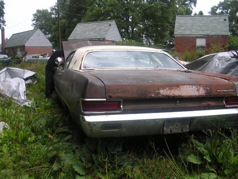

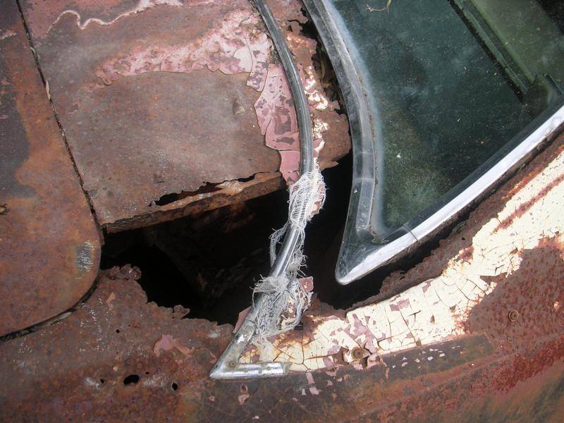

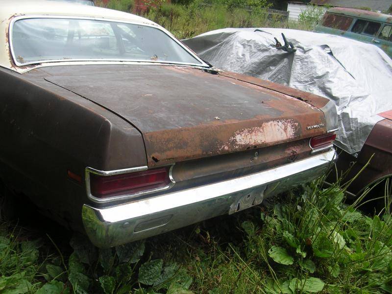

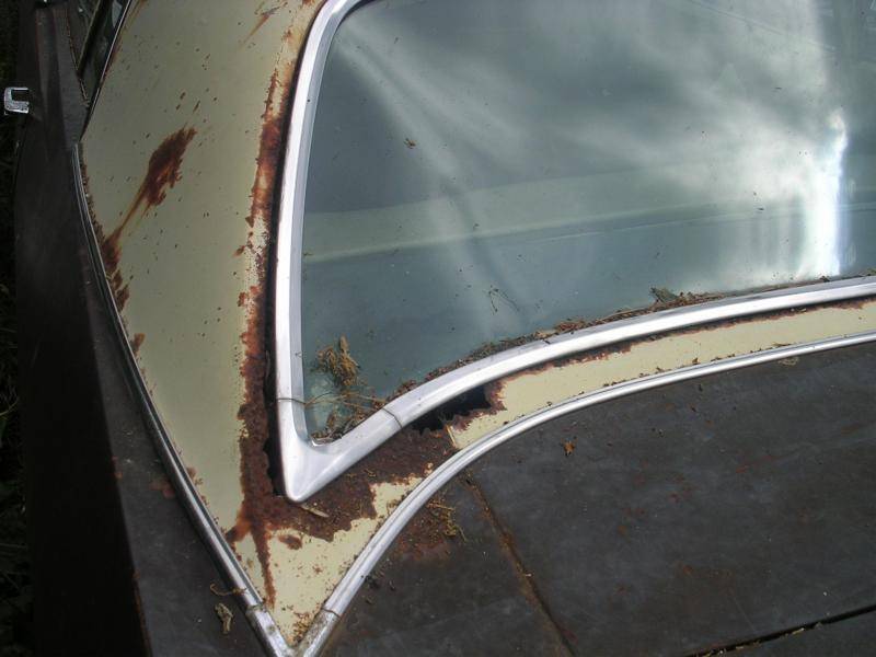

I need help from someone with a body book. Another member, Aidan1976, purchased a 1969 county police car thru me. It’s a PK21K9D. It is at my home in Virginia. As many of you know, it has a bad rust hole at the right side rear corner of the c-pillar. Since Aidan is in Australia, he could avoid a lot of shipping costs if we send patch panels with the car.
It looks like from my 1969 Chrysler Parts book that a 21 model has the same roofline as a 29 and a 43 model. I’m notsure, but I believe that a 1970 or 1971 21, 29, or 43 might also provide a patch panel. Can anyone tell me whether 21, 23, and 43 model cars for the years I mentioned will provide patch panels for the area behind the roof, even if the panel has to go all the way across?

As far as fabbing panels, my information is dated. I had a 1969 Monaco 43 Body, with rust across the bottom of the rear window. The rust created a 3" slot under the rear window and also destroyed the lower panel between the front of the trunk lid and the bottom of the rear window. The upper panel in the same area was largely intact. The body man who did my car asked a repair panel. Per his instructions, I called a junkyard on Florida and the owner cut a piece from a 1969 Fury 2-door. The piece extended from the front corners of the package tray along the inside of the c-pillars and back to the front corners of the trunk. I paid for the piece and had it shipped to the body man who then finished and painted my car. This was 17 years ago.
In this case of Aidan's 1969 Fury, it would be better for the bodyman to fab panels? I'm still learning and I was wondering why. I was thinking that an L shaped piece needed to be cut from the right rear corner of the trunk to the center of rear window.
There is enough parts cars that come through here to know the answer is yes. I've seen NOS Dutchman's on e bay.

Iam thinking a whole roof with rear quarter legs, dutchman panel, and pass rear quarter.
That rust looks pretty intense. Did he buy it to make a conv. Out of it??
No, I like the car and just want to save it. It's a fantastic piece of US Automotive history, and pretty unique, so I think that it is worth doing.

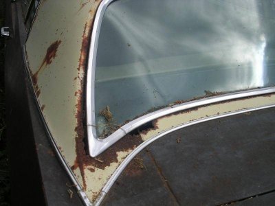

The top of roof really isn't bad. The car did not have a vinyl top. It was two tone paint. The top of the roof is not porous. It doesn't have all the vinyl top pin hole rust. I was thinking package tray and Dutchman as a cut out and then right side quarter leg all the way back. Left side is not nearly as bad. Car must have been leaning right and down at the front so water could pool against rear window on right side.

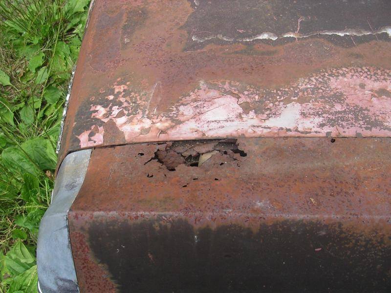

Looks like the trunklid has some swiss cheese also....... Its better to source rustfree metal in the states and send with then pay international shipping for large body panels.
