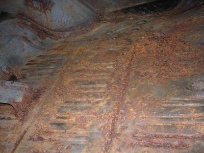

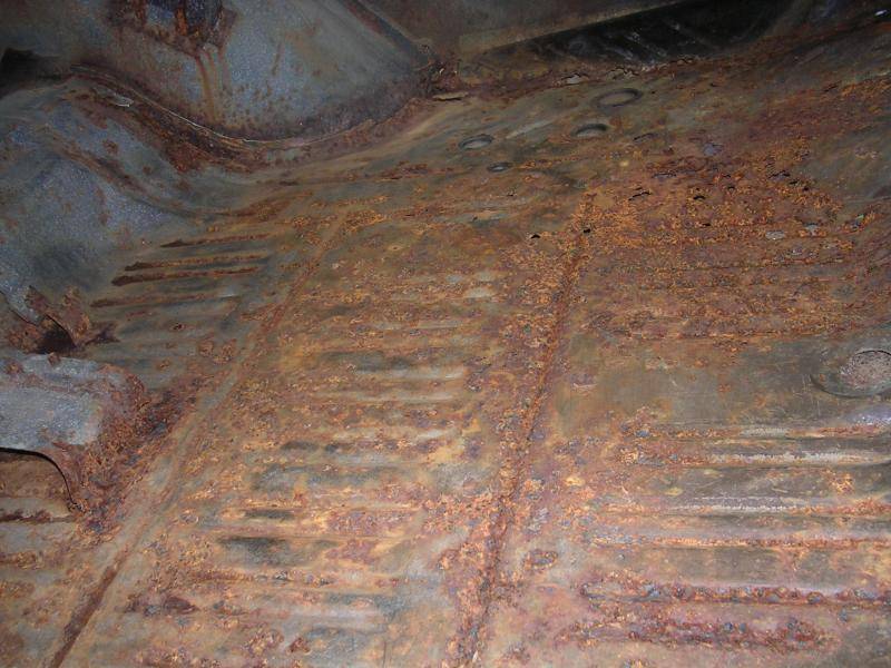

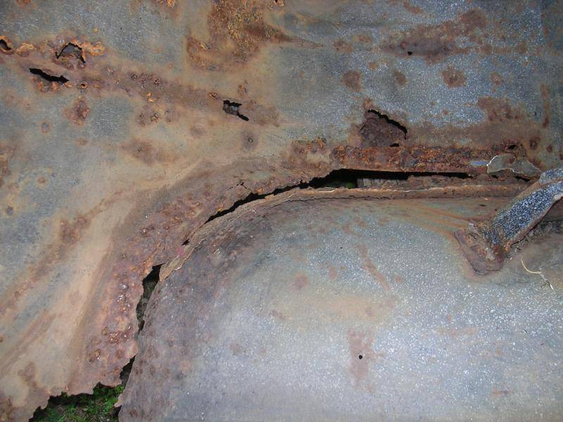

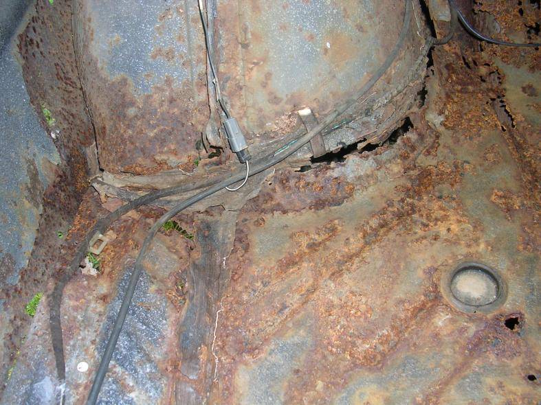

For those concerned about frame, the frames look solid and without rust holes except for one half dollar-sized hole at the extreme right rear. Rear spring perches look good. The rear floors are soft at the outside, but solid in the middle and on the inside. The front floors have rust holes, but aren't soft. Because of the way the car was sitting, trunk floor rust is concentrated at the outside behind the wheel wells and in the trunk extensions. The trunk floor between the extensions is surprisingly good. The below are trunk floor pictures. The rubber floor mat is apparently too valuable to disturb for pass floor pictures. I need the car in my garage on jackstands for frame shots. Those will have to come later, if at all. I did a lot of things to help as far as cleaning, a locksmith, making the car a roller, etc. All I have left is to put Aidan's wheels and tires on when he gets them to me. The car may not need to go in the garage at all. Since it would have to be pushed up a small incline, that's OK with me. Hope this helps the friends at for c-bodies understand, Ben
View attachment 37347View attachment 37346View attachment 37349View attachment 37350

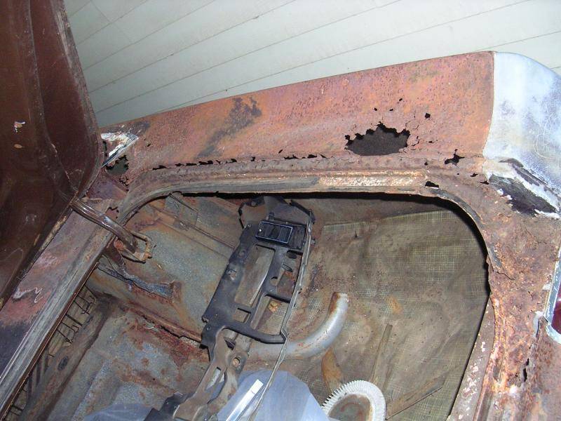

Frank Parks, 706-857-2832, Summerville GA has a yard of c and a body cars. Without looking at a body book, he says the area to the right and left of the trunk lid is the same for all c-body cars 69-71. He believes that the dutchman, c-pillar areais unique to 2 door sedans, so different than 2 and 4 door hardtops. Like Commando 1, he recommended fabrication in this area rather than replacing this area. He mentioned body books, but we had a verybad connection. He was hard tohear. I gave up.
I also have tried both to email and phone Murray Park in Ohio, without response.

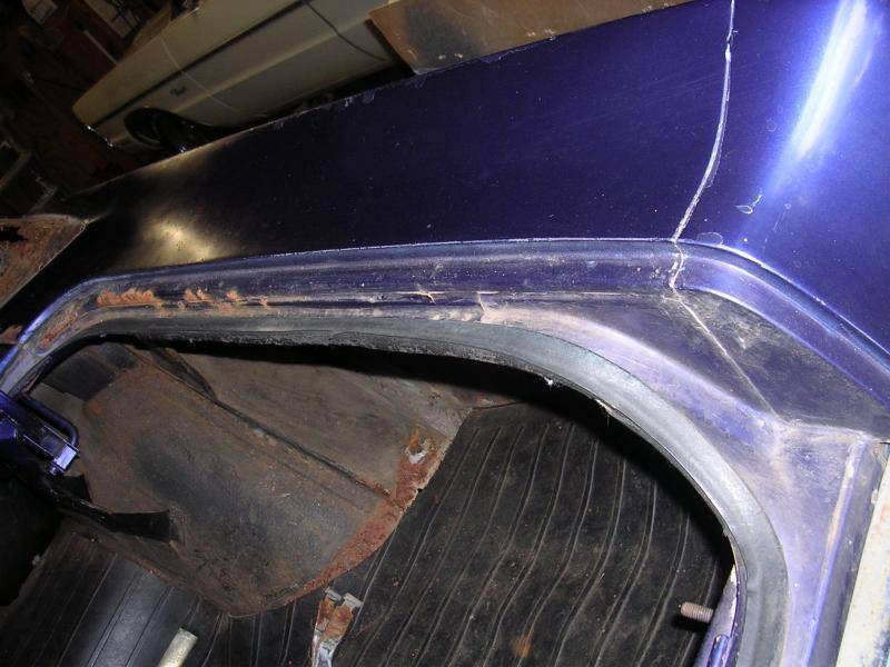

Maybe the best plan is a cut out from the front of the trunk lid back and metal fab forward of the trunk lid. The purple car could provide the cut out. Obviously, the trunk lid will have to be replaced. I'm going to post a want ad for one in the Virginia area. As far as the weld joint for the cut out, a question would be, is it best for the body man to make the joint in the upper quarter or on top in what one member called the quarter leg? Thanks, Ben
By the way, I contacted C-body Bob in NC about the trunk lid from that red 69 PH23, but he has already sold it.
may have left side nos patch from quarter to top for ya depending how quick ya want it

been busy the last year. Got the two quarters offa ebay. Probally last ones out there anyway are for the gt. Can use most of the quarter however rear widows diff so will section the quarter and top part is useless to me. Anyway looks like fella here could use. Just end up throwin it out. Hate to see go to waste when someone else can use
