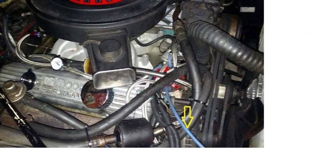

I noticed a slight miss at idle ever since putting the car back on the road after getting my disc brakes done. Tonight it got worse, way worse. I fired it up in the driveway and the engine sputters on and off at idle speed....almost sounds like a big choppy cam. Backing down the driveway and putting it in drive it almost cuts off until I give it some rpms. Ditto at the red light. It seems to smooth out at higher rpms (but still feels rough). I have a spare coil/VR/and even ECU laying around...so I guess I'll try one part a time. I can't find any vacuum leaks topside. Missing anything?

Where does your vacuum hose for the booster connect? How old are the spark plugs and wires? Are the spark plug wires in wire holders so they are away from anything hot? It sounds like you have a ignition miss and the cause is usually a plug or wire that's the reason for the above questions.

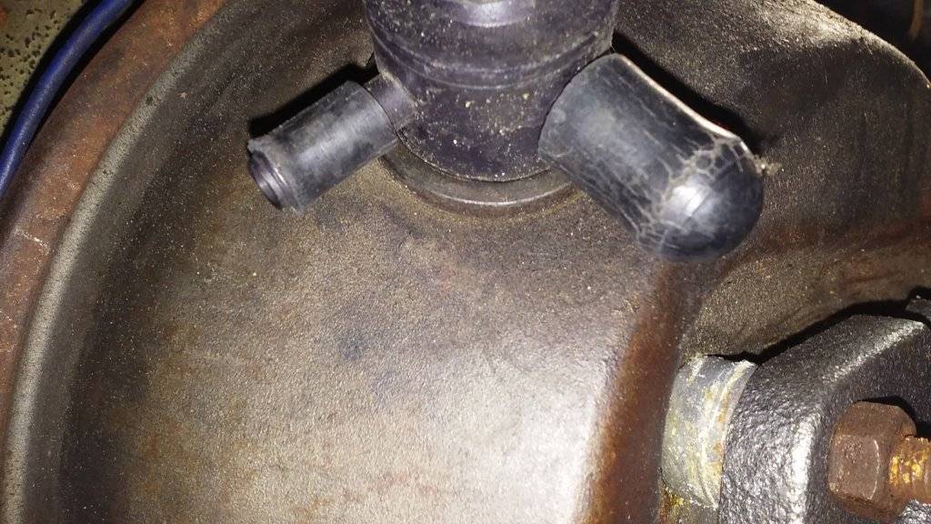

Ok. Think I found it. The head of that nipple was so dry rotted that it just crumbled when I touched it lightly. The big one looks dry rotted also...heat I suppose. I've got fresh extras laying around......hope that's it.
Ok..so that took care of the miss...totally gone. On the way back from the drive however, the engine backfired through the exhaust and cut off. I pulled off to the side of the road and came to a stop. I pumped the gas and turned the key and it started right up again with no problems all the way home. Backfire through exhaust is a dead cylinder?...which in itself is a symptom of a larger problem. Had a similar problem a long time ago with the same action...backfire and shutdown. Turned out to be crappy MP ECU.

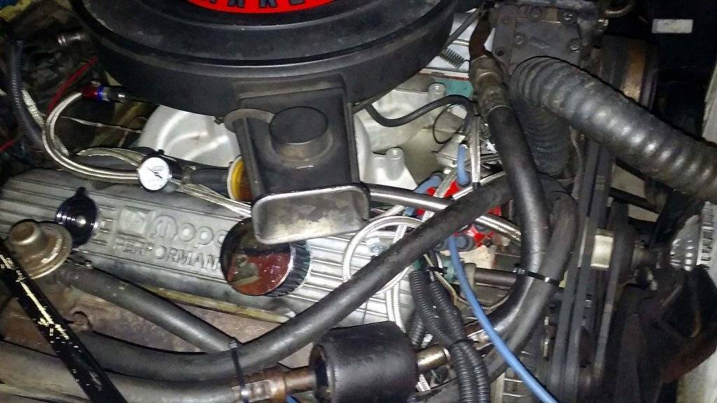

Whats going on with this coil wire? Do you have the coil mounted on the fenderwell? I'd shorten it up and put the coil back on the engine. It's too long and the vibration etc. from the engine will damage it. Yea, I know, race cars sometimes have the wire like that, but they are using solid core wire.

Whats going on with this coil wire? Do you have the coil mounted on the fenderwell? I'd shorten it up and put the coil back on the engine. It's too long and the vibration etc. from the engine will damage it. Yea, I know, race cars sometimes have the wire like that, but they are using solid core wire. View attachment 82353
YeH, its on the fender wall. I went thru two coils until I found out they want to be cool (as possibly can). I put third one on the fender and BINGO. No more dead coils. I drive my car a lot, everyday in fact. I could move it closer (shorten up the wire distance) but I don't think it'll make that much of a difference, PLUS that places it closer to the exhaust manifold (more heat). Nope, I gonna stay where its at.
