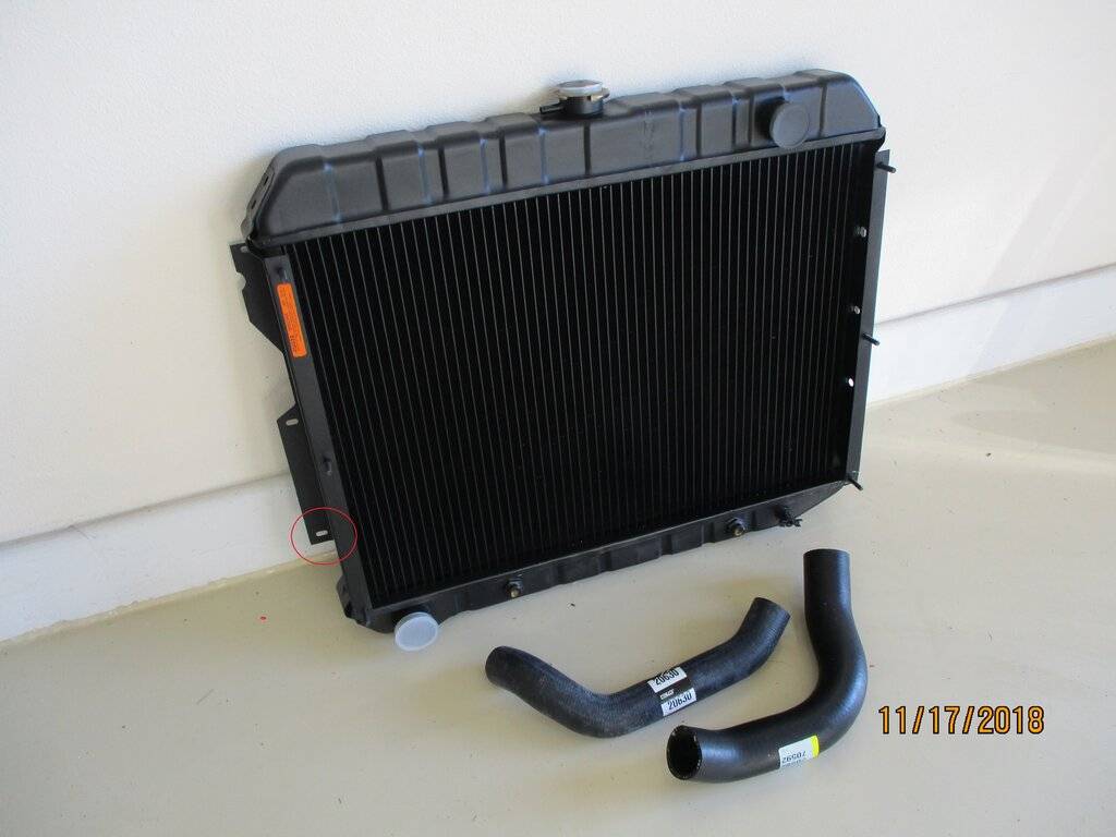

That's odd.....I used the GAT 20630 (with my Spectra CU332) and it fit perfectly. Lower was Dayco 70592, BTW.
You could probably use a reproduction '70 B-body 26in rad hose set on the car. I know the C-body 22in rad hoses are the same as B-bodys.

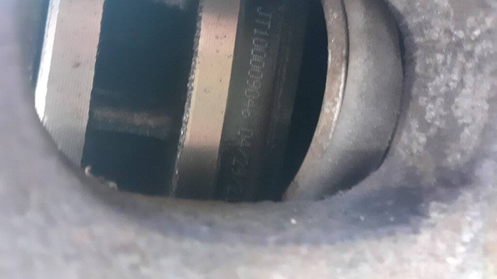

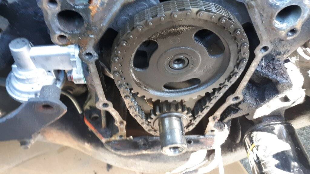

The car's timing chain was not original (it was metal, see pics below) but it was very worn out. From disassembly, David figured out that things had been opened up once before -- ultra black sealer having been used at the base of the timing cover, as well as steel-reinforced foil pan gaskets having been installed. Not available in 1970 for either.
Good news -- David just told me the "engine came apart very clean inside considering the mileage involved." So far, so good!

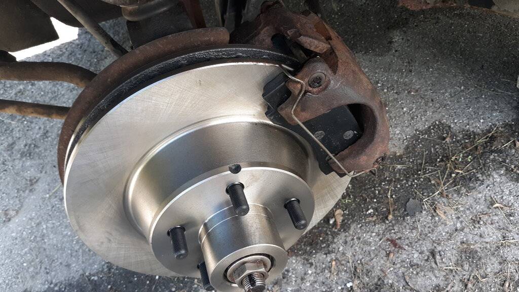

Latest update is the installation of new front brake rotors Raybestos part #7012R. Fit like a charm rotor dimension are spot on. Master cylinder and brake hoses are next. There been questions on fitment as the photos below show, a perfect fit. The fan shroud was a bit difficult, once installed fan clutch oper. was spot on.
Thanks for the update David.
I am glad they seem to meet your specs. They, however, do not appear to be the two piece rotors, rather they look just like the one piece Centric rotors. Did the boxes indicate where they were made?
While some tout the old nos rotors as superior to the "Chineseum" ones, the Centric rotors are advertsied as having a high carbon steel content. This makes them much stronger and more wear resistant than the mild steel that was used in the original heavy two piece ones made 50 years ago so they don't have to be two piece very heavy outdated designs to be strong. I am very happy with the Centric rotors on my cars and no one has commented that they do not look original yet probably because they are hidden from view pretty well :rolleyes:.
I don't mind not having to pay a heavy premium price for heavy rotors that aren't as strong/wear resistant as the ones available now and the new ones are apparently well-made to strict tolerances from what we see from David's measurements and can't be seen readily anyway when on the car. They also brake just fine with the new materials including non-asbestos pads that turn your wheels black, needing frequent cleaning. Since the new rotors are less bulky they don't store as much heat and they dissipate it much more quickly as a result too. That is a big plus on long steep downgrades where braking can be more of a challenge on our older heavy cars.

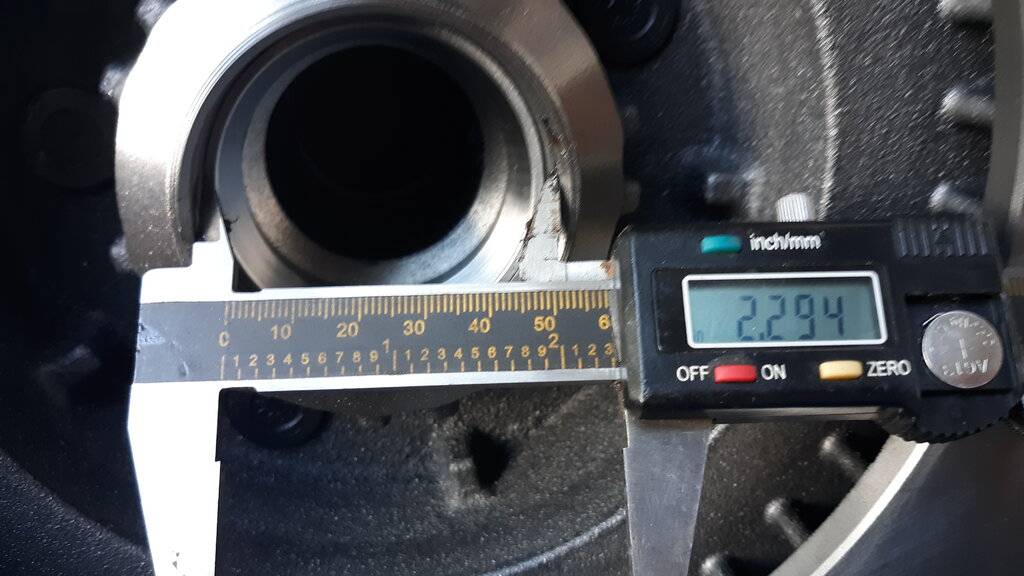

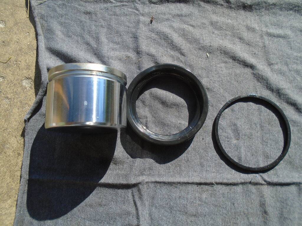

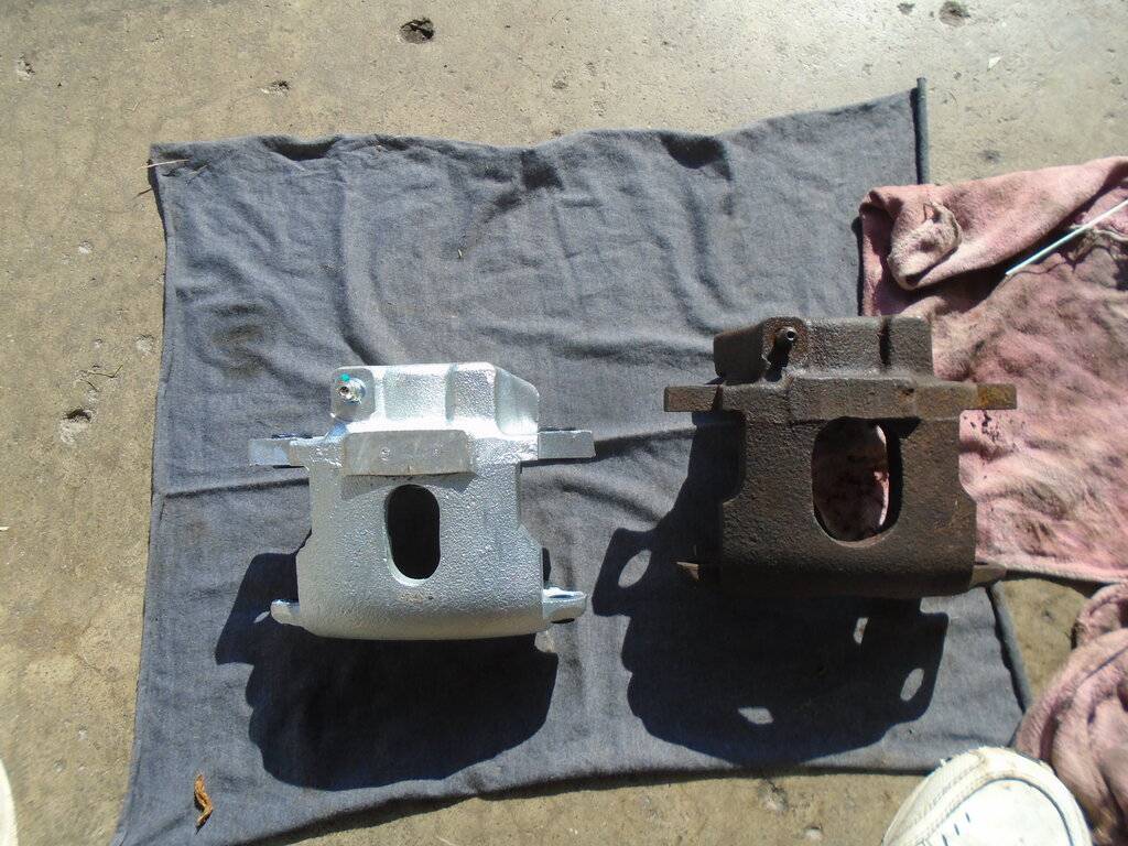

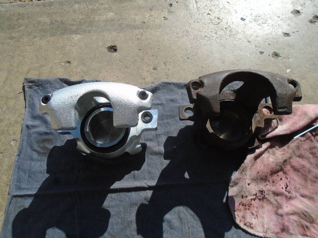

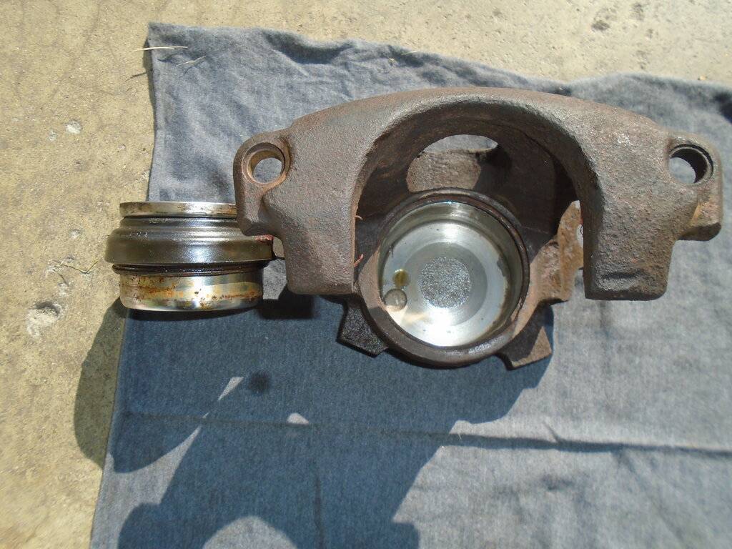

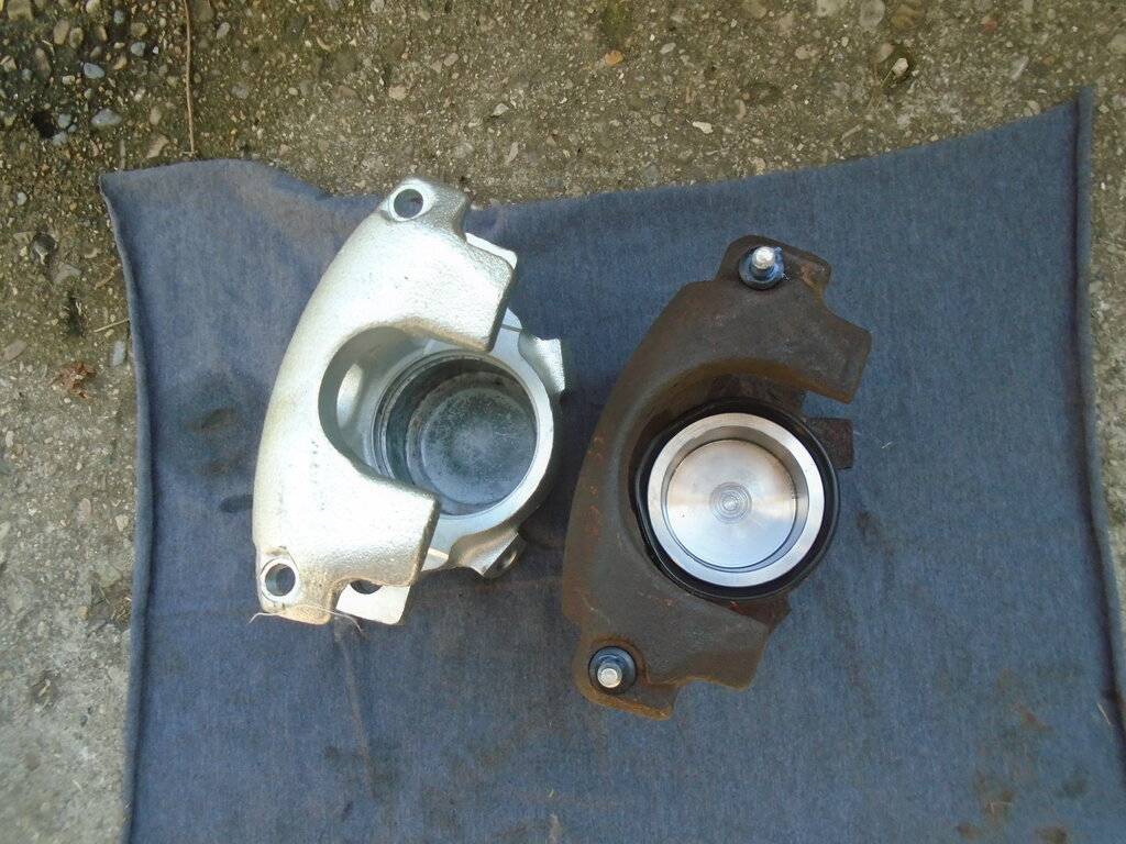

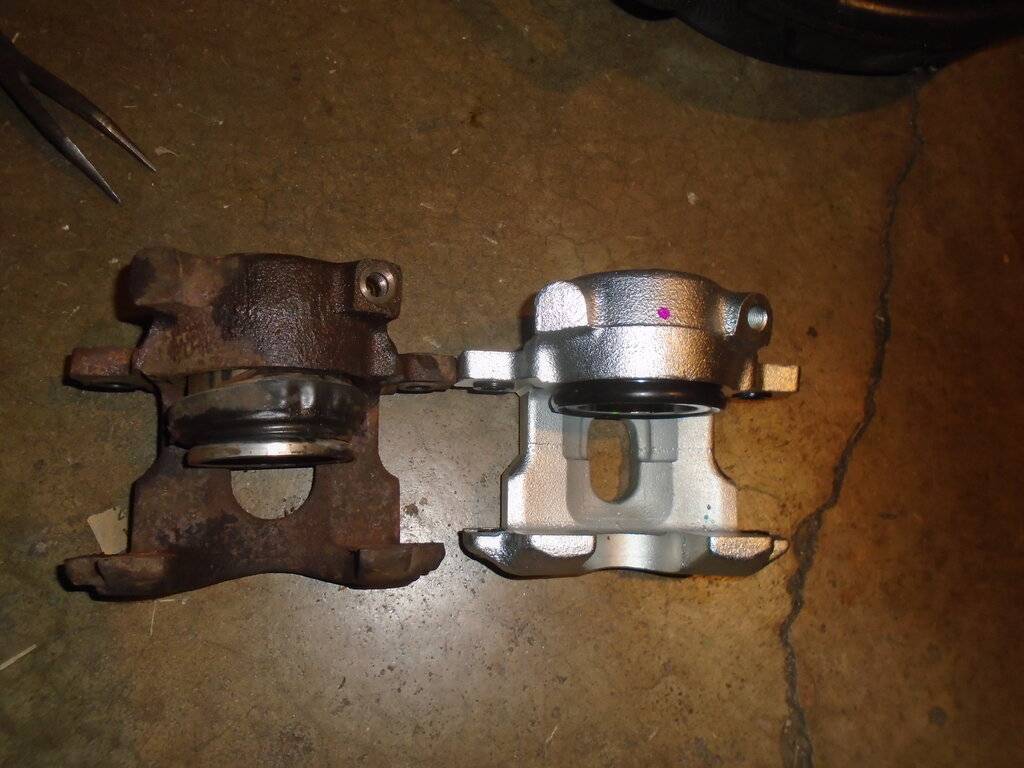

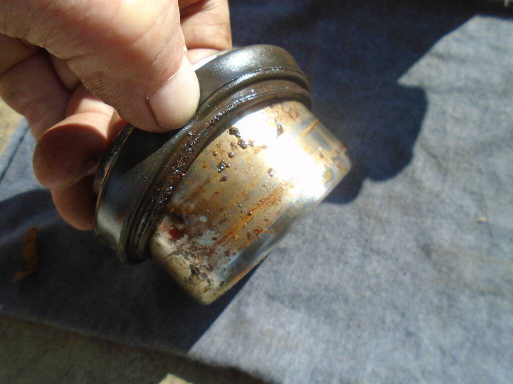

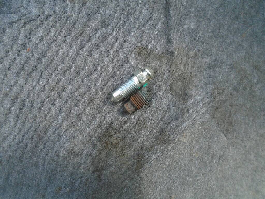

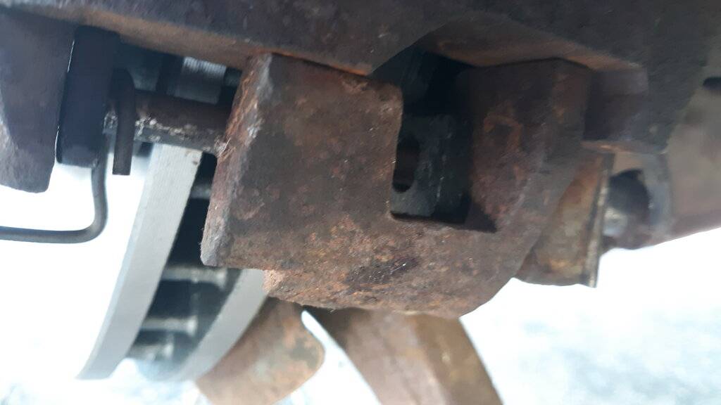

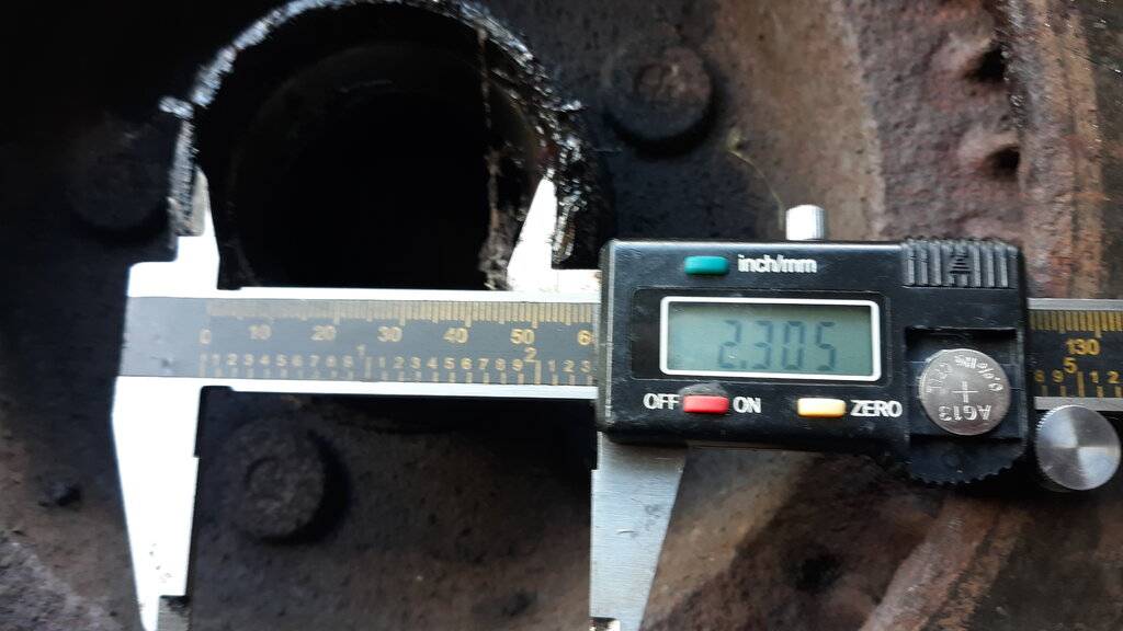

Here is the conclusion to the brake restoration. Both brake calipers were in dire need of rebuilding. Photo's below show the evidence of rust build up from long time storage. As many of you may have experienced seal kits and caliper hardware are the only parts listed for C bodies. Upon further investigation I found that 1973 Dodge Challenger brake calipers use the same caliper piston 2.75. Hardware is exactly the same as the 70-73 C body brake calipers. At the time of the calipers rebuild no caliper pistons were available, however I was able to acquire a pr. of 1973 Challenger w/ the 400 eng. option. I completely disassembled the Challenger calipers and used the pistons, seals, dust boots, and hardware on 1970 300 caliper cores. Broken bleeder screw was removed w/ a blow torch, vise grips and a table candle. Not the easy way to do it. After bleeding brakes and a test drive. perfect front brake action was restored.

In this case, robbing the new parts from the rebuild to fix the old is brilliant.

In this case an old Motors Manual and a veneer caliper was I needed, plus having rebuilt several E Body calipers and remembered there bore size was 2.75 inches

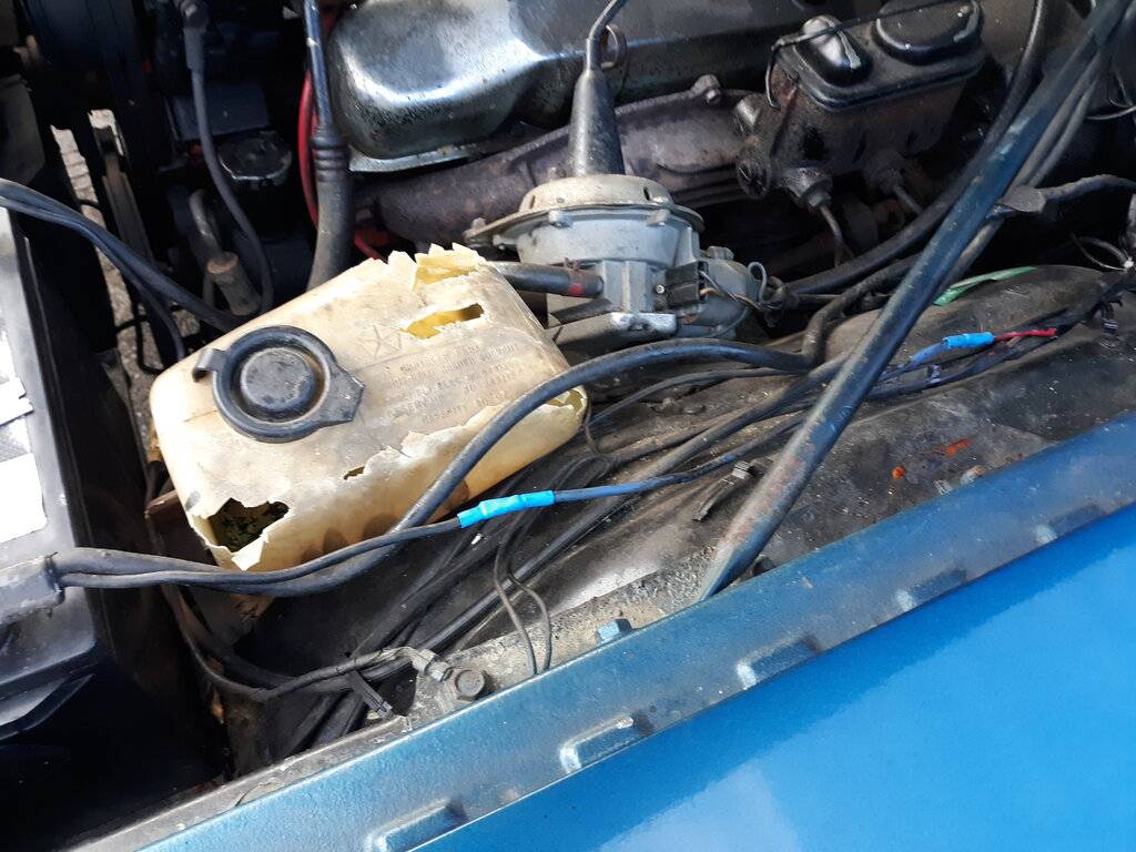

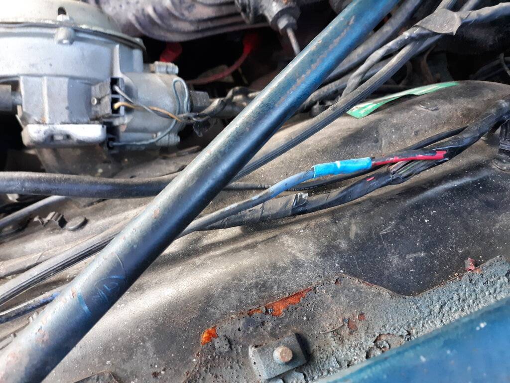

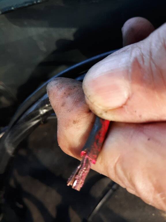

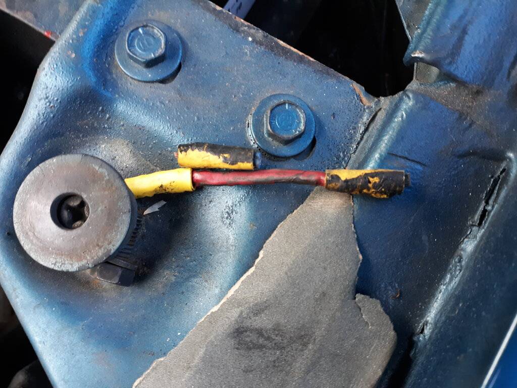

Yet another repair full of surprises. The MOPAR replacement voltage regulator was painted in a heavy coat of black. Were talking powder coat thick. A little fiber disk work took care of that. Reassembly and a quick restart reveals a higher than expected alternator amperage out put. Volt drop tests showed significant voltage drop loss between the battery and the main Bat splice for the alternator. The removed unions below accounted for a .574 volt drop over a 12" area next to the battery all repairs were soldered and shrink tube covered. See photos below. All is back to normal.
Yet another repair full of surprises. The MOPAR replacement voltage regulator was painted in a heavy coat of black. Were talking powder coat thick. A little fiber disk work took care of that. Reassembly and a quick restart reveals a higher than expected alternator amperage out put. Volt drop tests showed significant voltage drop loss between the battery and the main Bat splice for the alternator. The removed unions below accounted for a .574 volt drop over a 12" area next to the battery all repairs were soldered and shrink tube covered. All is back to normal.
Don't you just LOVE surprises?
Similar situation for me. Old, crappy splices made the VR think the voltage was too low, so it "regulated" the alternator to crank out 16+ volts. As David did, solder and shrink tube (and correct repro cloth-like electrical tape) made for a nice mid-13s charging voltage.

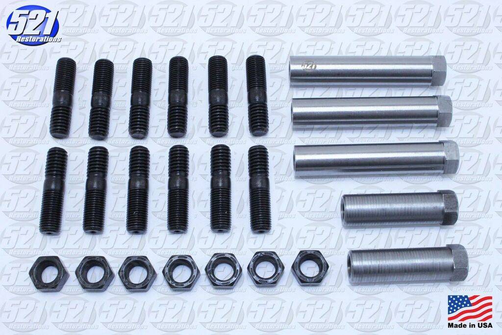

David also will be installing new manifold cover gasket. I bought the last 1968-71 Big Block C-Body Exhaust Manifold
Fastener Kit (for HP BB 383 440 engines) from 521 Restorations on eBay to that effect:
I also got from Summit three Mahle F5561K exhaust pipe flange gaskets, and a Fel-Pro MS90029 exhaust manifold gasket for U-code enginess
