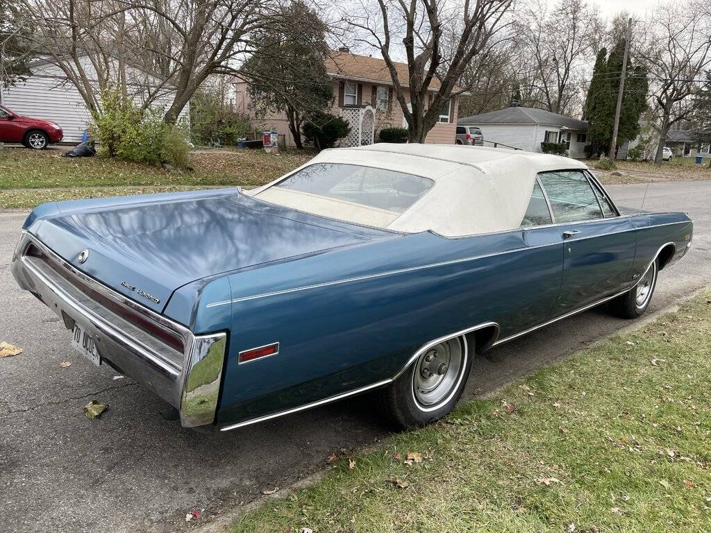

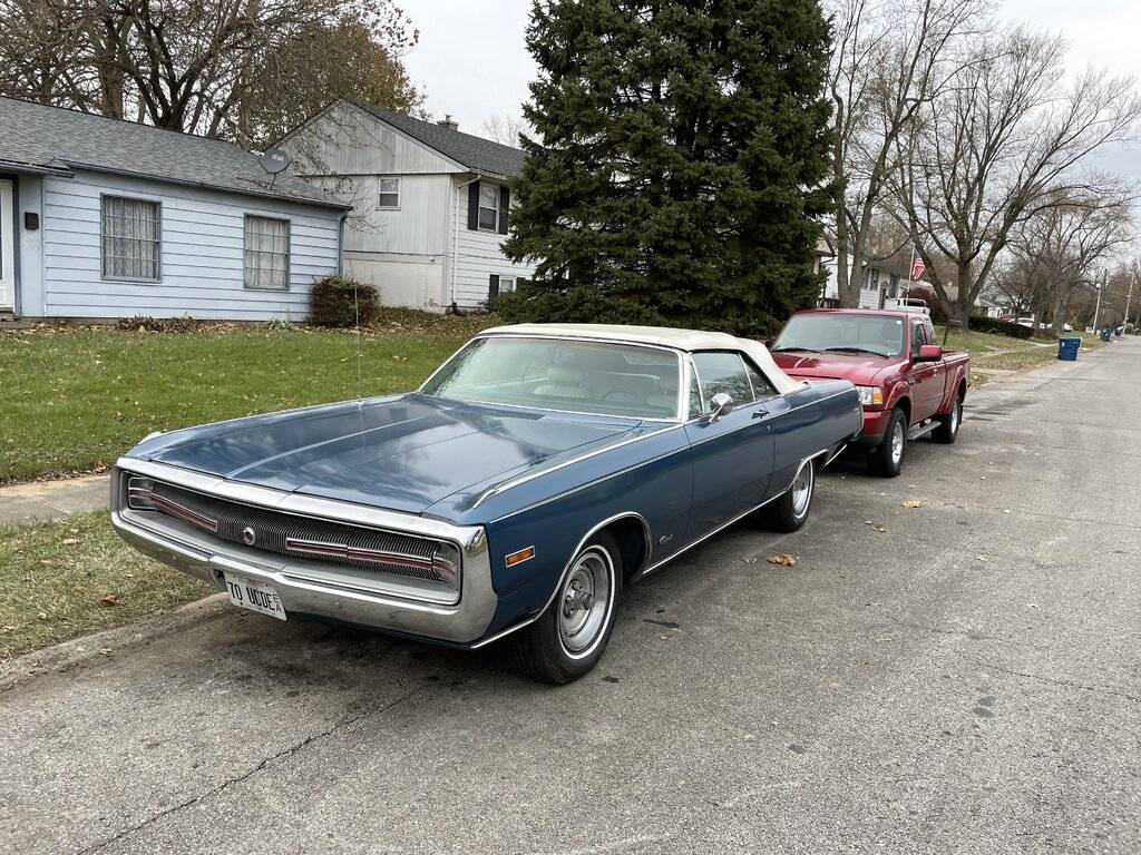

All right, as @Ripinator would say, we like pictures here. Let us start with the Chrysler when David and I met late this afternoon.

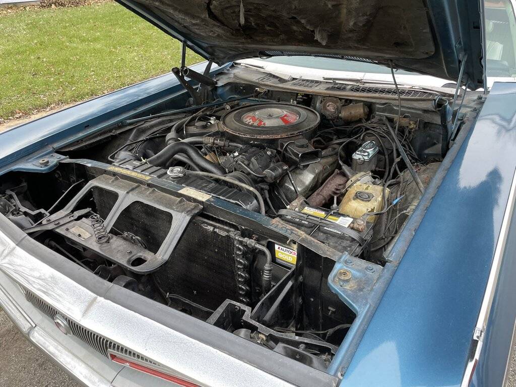

David did not "only" fix the engine / transmission / brakes / suspension, he also cleaned up the interior and the engine bay. And some other stuff, hidden from sight too...

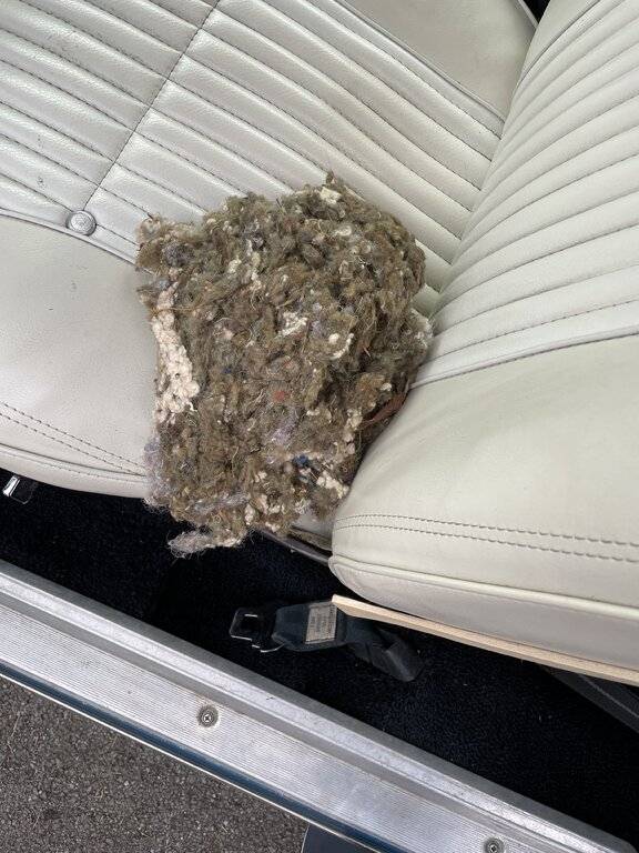

The air flow in the heating system was poor when David got the car back to driving condition. He found out why when he started investigating earlier this month. The fuzz ball below shows just 1/3 of what he found. Luckily he did remove the obstructions, and so I got good heat inside the car on the way home. Good thing as the temps outside were in the low thirties by nighttime and the wind was blowing hard (the car was very stable at speed despite the wind).

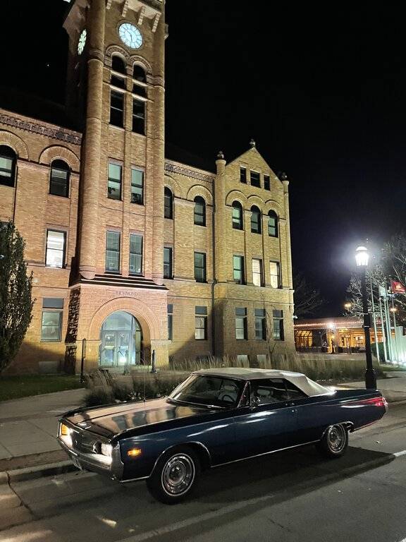

I stopped by in time for dinner, and found a nice building nearby to end this little story.

The air flow in the heating system was poor when David got the car back to driving condition. He found out why when he started investigating earlier this month. The fuzz ball below is but 1/3 of what he found. Luckily he did remove the obstructions, and so I got very good heat inside the car.

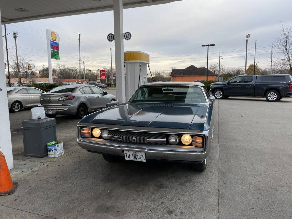

After David and I had chatted and parted ways, the first thing I did is go to quench her thirst for 93 octane. Yes, the tags are custom -- I could not resist...

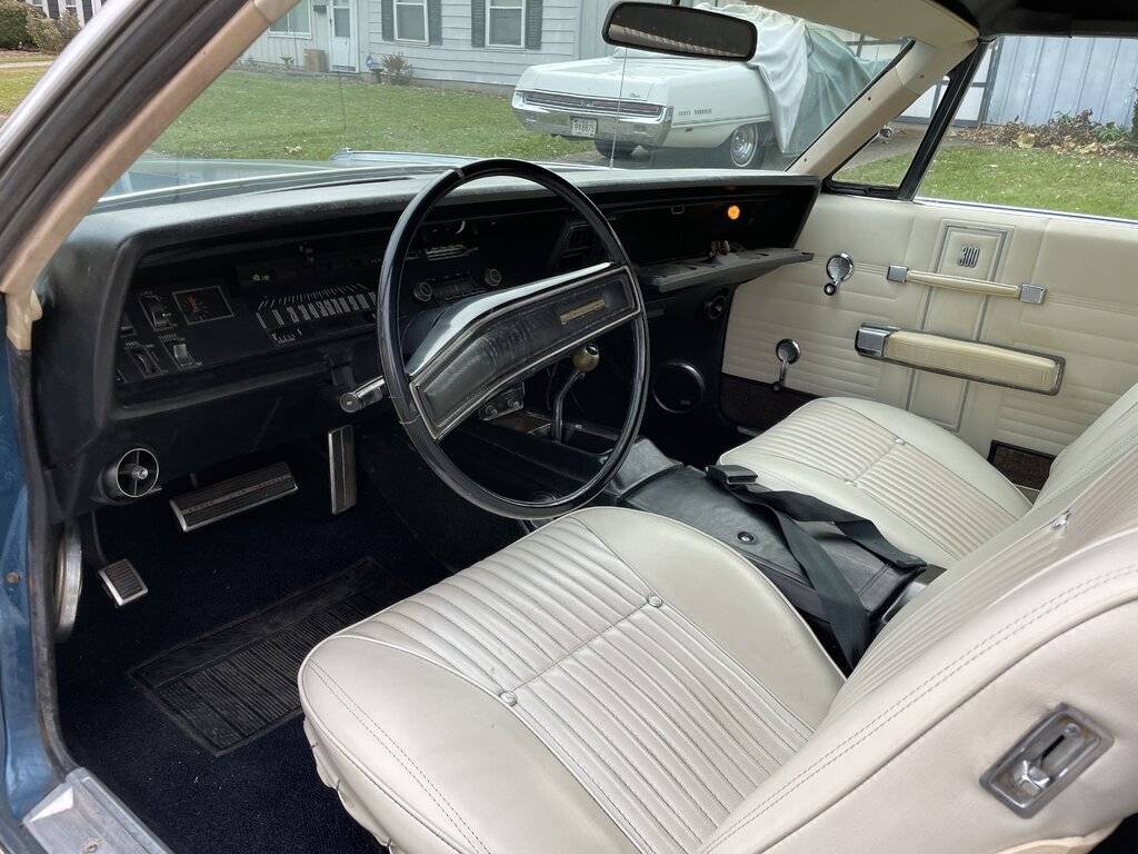

Here is the last update for 2021. After the initial test drive two problems were evident. No airflow from the heat - defroster ducts and no dash lights. The transmission shifted ok, but was sluggish on first startup. Removed the RT. front inner fender and removed the blower mtr. Below pics show the mouse nest packed into the blower squirrel cage and engine side blower housing.

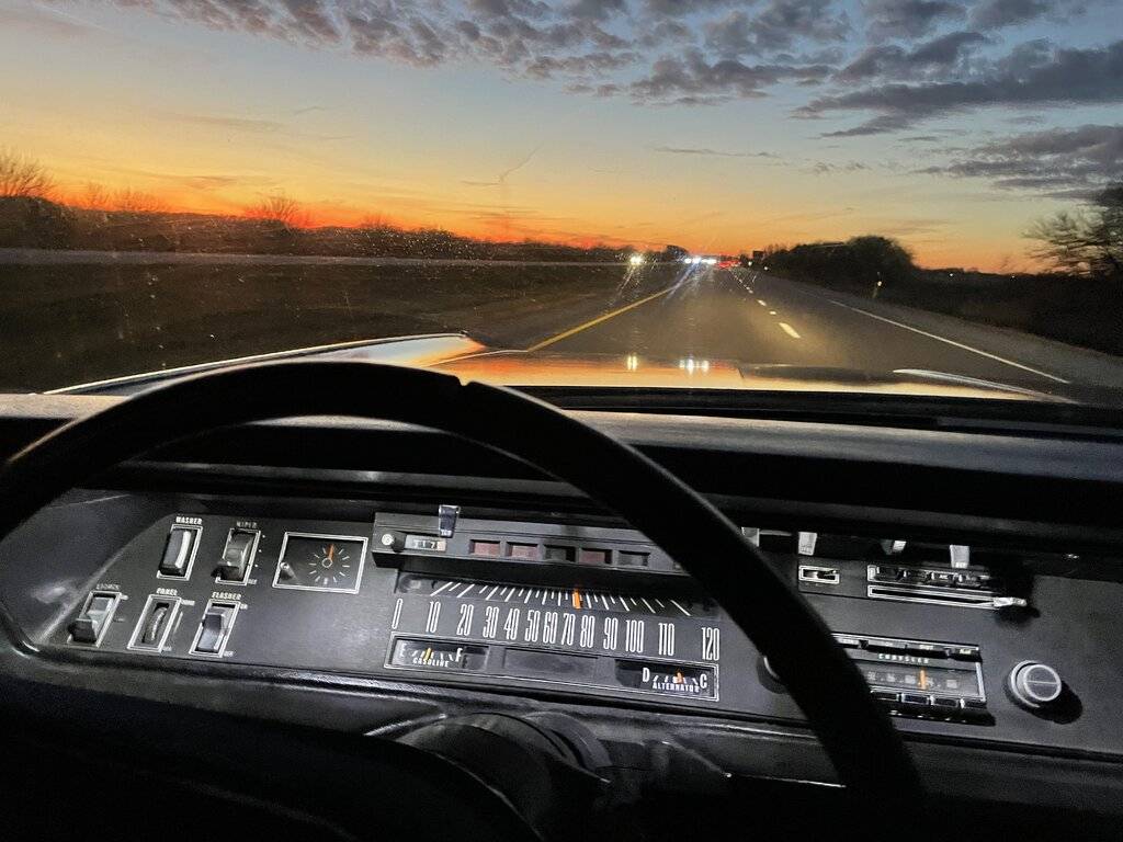

Are the dash lights stock, or something more modern? They look very bright.

One of my biggest complaints with the 1970 Chryslers was that the dash lights were never bright enough. The LEDs sure fixed that! Are those LEDs dimmable?

LED courtesy of @david hill (see here).
The impression of brightness in the photo is an artifact of my phone camera's low-light algorithm. It is white but not too bright (and I hate bright lights on dark country roads -- no issue here, yet perfect legibility).
The dimmer switch does not work, and I'll be looking to get an NOS unit this winter. But that is only for "customization" possibilities, because even in pitch dark these LED lights were not bothersome in the least. The solution by @david hill is great.
The dash lights were repaired in post#100. New problem came up when the dimmer took a dump the day after I posted. By pass the dimmer as a correct replacement could not be obtained before pickup. Led's draw little amperage so I am comfortable about by passing the dimmer switch. The transmission fluid change was surprising as there was no heavy metallic buildup or friction material I would have expected. The photos below show how dark the fluid was. Torque convertor was also drained. The trans pan condition exceptional, even the metal # stamping is still visible. Finished off the job w/ a aftermarket silicon reinforced pan gasket and refill. Test drive reveals perfect automatic trans operation. This TNT Chrysler 300 has the potential for a full blown restoration. Still more work to do next spring, Road worthy now.

I trust that they would be fine even at night. I was just asking because some LEDs are dimmable and some are not. I have so far not seen any LEDs in that application that are dimmable, hence the question. Maybe David can elucidate.
Edit: I see David posted on my question just before I entered my post - maybe we will know later regarding my question when you get a new dimmer switch.

Yes they work well existing OEM dimmer used. Have used them on my 69 300 w/ no issues. properly installed
The air flow in the heating system was poor when David got the car back to driving condition. He found out why when he started investigating earlier this month. The fuzz ball below shows just 1/3 of what he found. Luckily he did remove the obstructions, and so I got good heat inside the car. Good thing given the temps outside were in the low thirties by nighttime and the wind was blowing hard.

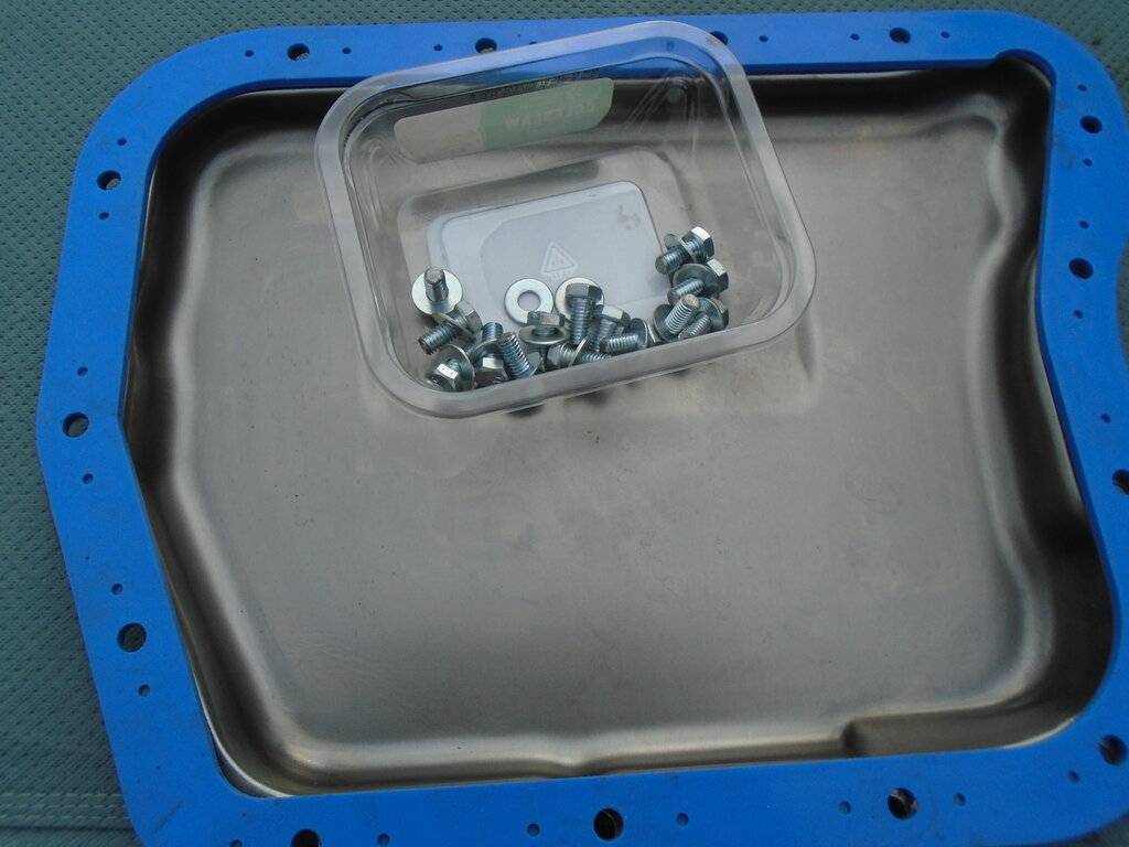

2. For the trans service, I followed David's advice on the ATF and went for Valvoline 773636 DEX/MERC transmission fluid. It was much cheaper at Walmart than at Summit, so David bought 12 quarts locally. From Summit, I bought WIX 58707 transmission filters ($11.99+...). The WIX 58707 filters are sold as a package with gaskets but, while the filters get great reviews, the gaskets show they have problems so I bought a Moroso 93110 transmission pan gasket ($32.99 + T/S/H) from Summit (as for my other C-bodies, as recommended by @sixpkrt and @71Polara383).
