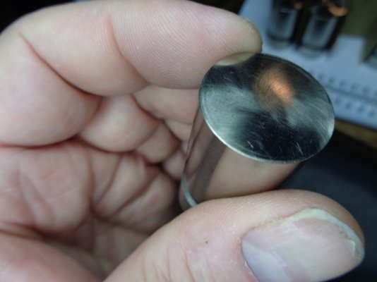

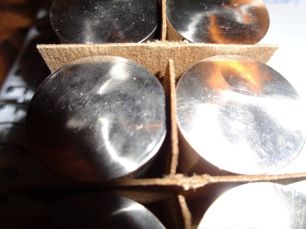

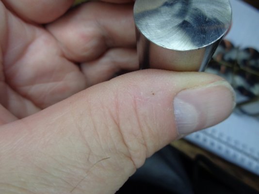

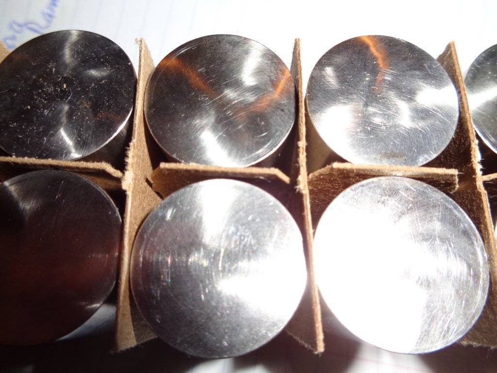

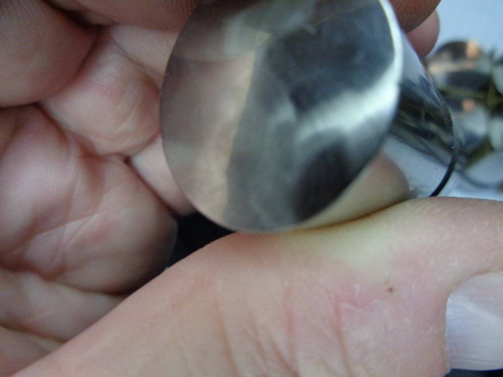

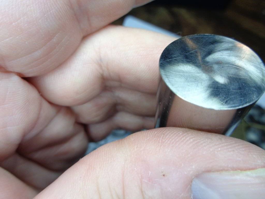

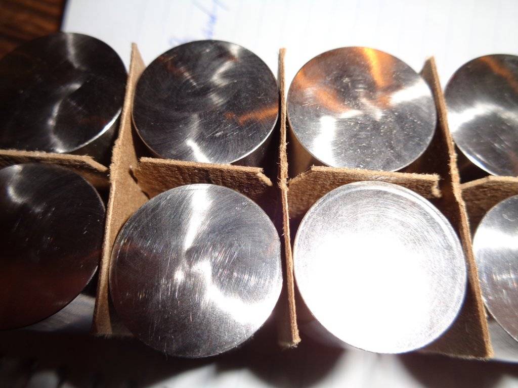

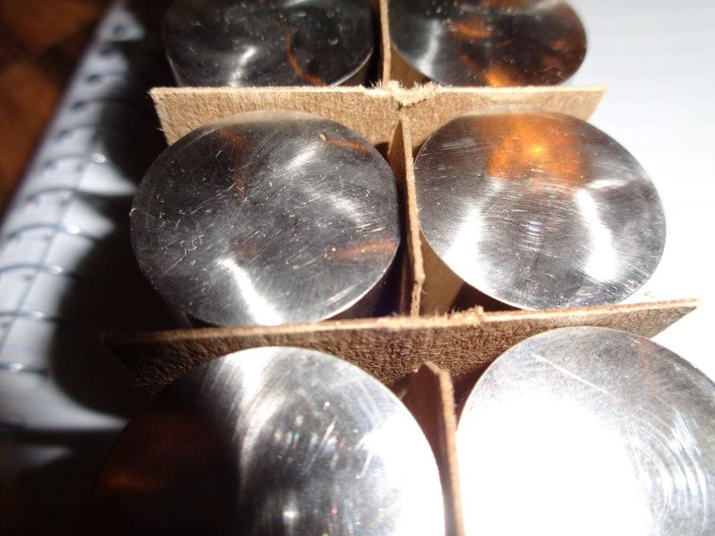

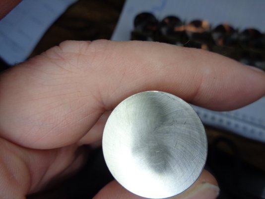

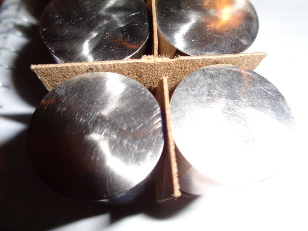

You can check the taper on the cam lobes with a dial caliper and check the base of the lifters for crown with a pocket ruler. If you see something suspect, don't use it. And like @Cartel mentioned, easy on the springs during break in and watch the video he posted. I like to ball hone the lifter bores to make sure the lifters spin freely. Easy to do when machining the block before clean up and assembly. If re installing a cam in the car, lube everything up real good and turn the engine over by hand a few times to make sure the lifters spin in their bores.
