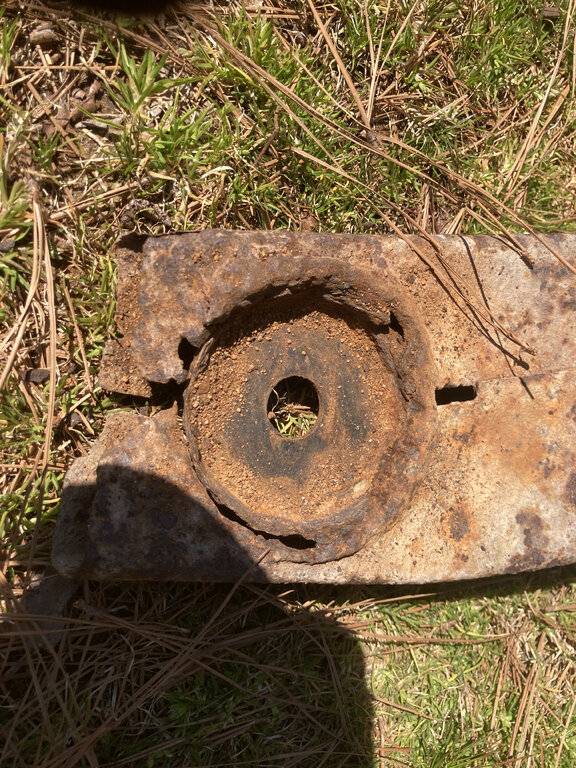

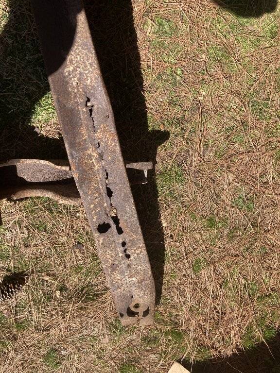

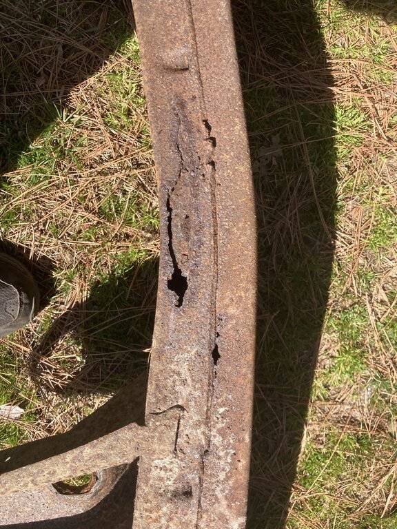

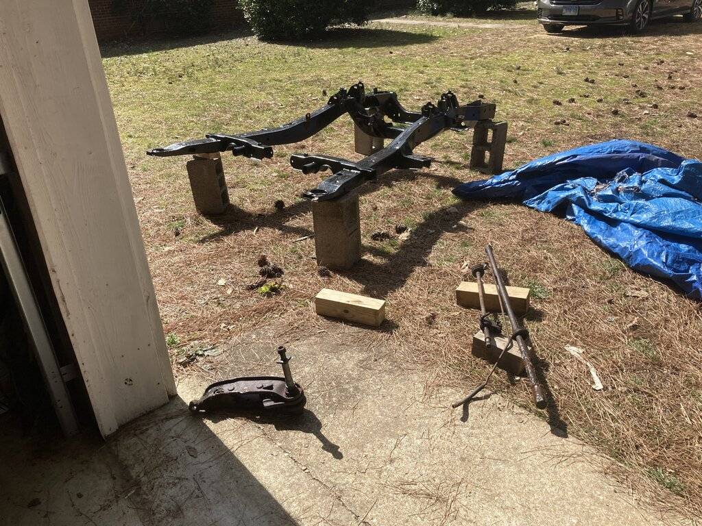

Old frame is finally stripped and the new one is in position. I can see why dad wanted me to replace it before I had the car on the road. Will probably spend a good week prepping parts and another week painting.

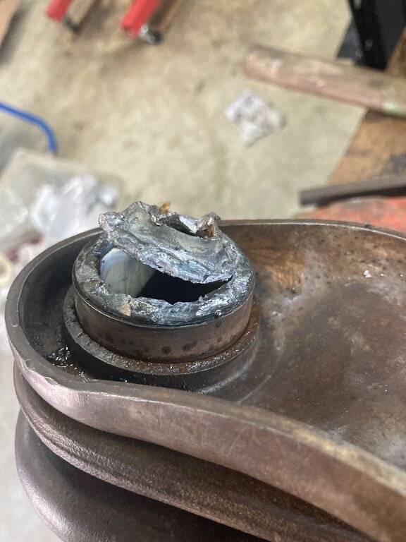

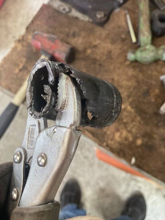

Spent a few hours every night going through and cleaning all the parts I will be using and prepping them to get rust converter and paint. Now I thought the sway bar links and bushings were a pain to remove (handy dandy hacksaw came into play here), but the LCA bushings were a whole other level. Thinking it would be easier to do the washer method, I had a friend of mine run by this morning with his welder to put in a washer in each bushing. Unfortunately, that washer was so soft it just blew out under the press. Cue 3 hours of beating on just one side with chisels and sledge hammers (a BFH was how the upper bushings got out). Another 2 and a half hours later, both were completely removed and my knuckles only slightly swollen.

So after posting the way that I did mine on my Facebook, I got feedback from a few other Mopar guys. One of them recommended using a 1 3/8 inch tap to thread into the bushing and then press it out.

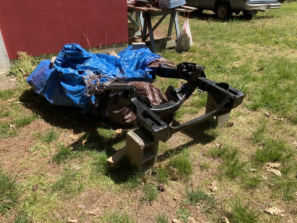

Surprise surprise, I’m actually putting care into how it looks! Unfortunately the past few weeks no work has been done due to issues within the family, however, I had the opportunity today to go out and paint some parts to try and mimic the natural metal colors. Was even going to dip in Cosmoline too but that’s too high level for this build. Waiting for this side to dry, then on to the other side, followed by the rest being painted black and everything clear coated.
And now we wait for the clear coat to dry and cure. Have some smaller parts awaiting paint and still need to do the torsion bars as well (may just clear them). Hopefully middle of the week I can start assembling these and finally putting my NOS Moog parts on the car.
May not look like much, but parts are finally being installed! Yesterday I got the transmission crossmember installed and today was upper and lower control arms and strut rods. Only had a minor setback with the bushings for the LCAs (luckily we had a big pipe) and I’ll need to drill out the spring pin in the strut rods. Also figured out I have an extra set of UCA bushings (Moog K-7006) and also a set of polyurethane A/B/E body lower control arm bushings (bought them thinking I need them but they’re different than the C body ones).

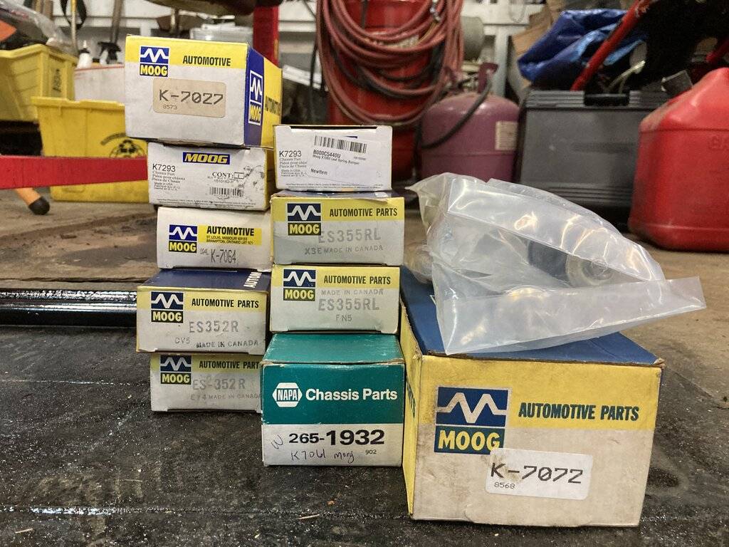

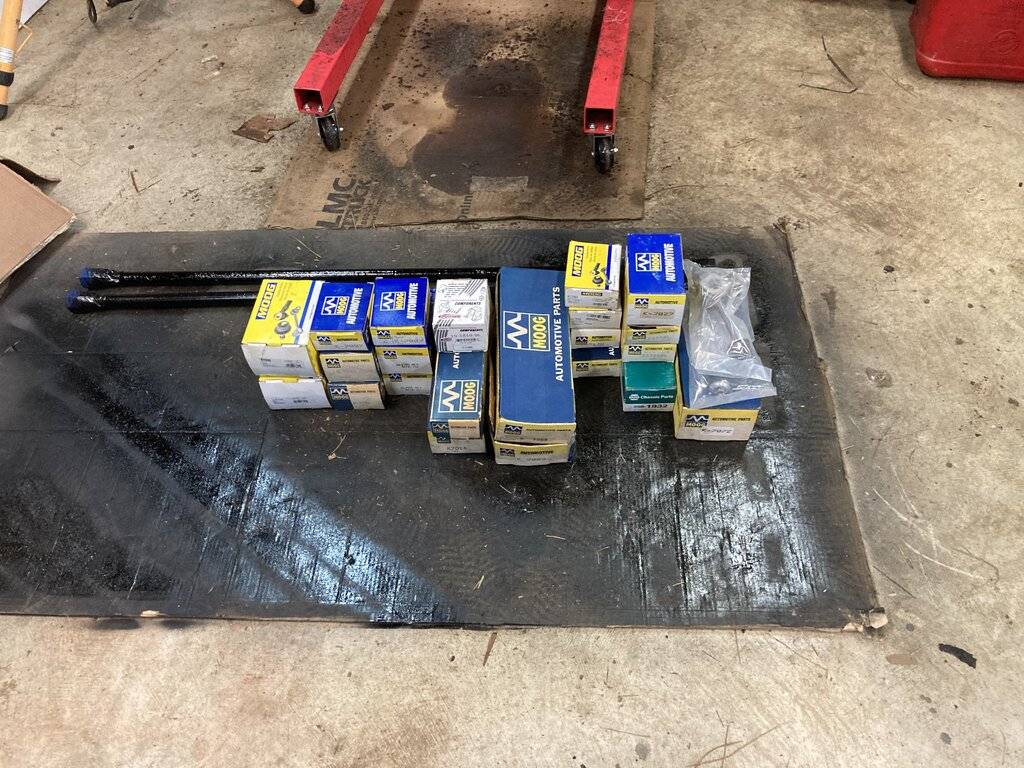

I feel like that now I am at this point, I should share all the parts I am using for the front end rebuild.
*Cue Slim Pickens voice*
“In your 1969-73 C Body Front Suspension rebuild kit you will find:
- (2) Moog K772 Upper Ball Joints
- (1) Moog K7003 and K7005 Lower Ball Joints
- (2) Moog K7006 Upper Control Arm Bushings**
** Moog K7036 Camber Bolt Kit contains these bushings as well
- (2) Moog K7007 Lower Control Arm Bushings
- (2) ES352R Outer Tie Rod Ends
- (2) ES355RL Inner Tie Rod Ends
- (1) ES355S Tie Rod Adjustment Sleeve
- (1) K7072 Pitman Arm
- (1) K7014 Idler Arm
- (1) K7064 Sway Bar Bushings (these go on the strut rods and the bracket around it attaches to the outer most holes on the sway bar)
- (2) PST SL18238 Sway Bar Links**
** PST is the only company making new bolt together sway bar links. Moog K7061 has the bushings for the links and sway bar but require reusing the original welded sway bar links and aren’t in production. The NAPA 265-1932 are a discontinued part that is the same as the PST. The lot I bought from a private seller only had one.
- (2) Moog K7293 Upper Control Arm Bumpers
- (1) Moog K7046 Idler Arm Bushing
- (1) Moog K7027 Strut Rod Bushing
- (1) Prothane 19-1819 Upper and Lower Ball Joint Dust Boots
Shoot, a fella could have a pretty good weekend at Carlisle with all this stuff.”
I have spent the past few hours trying to find the lower control arm bumpers for our cars, but they are different than the triangular ones sold (such as Prothane 19-1303) and I don’t want to spend $50 buying a set with another set of upper control arm bushings. And to all wondering, it cost $450 for me to buy the lot of NOS Moog parts from a private seller on Facebook. Good luck trying to find a deal THAT good! (And sorry for not buying it all from you @mobileparts )
