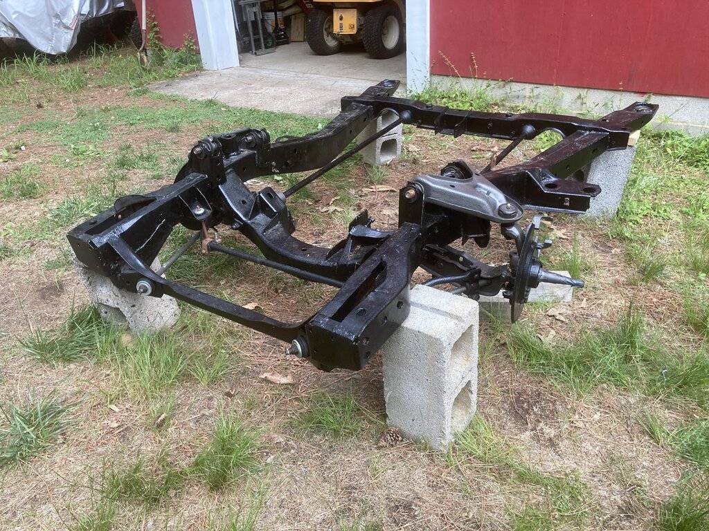

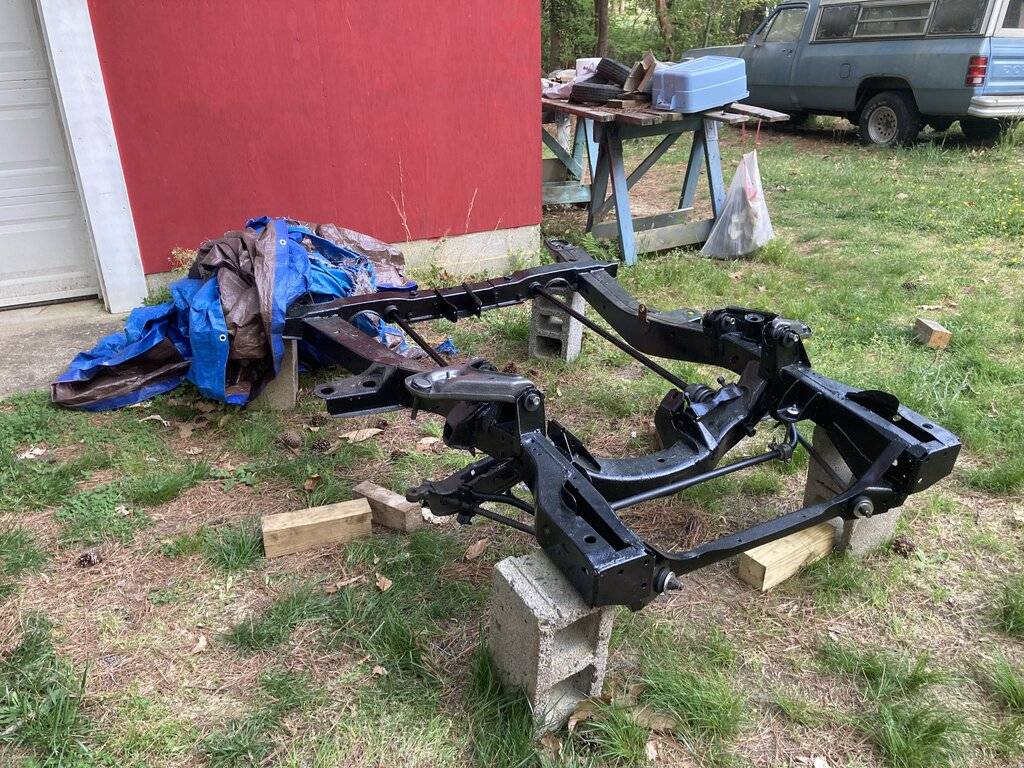

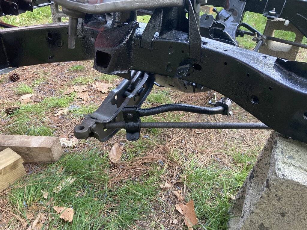

First hot day of the year, and a perfect time to get the sway bar in. Unfortunately now all that has to come out to get the torsion bars back in and seated with new seals and clips. It does look a lot better.

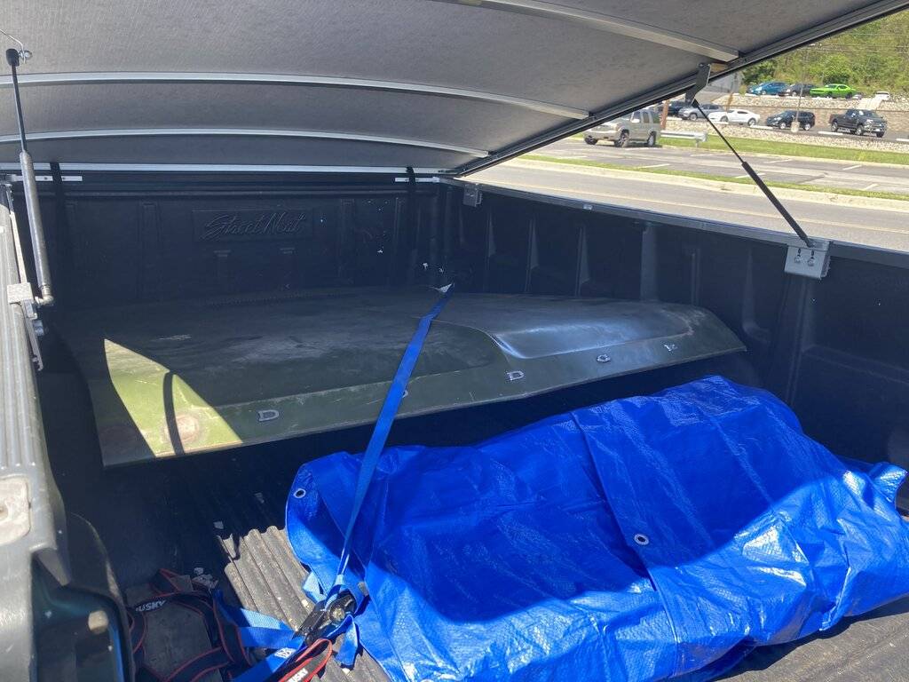

Took today off from doing homework and drove with dad up into PA to meet with Isaac, who had gone and met with @71Polara383 a few weekends ago and brought some stuff home for his Polara. He also brought with him a nice green hood for Delmae that I traded Wyatt a set of ball joints for. Officially the farthest I’ve traveled for car parts, but at least the weather is beautiful.

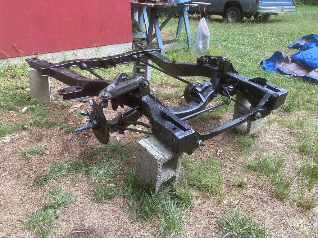

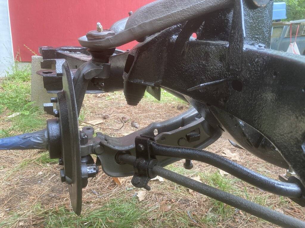

First step was to get the dust boots on and clips set. Took a good hour beating it back and forth (with some questionable cleaning methods on the end of the torsion bars), but we finally got the bars indexed, greased, and clipped in.

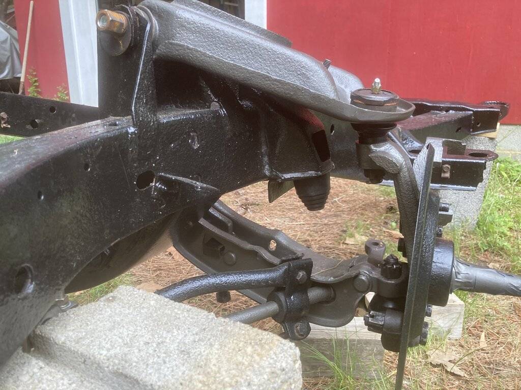

Once they were in, it was finally time to get the spindles on. One of the few small upgrades were polyurethane ball joint boots. Remainder of the time spent today was spent tightening the nuts to spec and putting cotter keys in (luckily we had a whole collection of some to put in as well). It’s starting to look like a car!
So in one of my last posts, I brought up that the lower control arm bumpers listed for Mopars ARE NOT for our C bodies, as ours are mounted to the frame and not the LCAs. Well luckily I found a set that would work- Energy Suspension 9.9101G. They’re universal polyurethane bumpers that are on Amazon for cheap, and luckily fit really well.

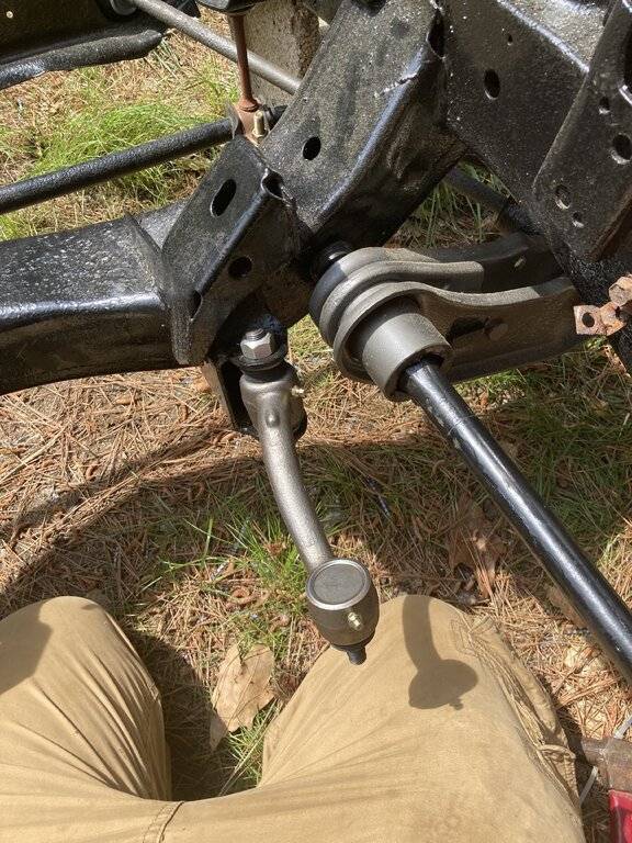

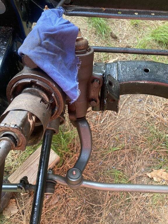

The last bunch of NOS Moog parts went on today. Almost gave up on removing the old pitman arm from the steering box, as the puller and stuff we had were doing hardly anything (and covered the workbench and side of the garage in power steering fluid...oops), but some heat and a few good hits of the hammer on the puller got it off (and got record distance too). Unfortunately we didn’t have a 3/4 inch drive torque wrench on hand (or one to begin with that went to 175 ft lbs), so the nut was tightened to the German specs of Güten Titë.
Looks really close to straight too! Unfortunately we ran into a dilemma, as the KYB shocks unfortunately cannot be installed with everything else put together (hindsight 20/20 right?). Very very soon it’ll be back underneath the car.
