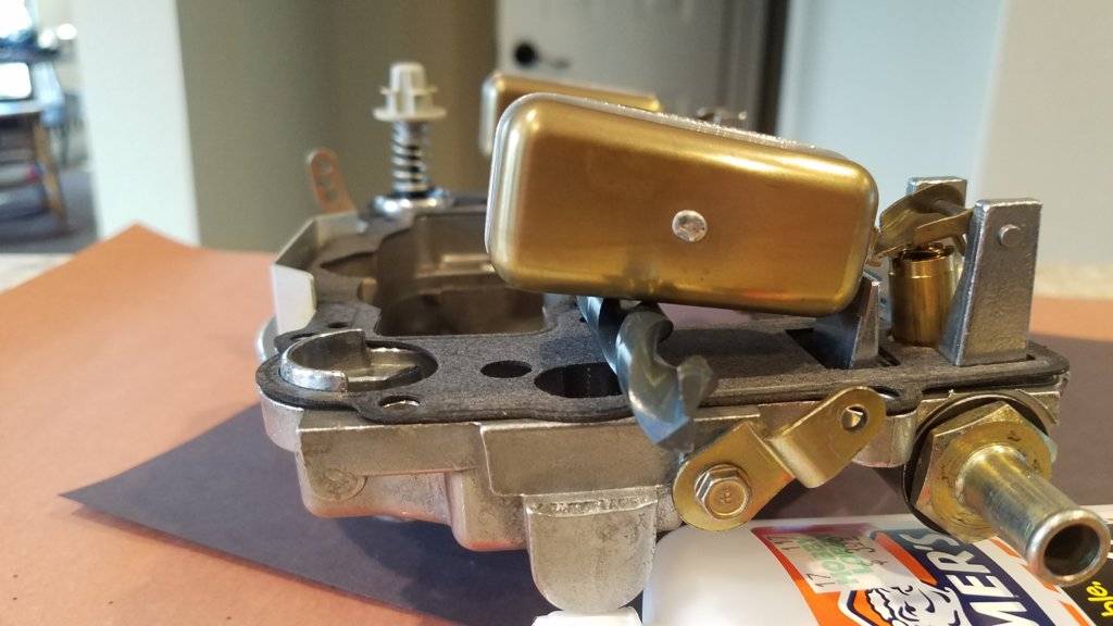

Haha, yeah I plan on at least pulling the top and cleaning the float take out the jets or possibly taking it and just soaking it.
On edelbrocks it is usually fuel being sloshed into the engine when turning. You can try lowering the float level a tad. I had that problem where in a curve, fuel would be pushed out of the venturi booster and it would sputter and stall the engine while turning. (The carb works on the idle and transfere slot up to about 2000 or 2500 rpm.)
Yeah got plans to check it out tomorrow would you say 7/16 for the floats or lower
Well I also ran that marvel mystery oil through it and being an oil makes me wonder if it may have gummed it up

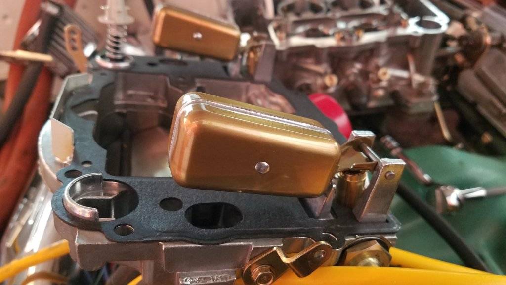

Do the floats seem high, or open too much?
7/16? Also, check your fuel pressure, you cant have more than 4psi if i remember correctly, that might flood it too.

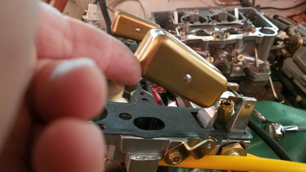

Hard to tell by the pic, but those floats look like they are set too low.

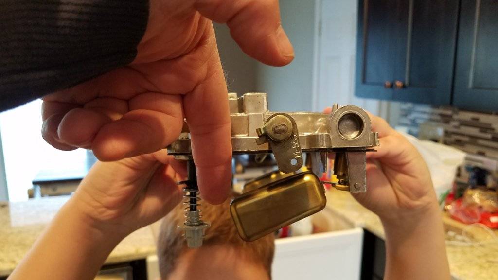

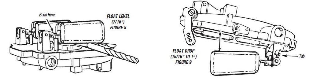

So I adjusted them closed like this with a 7/16 drill bit. So in open I pushed in the tab in the back so it hangs at 1 inch.
